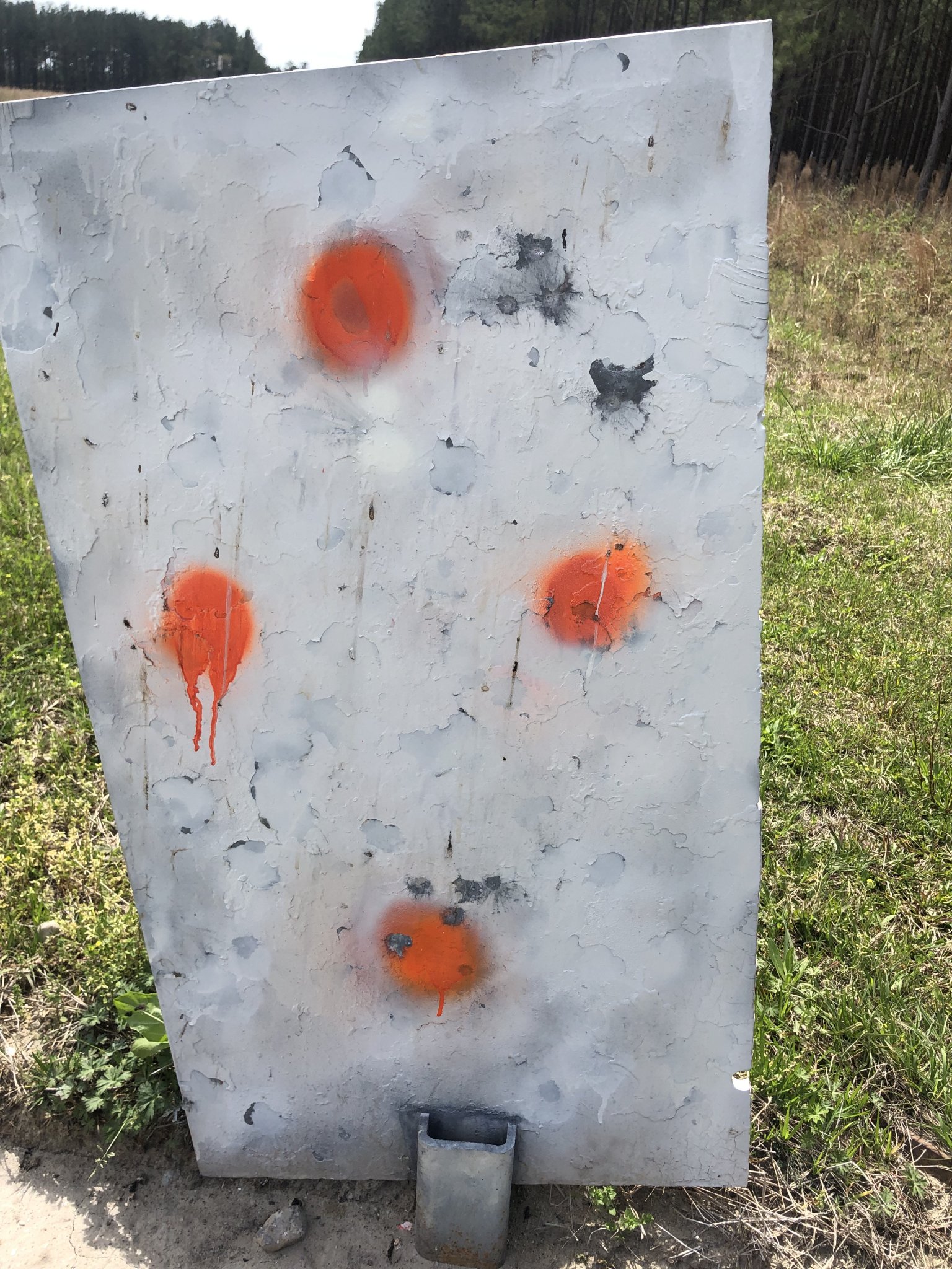

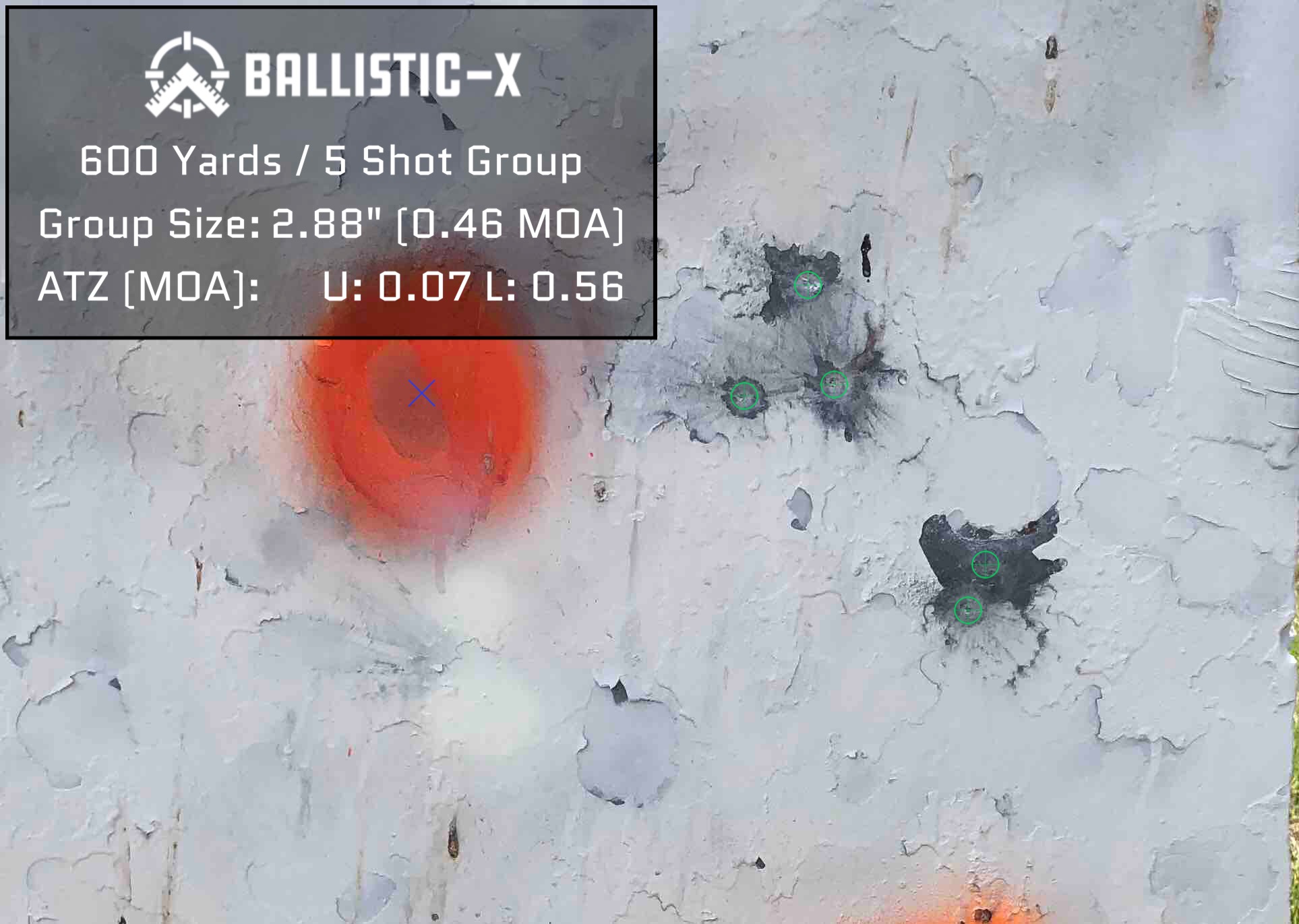

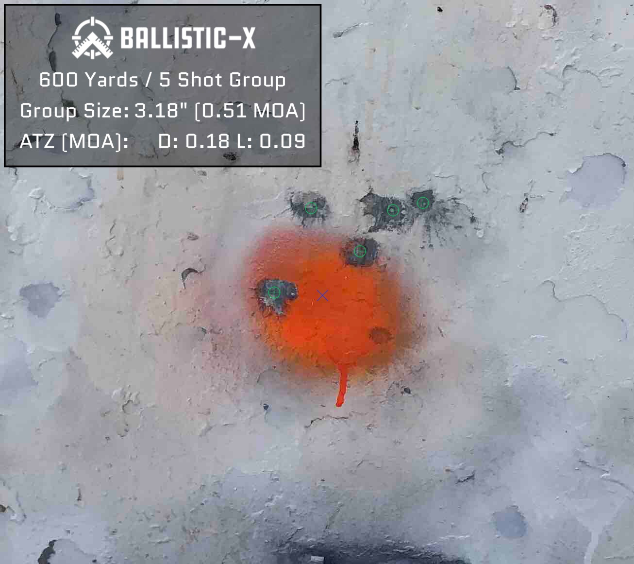

After some frustration and lots of load development I settled with about 1/2 moa with my MK12 clone. It’s a CLE Douglas

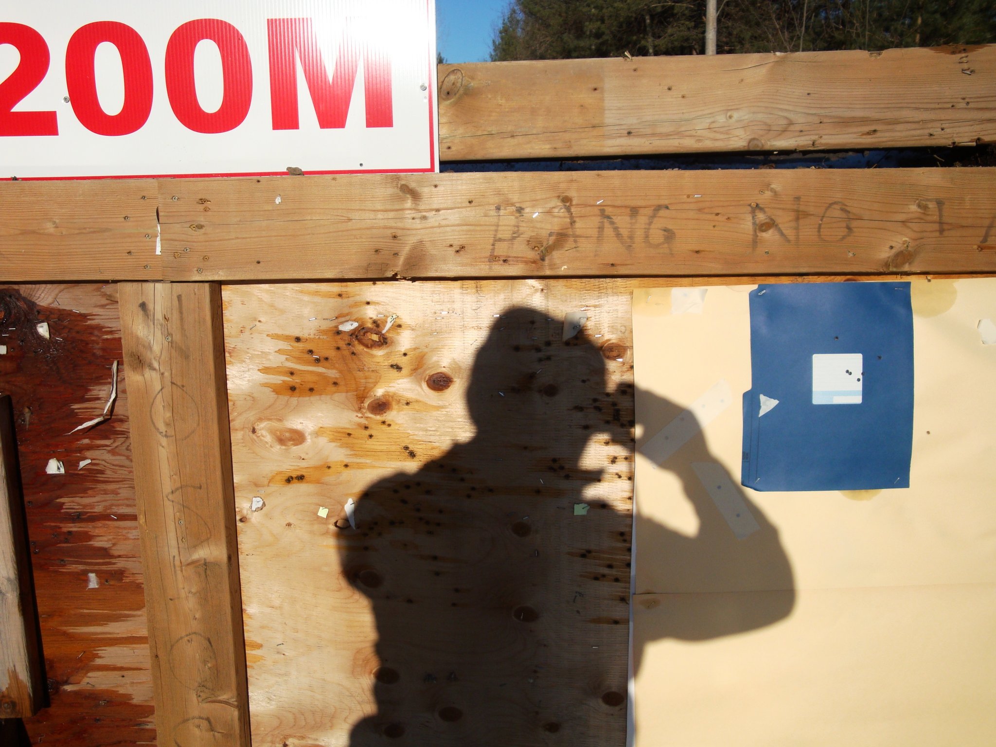

Ruger Mini 14, NORINCO elcheapo ammo, 200 meters, It happened; 2 rounds disapeared I have no clue where they went;
I could not repeat the performance after 4 weeks

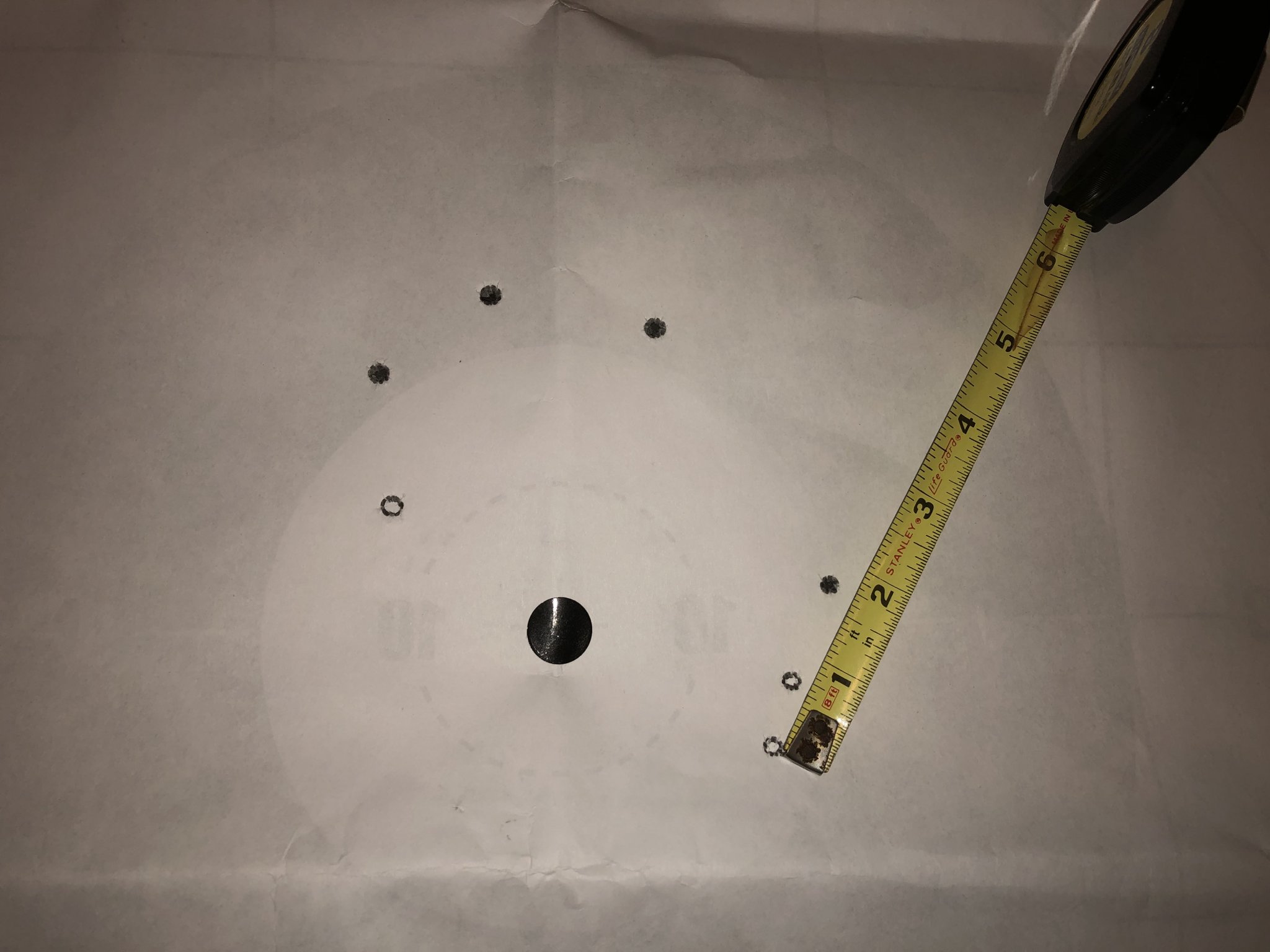

I thought I had a 1 MOA AR, but I was wrong.
Sold my Rest at the last match and had to shoot off a Chinese Bipod.
Didn't make 1 MOA :(
Looks like decent shooting to me overall at just over 1MOA if that’s a standard F-Class 600 yard target. A quality bipod (or sled, for you cheating F-Class guys! :LOL:) might have helped, but I wouldn’t be too disappointed with a gas gun that shot like that, at least for field use. I’d like better, but 1MOA is livable for the field, IMO.

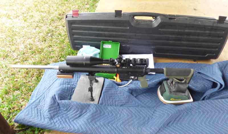

I shoot an 18" Daniel Defense upper, Magpul PRS stock, Geislle trigger, 77grn SMK. My setup is likely a 3/4 MOA gun. I am pleased to hold 1 MOA in field prone conditions, fully warmed up. If I dropped down right now to shoot a group? Probably 1.3-1.5 MOA in truth. I don't shoot as much as I'd like. My "confirm zero" is a half inch square hole in a steel plate. It usually takes me a couple shots to get that "swish" round at 100m.
I hope that this information gave you a piece of data to help build your expectation. Gas gun shooting is hard work, and it magnifies your mistakes. It's a lot of high speed gas and metal flying around for the shooter to maintain.
