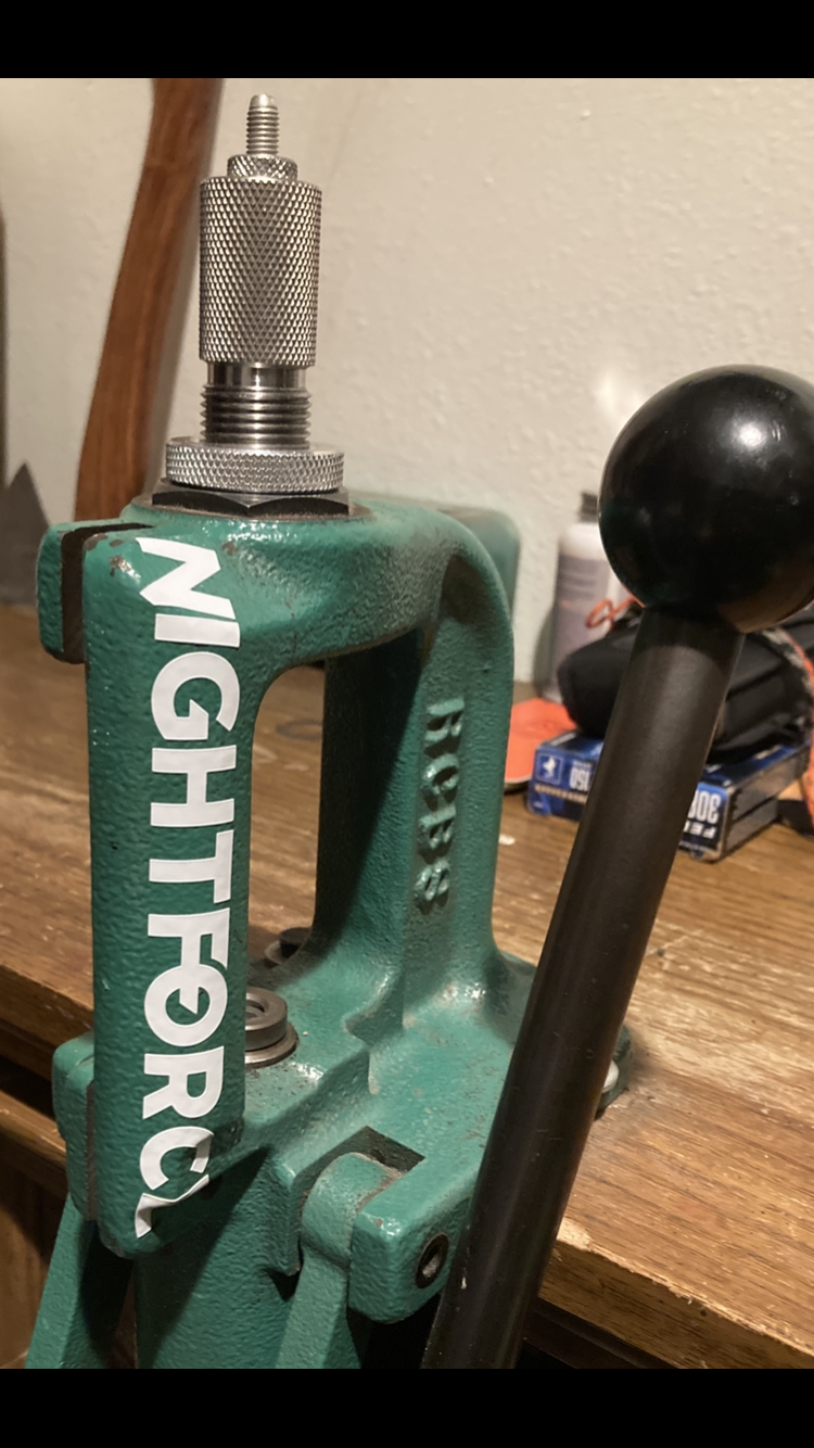

    I have a nightforce reloading press. 😀

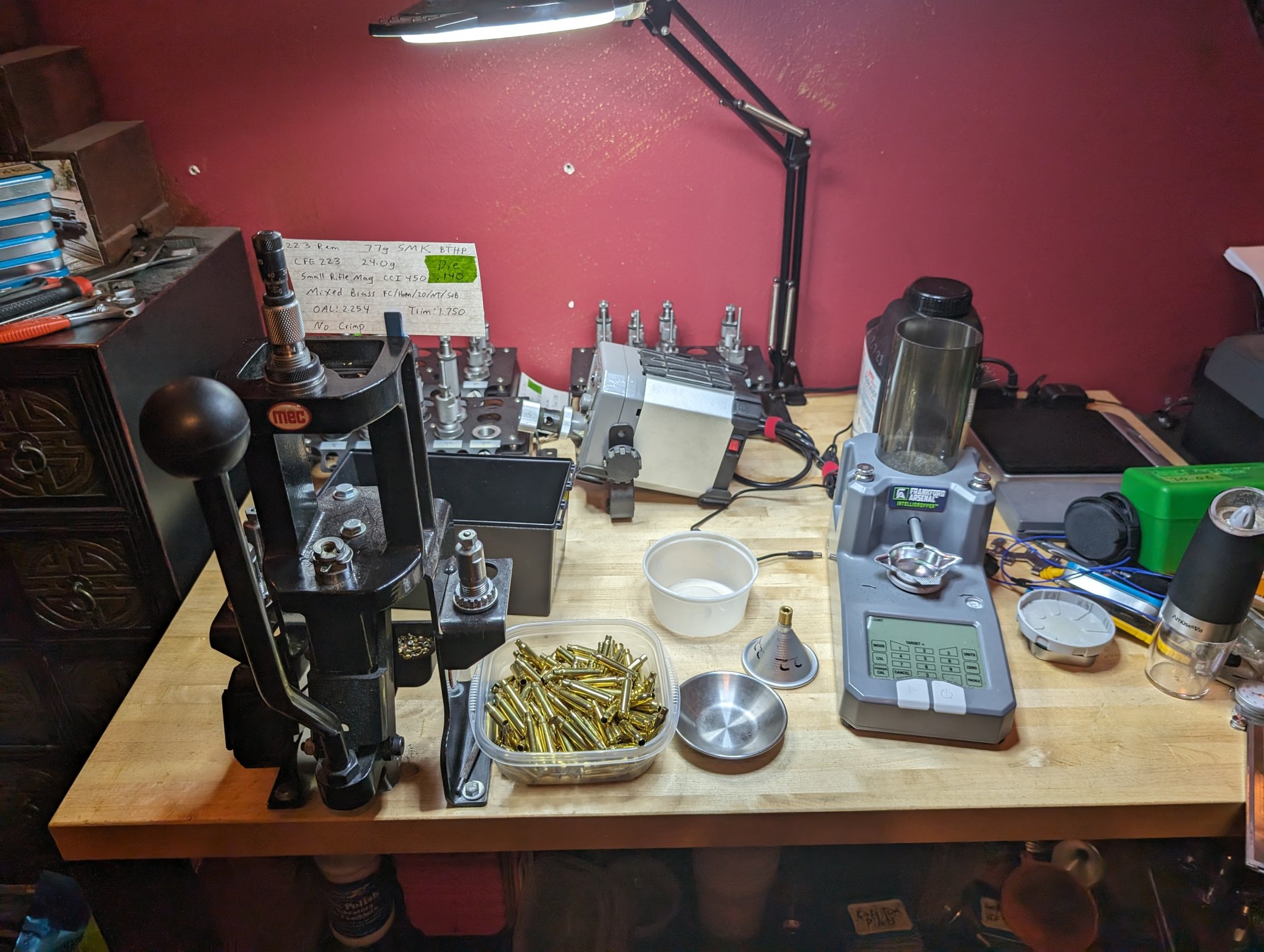

    I have a Redding T7 , RCBS Rockchucker, and MEC Marksman set up side by side on of my benches . The T7 gets the most use because it has multiple stations , the RCBS has served me well for many years with no problems . The MEC is the latest purchase and It is just as strong and smooth as the others . Any of those three should serve you well .

    Personally, I have used the Rockchucker and use a Lyman Turret T-Mag II because I only have space for one press and I load pistol so I can size and flare the mouth at the same stage. When I compare my runout with others using the COAX they probably get +/- 0.0005 less runout. That's on cartridges up to 308 and 30-06. I don't expect a turret press to ever match a single stage in that arena. If I were to "up grade" I would choose the COAX over the 419 because from an engineering standpoint the COAX is simpler and less likely to have issues with concentricity. All of which brings us to the point of what do we value most in a press?
    I should also add that I put the Hornady bushing adapter in my MEC marksman and it makes it so quick and simple to use. I've had phenomenal luck using the lock-n-load bushings for both repeatability and concentricity. I love them. Just my $0.02!

    You bring up some good points . I like the floating shellholder on my MEC . I have loaded with my Rockchucker for many years with no run out issues . Maybe I got lucky with mine ? Thanks for your input .
