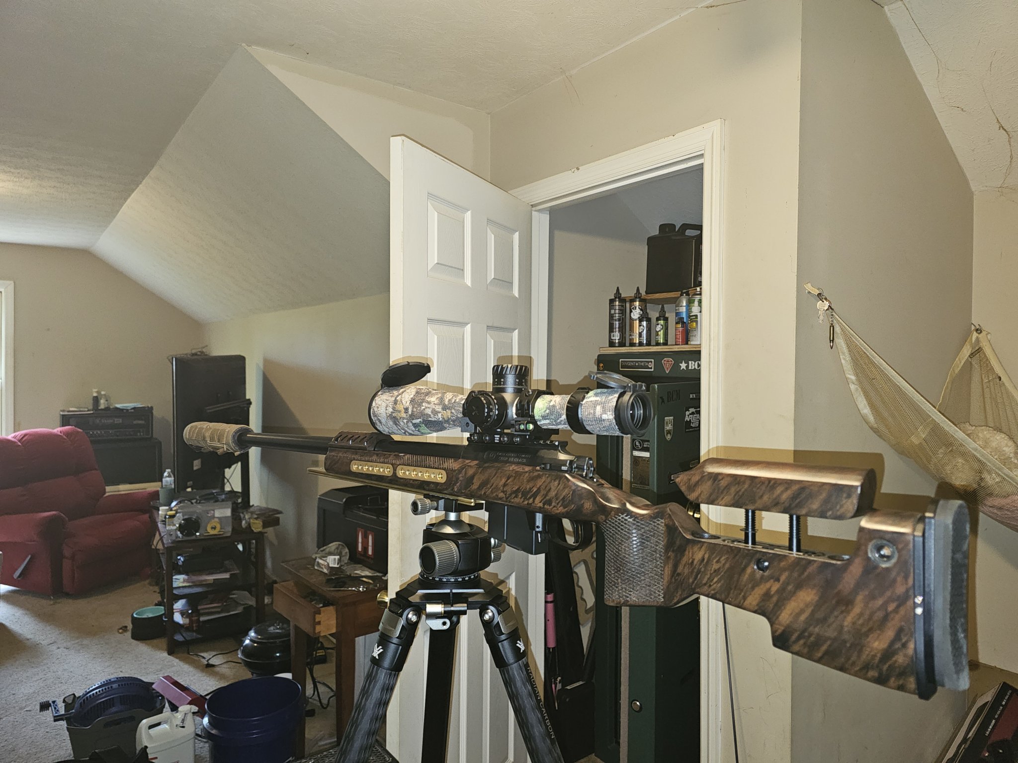

the rifle I just built.
scope tt525p gen 3 xr, mount is arc low one piece with level.
American rifle company Coup De Grace
6mm creedmoor, 26" competition contour, tbac ultra 9 brake and suppressor.
foundation samson with the brass loaded tf down because I can't handle all that 6creedmoor recoil with my lack of 6 port muzzle brake.
plus I send the 109s at 3012fps so not entirely slow.
triggertech diamond flat, set to 14 oz. as the man said, barely light enough that I can slap that shit.
CDG has the accuracy international style fat bolt, 6 o clock open lug for AW magazines.
its a nice prs rifle and bench rifle.
only thing I may upgrade is my bipod, I may go to the mdt cykepod one of these days.

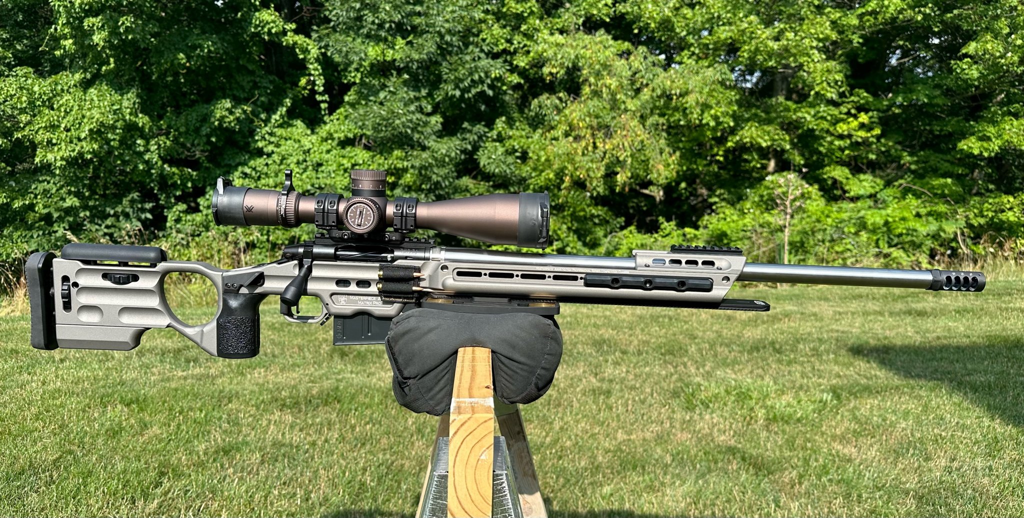

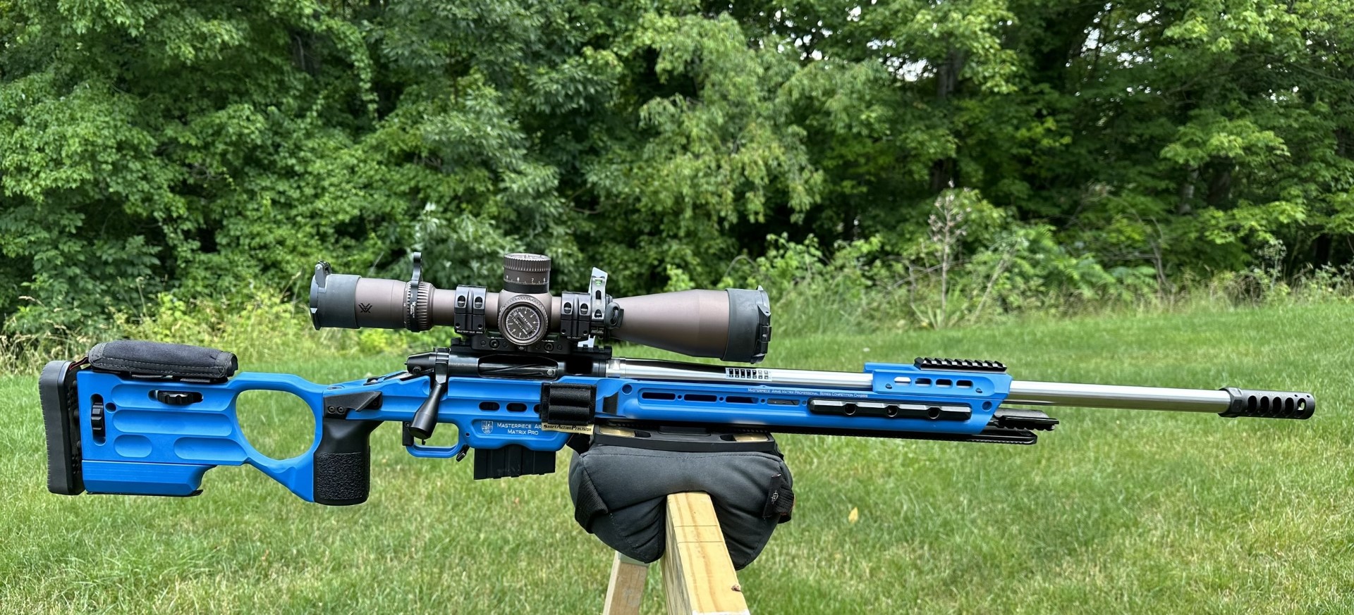

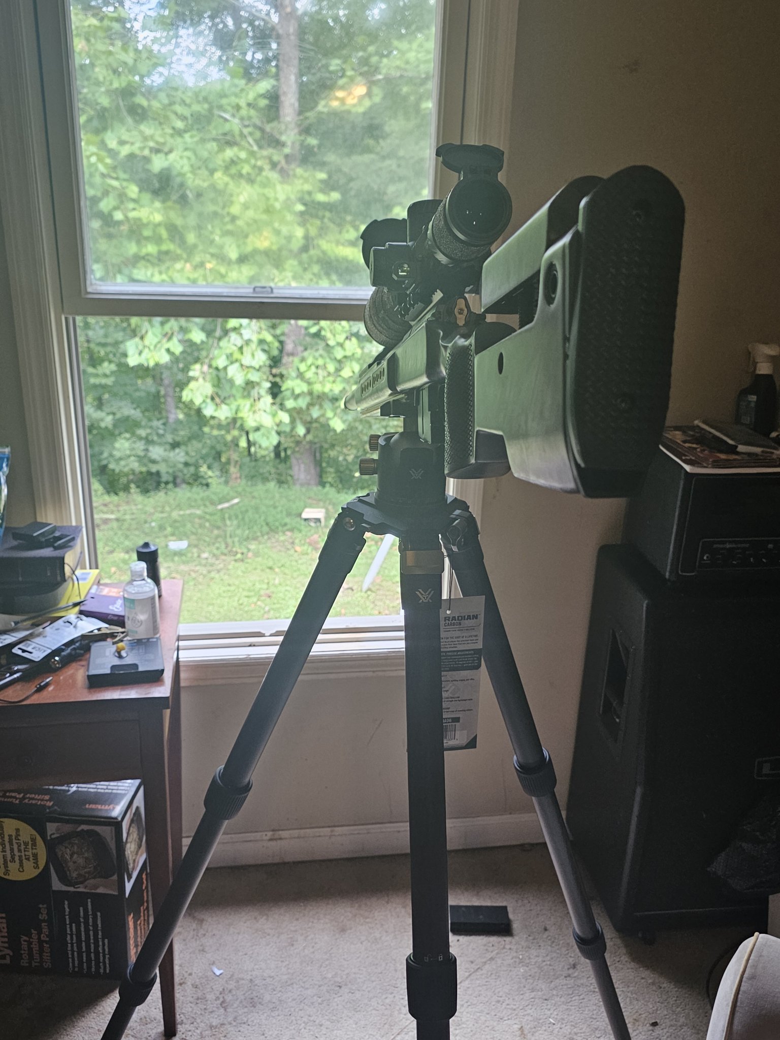

My idea of a perfect PRS build (including a .223 Rem trainer) is below:
Zermatt Origin action
MPA Matrix Pro chassis
MPA BA Scope mount
Vortex Razor Gen III 6-36x56 mrad
Bartlein heavy varmint barrel (6 creedmoor and .223 Rem by Southern Precision Rifles)
APA fat bastard brake
Triggertech Diamond single stage flat trigger (8 oz)
Reactions: camocorvette

Nice rifles. What is the color on the second Matrix Pro? Tungsten or Gunmetal?
Reactions: stevieb92

I must have listed the specifics somewhere else and thought I put it here.
I've got a tt diamond flat set around 14 ounces on this ARC CDG, fixed bolt handle, that i replaced the stock(80N) spring with a 70N firing pin spring for a very light bolt lift.
got an arc low mount with bubble level with tt525p gen3XR and a 26" pva 6mm creedmoor barrel in proof comp contour(heavier than mtu) and i run a thunderbeast ultra 9 currently.

What I built for my first ever PRS season of training and select matches.
  • Chassis - Magpul Pro 700-rattle canned by me; custom cut NV bridge not shown
  • Action - Terminus Zeus QC SA
  • Barrel - 26" Proof Research in 6.5 Creedmoor - cerakote done by Short Action Customs
  • Optic - Razor GENII 4.5x27 - Tremor3
  • SPUHR 4302C
  • AREA419 tunable arcalok rail
  • Sendit Ocular Indicator by Light-It-Up Levels - awesome guy on here @kylepmcg owner
