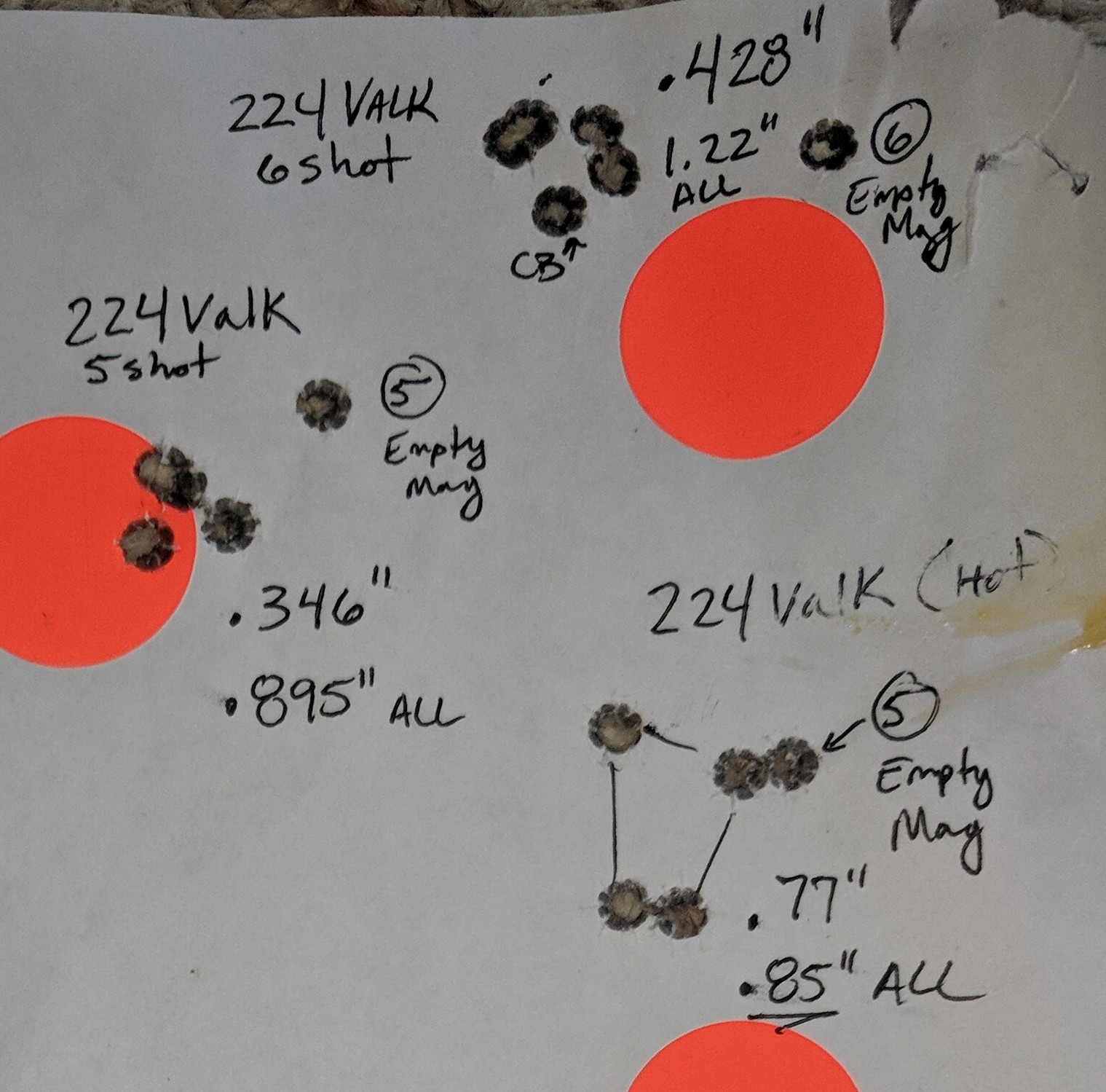

Well I don't have those that you listed; I found a 26" Rainier Ultra Match Gen 2 that fit my build. Shoots great! But it is close to the 500 mark. The upside is a 90 day money back guarantee, no questions asked. Could be worth it if you're concerned about getting a bummer instead of a Hummer.

Does your last round in the mag really throw out that far consistently? I would load a dummy or a rider under the last round to avoid that!
If I'm shoot for a specific group count then yes I'll load an extra round. As much as it matters, in a competition, I'd use a dummy (if allowed) or I'll be sure to load an extra round (if allowed). Same thing happened with my 223 build but it typically shot low 1/2 moa.
Empty mag changes the pressure exerted on the BCG and therefore the bolt changing its position slightly. My guess is the lower BCG pressure let's bolt unlock a tad bit too early and could be solved with a different spring/tuning.
As long as it's predictable, it can be accounted for when it matters.
