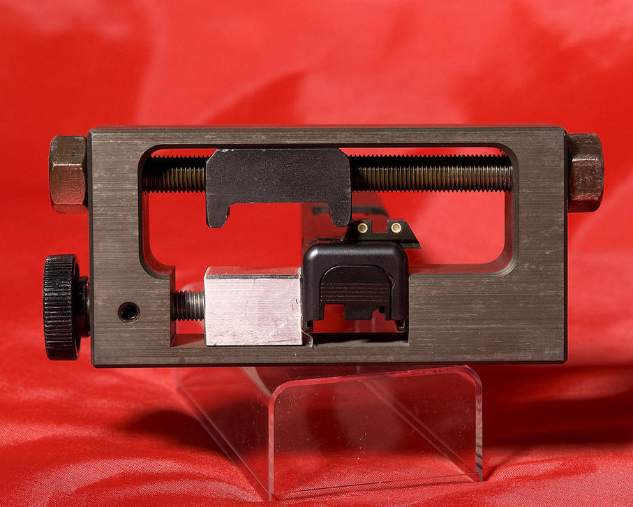

Here is one that I made. It works well with most all semi autos. I sold a bunch of these over at GlockTalk.
I made this one after I Paid a gunsmith to push some night sights into my Kimber and at no charge he put a line into the slide and a spot into the rear sight. I will never pay for someone to F up my toys again .
