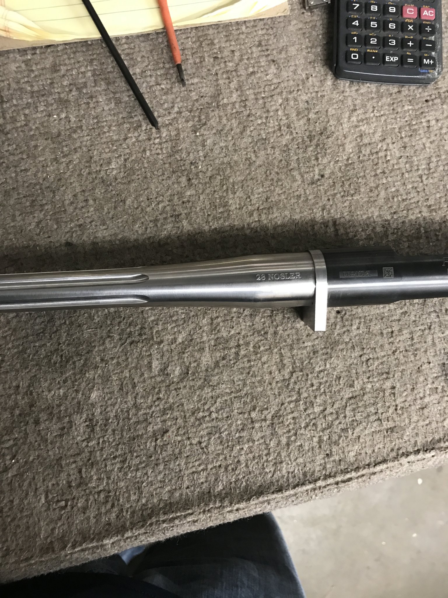

Our local machine shop laser engraves for 25 bucks a barrel . I have a chemical etch setup with common caliber stencils anything odd I run the barrel down with an index line.
Hunt around on Ebay I picked up the etch machine used , reasonably priced and its simple to use.
I was surprised to find there wasn't a trophy shop, etc. with a laser engraver within a 100 miles I could find that was capable of holding something as long as a rifle barrel.
I use a shop-made jig (similar to the LaBounty) for chambering stamps to get adequate depth.

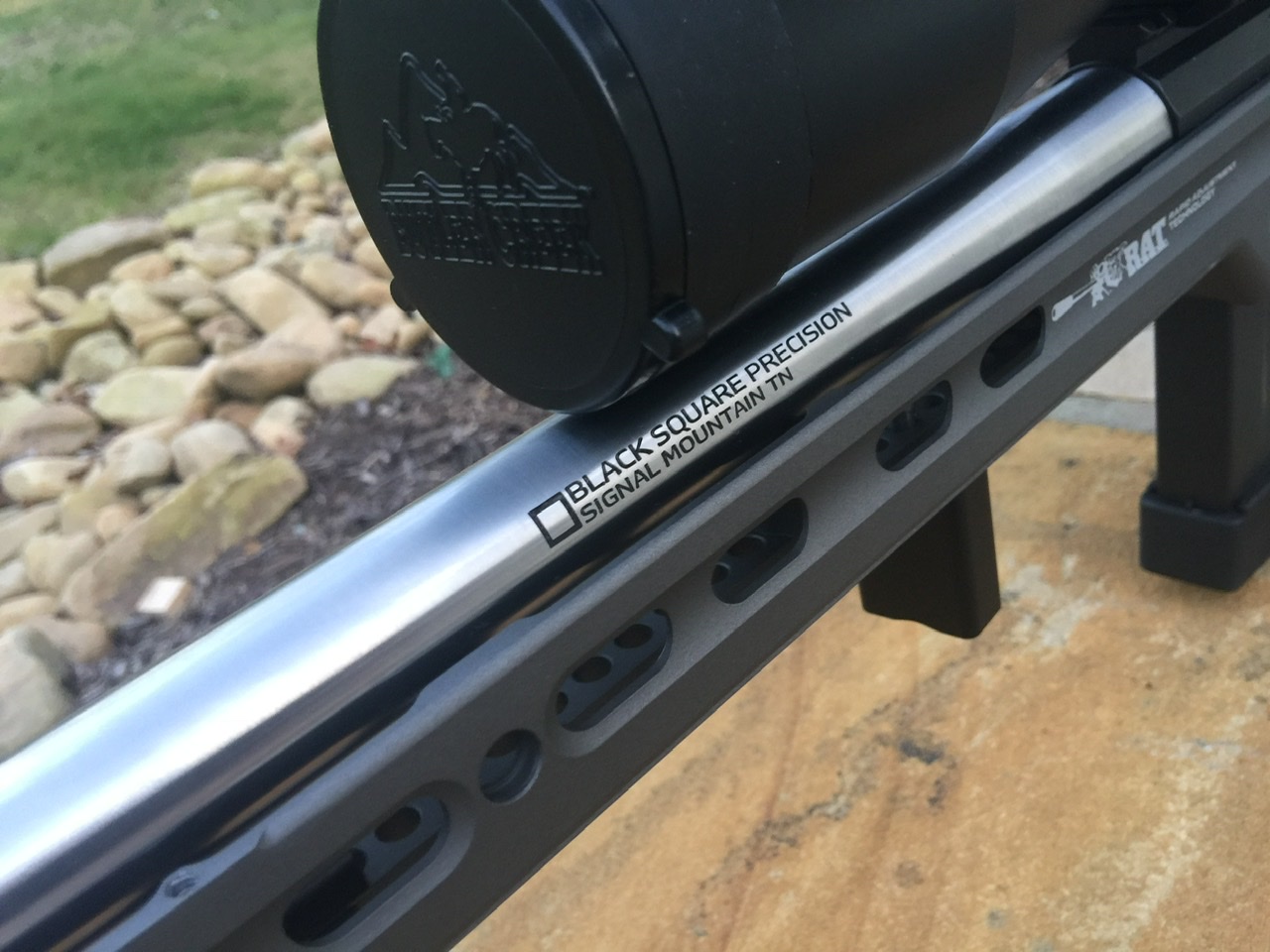

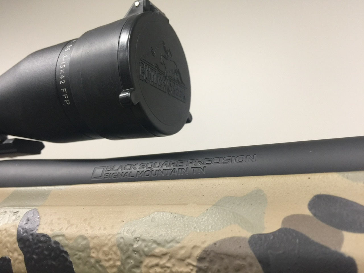

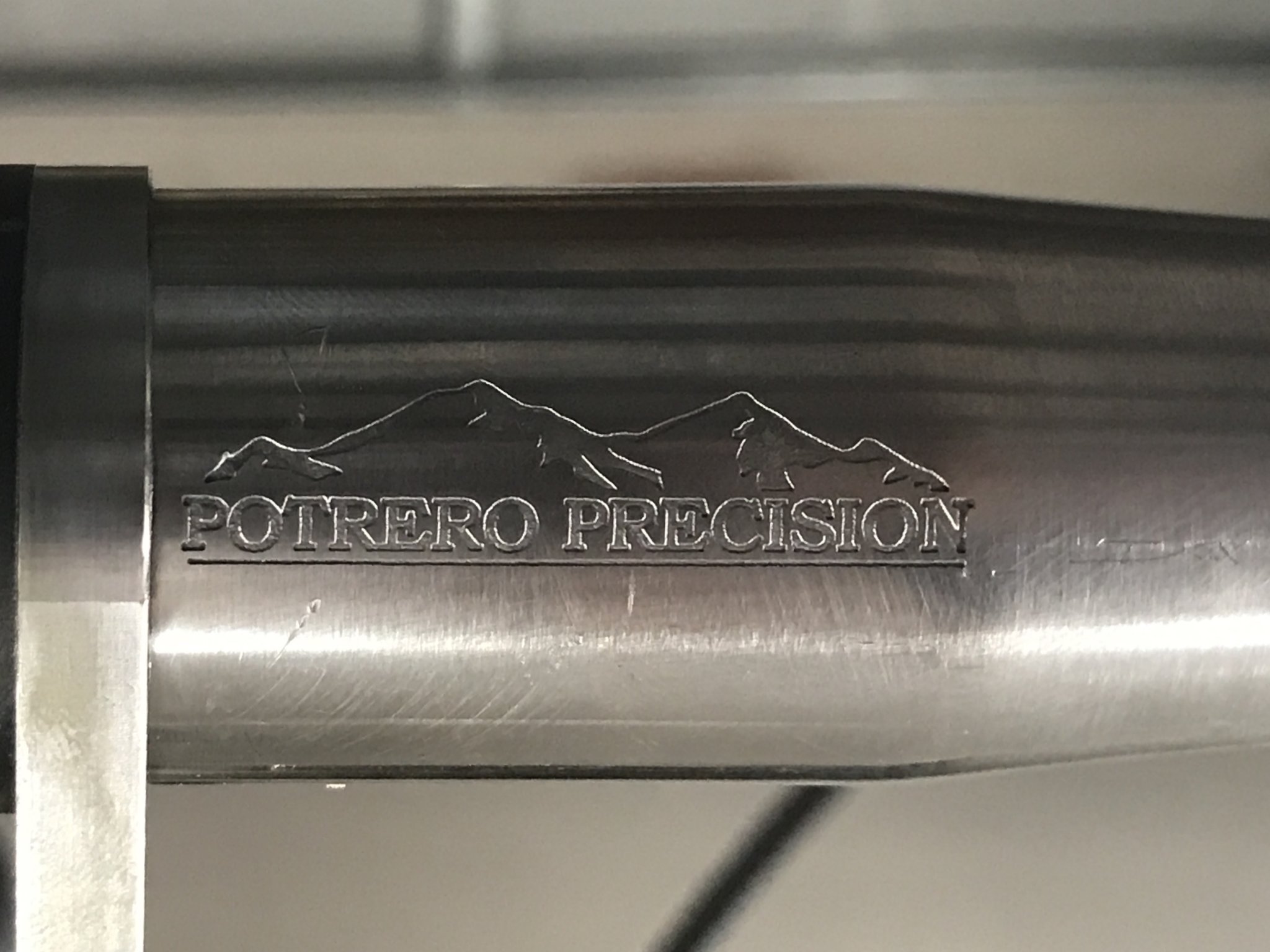

I'm looking at acid etching to incorporate a logo on them as well.

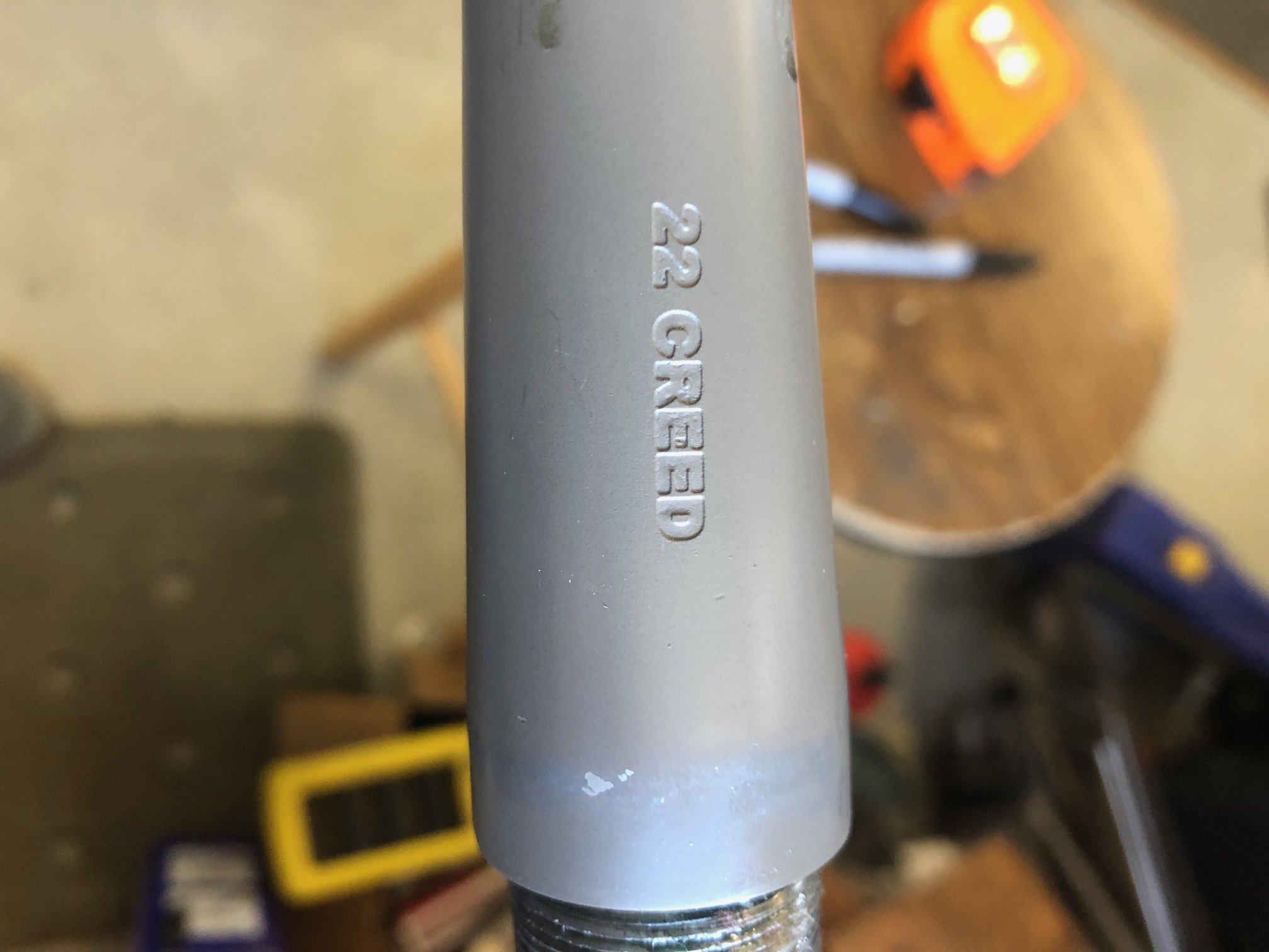

Our local place is a tool and die shop they have a nice laser and does nice marking but not very deep.
Another company we use now does firearm engraving and they can do engraving deep. We had a mistake on some barrels and they were able to go right over and fix the mistake.

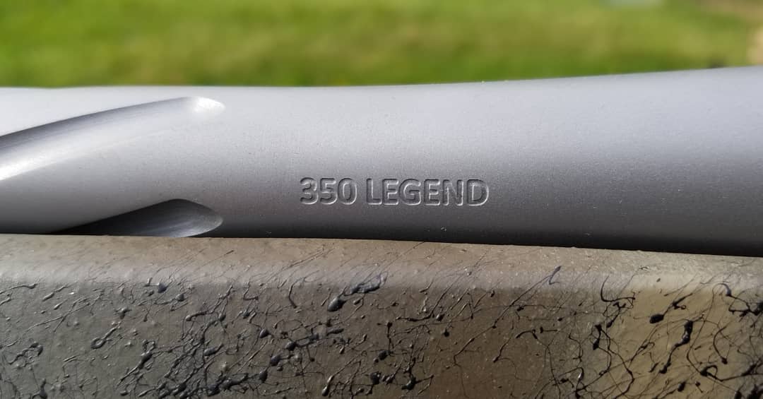

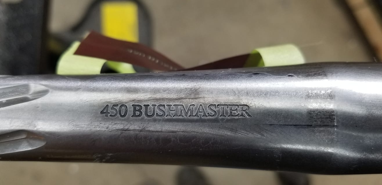

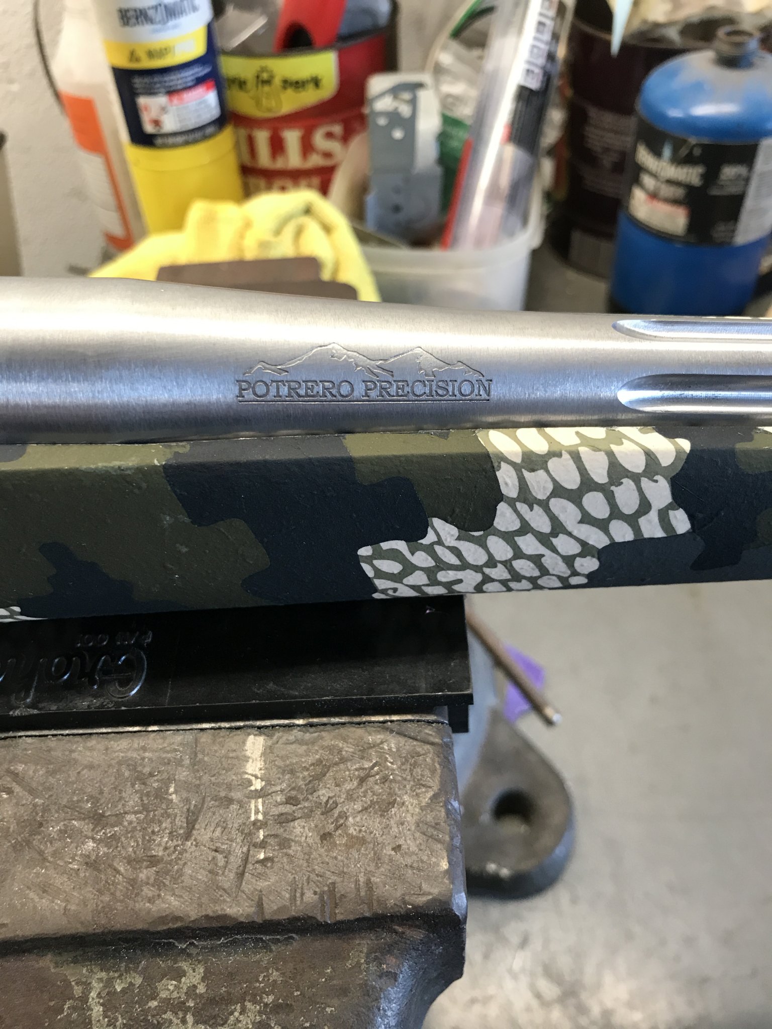

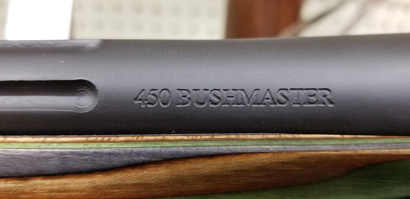

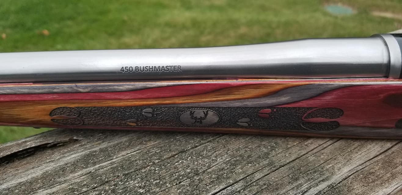

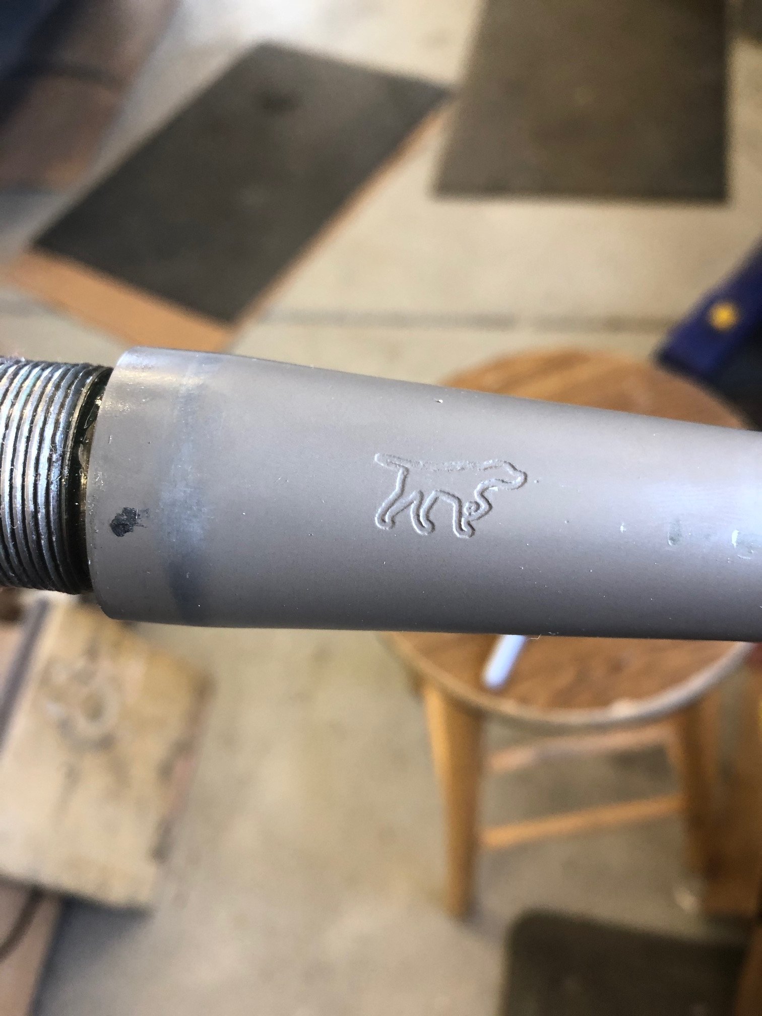

I use an inexpensive Etch O Matic. You need a laser printer to make the stencils but it's very simple. I can't get the etching as deep as cast1's pics but they're deep enough that they stand out clearly after cerakoting.
Here's an old barrel showing how deep I'm able to get it with the Etch O Matic.
