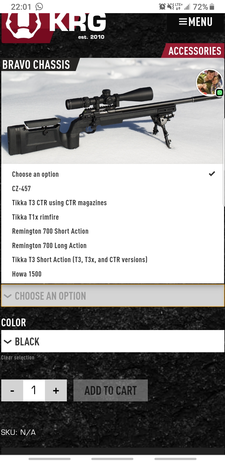

Youre correct in that the actions are all the same "long" action length. But the krg uses AICS or CTR mags. CTR mags are only short action calibers, and the aics Mag well is for short action
