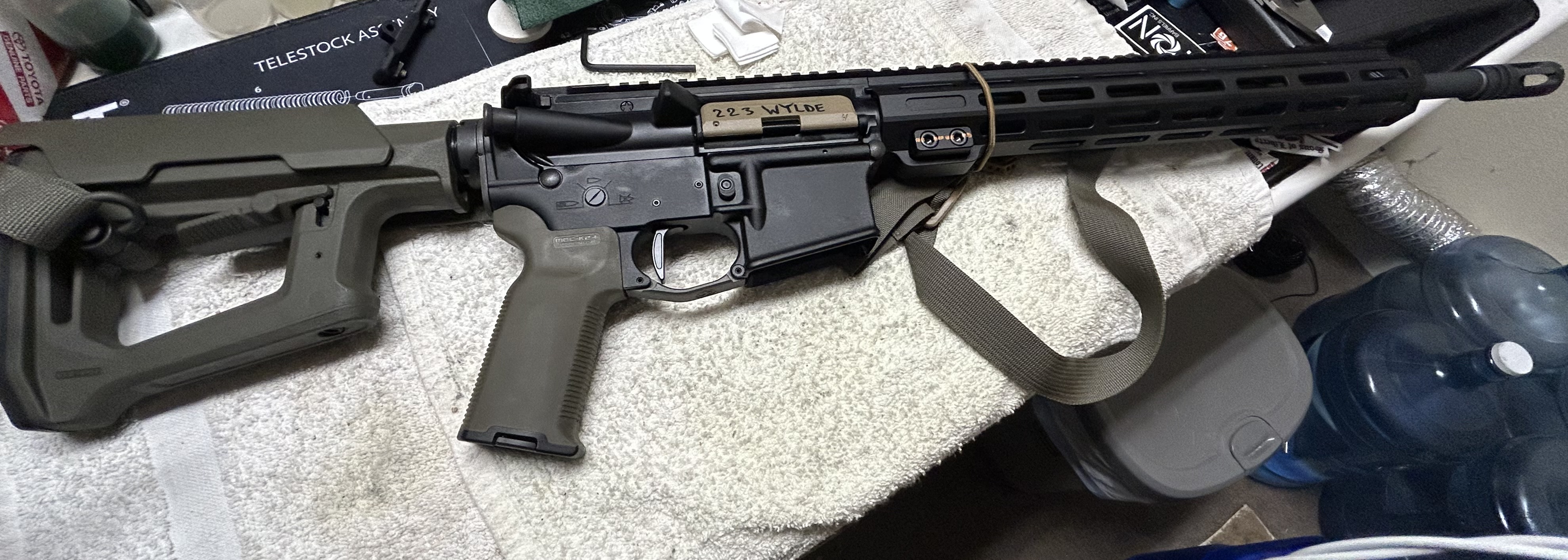

    My original 300 blackout pepper is a spikes tactical M4 upper; my new upper to add to my collection with an 8.2 inch Roscoe manufacturing barrel is an aero precision upper. The aero precision upper is actually a little bit better fit to the Spikes Tactical lower than the Spikes Tactical m4 upper.
