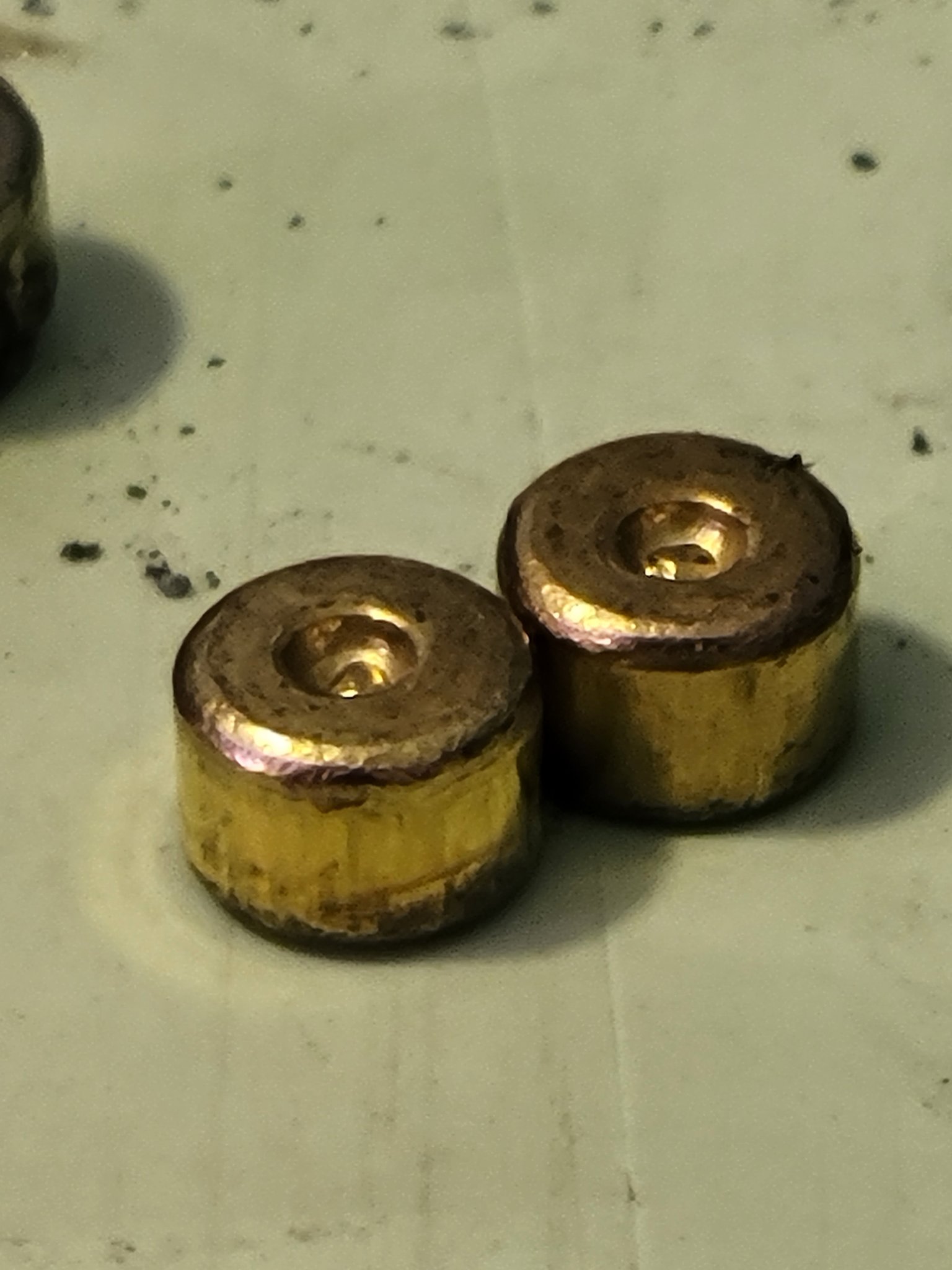

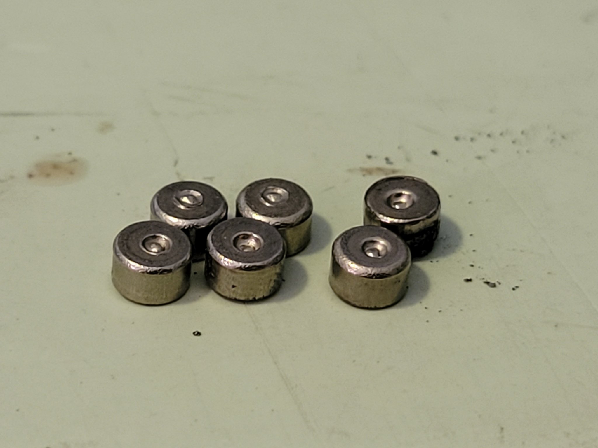

I just noticed my primers appear to be popping the middle of the primer indent backwards after firing. This happened on both rifles (ARs) I have fired in the last few outings.
The left 4x primers are rem 6 1/2, under 24.6 gr. Varget, lapua case, and 69 gr RMR hpbt. The 2x on the right are handloads with the 6 1/2 and cfe223. The two brass colored ones in the next pic are American eagle 55 gr factory.
Any idea what's going on?
Thanks!

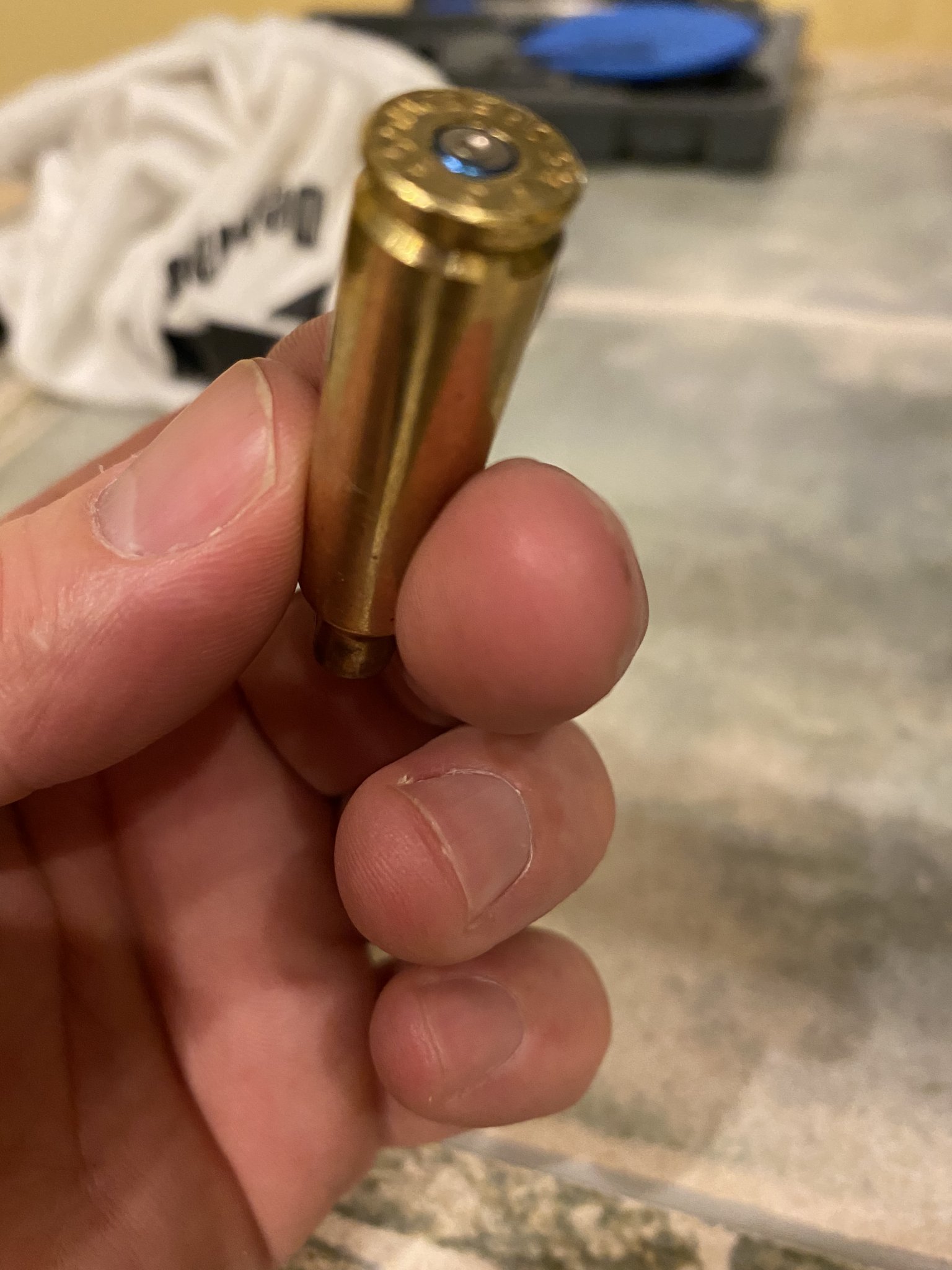

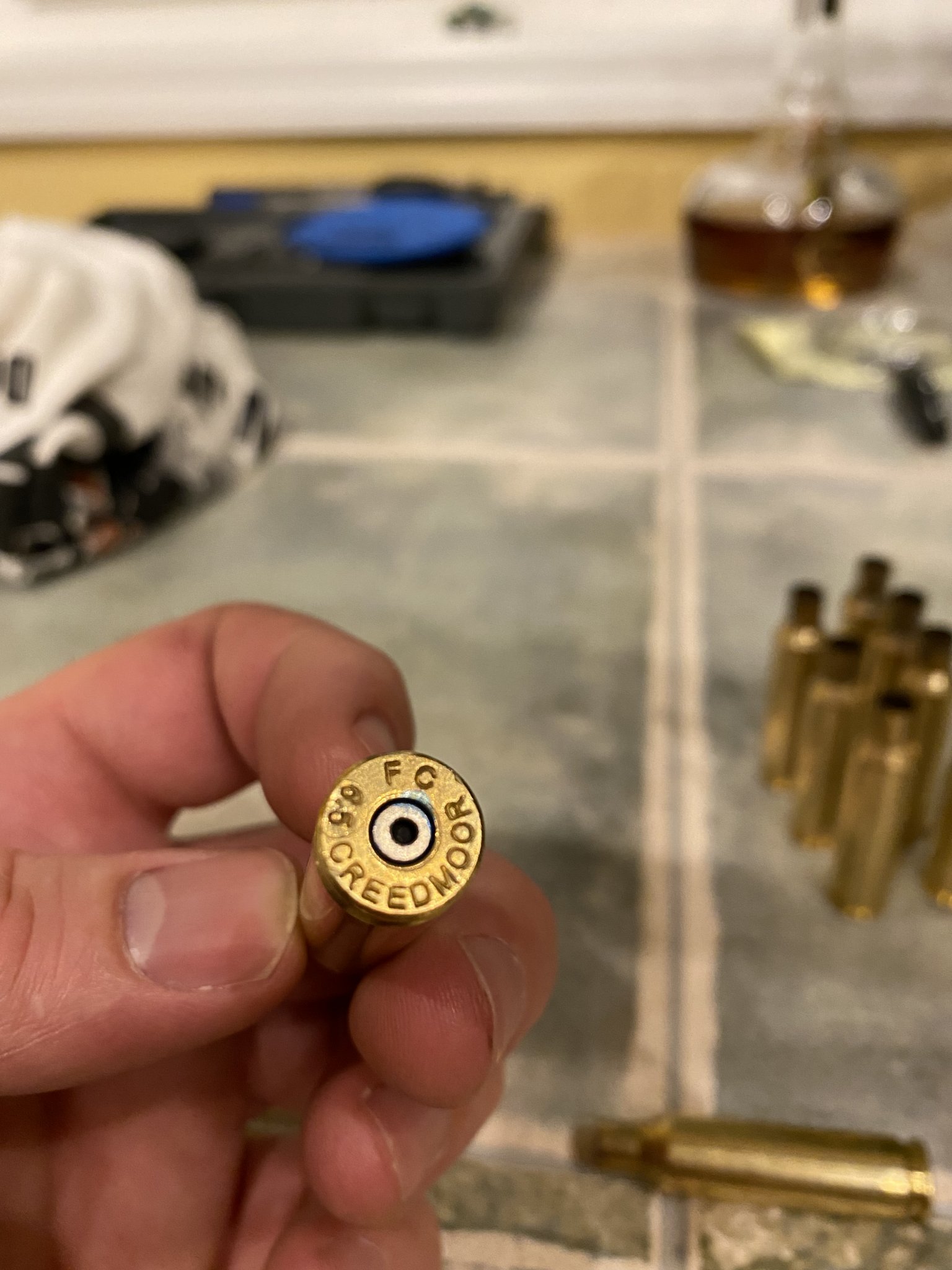

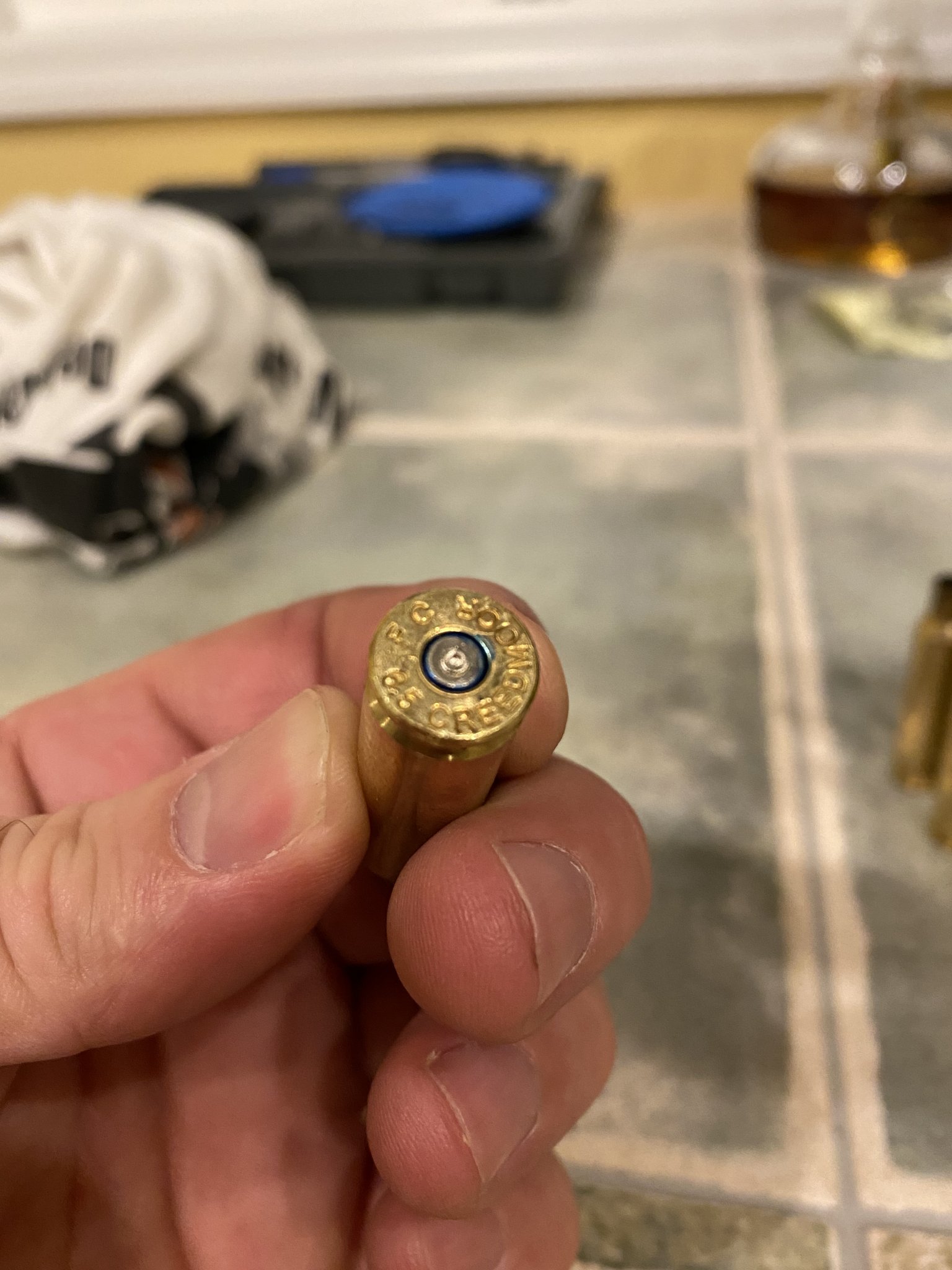

I think I’m having a very similar issue with my new AR10. Is your an ar10??
I am also getting 1 in 10 getting a hole punched through the primer, but quite a bit are actually mushrooming instead of cratering. I’ve read where it happens with ar10 and sometimes a heavier BCG helps. Kind of bullshit IMO
In my case the ammo is factoy. My reloads im gonn seat the primer to the max and see what happens

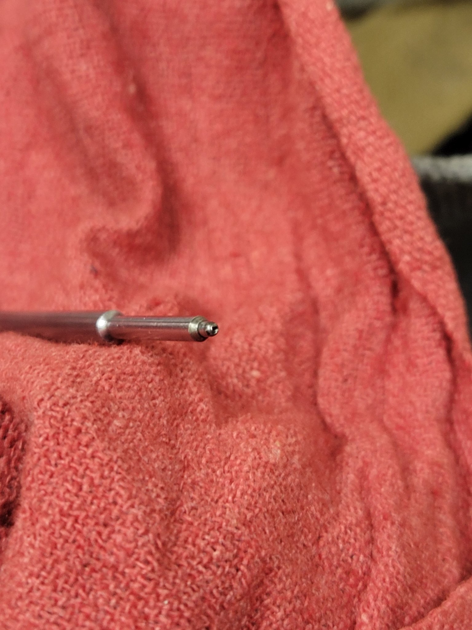

My bolt gun does the same thing. I just thought the anvil in the primer was compressing when the firing pin hit it, then it pops back which pushes the little bump in the middle of the cup.
Gotta be a different issue though compared to gas. Are you absolutely sure you know that pin is original to the gun and not replaced?
6 1/2 primers are for low pressure rounds that require SR primers, like the 22 Hornet. They are too soft for your application.
Ah hell, that explains why I have so many of them on my shelf. I bought a ton of them 10 years ago from someone who got out of reloading.
Anybody want to trade me for some? ☹️
Thanks for the answers guys, I suppose I probably should have know that.

Honestly though, I almost think it looks like my firing pin is striking too deep. The dimples seem deeper than they should be in both my loads and the factory stuff, but I really don't know for sure
By the looks, I agree, try a different firing pin. I am surprised the primers are not cratered, and again I am with you that you should not be overcharging the load.

Yea. Thank you.
Now I need to figure out why I'm getting the pop-back on factory ammo as well. Because I don't think factory American eagle is loading with these primers.
It looks like the same thing is happening, though it seems pretty clear my primers are indeed a lot softer.

I don't see anything that would concern me on the primers from the factory ammo. The 6 1/2 primers almost ruptured, and it probably has nothing to do with the mark in the middle. I would expect the mark to be coming form the firing the pin. Pull it out and look at it under magnification, it would have a tiny nipple on the end of it, if its making the mark.
If not that, did you look at the primers before de-capping? Your de-capping pin can pop the middle back out like that too.

Yeah. I only deprimed them so I could get a better picture. I'll double check the firing pin, I thought it looked fine. It almost looks like the firing pin is striking the primer, and when the powder ignites it's popping the center of the primer backwards towards the firing pin. All of the pop-backs are just a little different, so I don't think it's just a mark left by the FP but maybe if the FP is striking too deep, it's stretching the primer, thinning it and enabling the pop. I'm really just spitballing here. I am pretty sure this is happening with both rifles I've been shooting, but i may as well buy another firing pin and see if that helps.
I had few puncture on Lapua small primer pocket cases, when i used CCI SR normal primers.
Switch them to SR Magnumn 450 model and i have had no problem since that.
Loads were under max of VV reloading manual.

Ah hell. Looks like you guys were right. My firing pin looks pretty trashed. Thanks.
