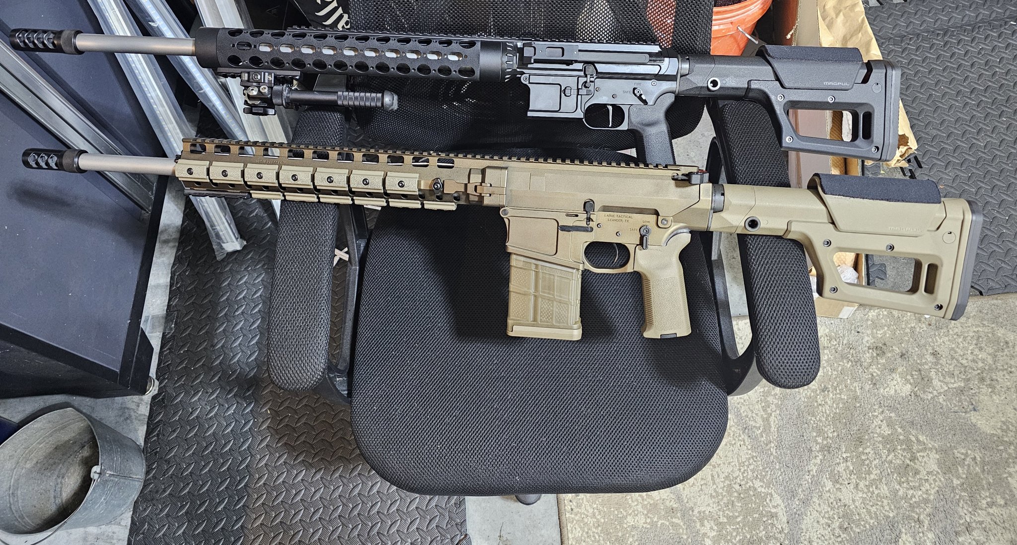

I finally got my Bartlein's in for my 22" JP .223 and 20" tOBR 6.5CM, between the Cluster Fuck at CLE and sending them off for Cryogenic Treatment it took a good while to get them in.
I always run Tac in my .223/5.56 Gassers with exceptional Accuracy across a wide range of ambient temperatures, definitely doesn't seem to be as temp sensitive as many people claim. With the new 22" barrel I'm gonna give 8208 XBR a go and see if I can squeeze a little bit more accuracy out. Also upgraded my .223 brass from Lake City to Lapua and the wife picked me up another RCBS MatchMaster so I can reload for multiple rifles at the same time..
My review of the Larue and the two JP rifles in .223 and 6.5CM should be finished by next month.
