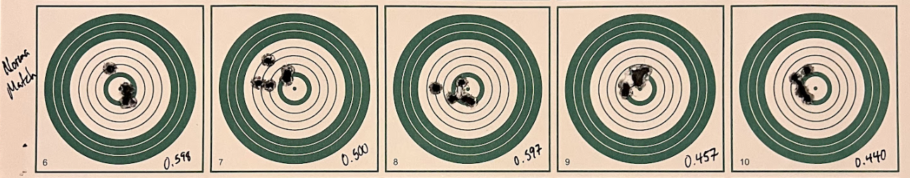

My Kidd 20" Threaded Bull Barrel will do 1/2 groups no problem at 50 yards with Norma Match 22 which is pretty cheap ammo.
I did a very small amount of research and found that a squirrel’s head averages ~1-2” wide and ~2-3” long; depending upon species, sex, and age of the squirrel. From that, I printed out a bunch of 1” circles, packed my Tac Sol barreled 10/22, grabbed some CCI SV ammo and headed to the range. I have access to a 25y and 50y range, so you’ll all need to be satisfied with 50y shooting. (The gun shoots Lapua CenterX better than the CCI, but that’s like 3-4x more expensive when you can find it.)
35(ish) year old Ruger 10/22 action and bolt.
Tac Sol barrel
Kidd 2 stage trigger
Magpul stock
Cheek rest whittled from irrigation pipe
CCI SV ammo
All of this is to say that a relatively inexpensive barrel and ammunition is more than sufficient for squirrels at short range.
My Kidd shoots better than the above, and adding better ammo it shoots better still.
