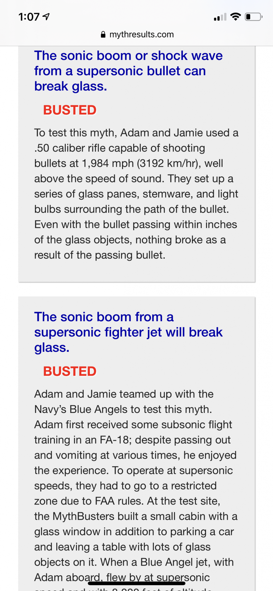

Also, even mythbusters have done both the .50 cal and supersonic jet shockwaves things already.

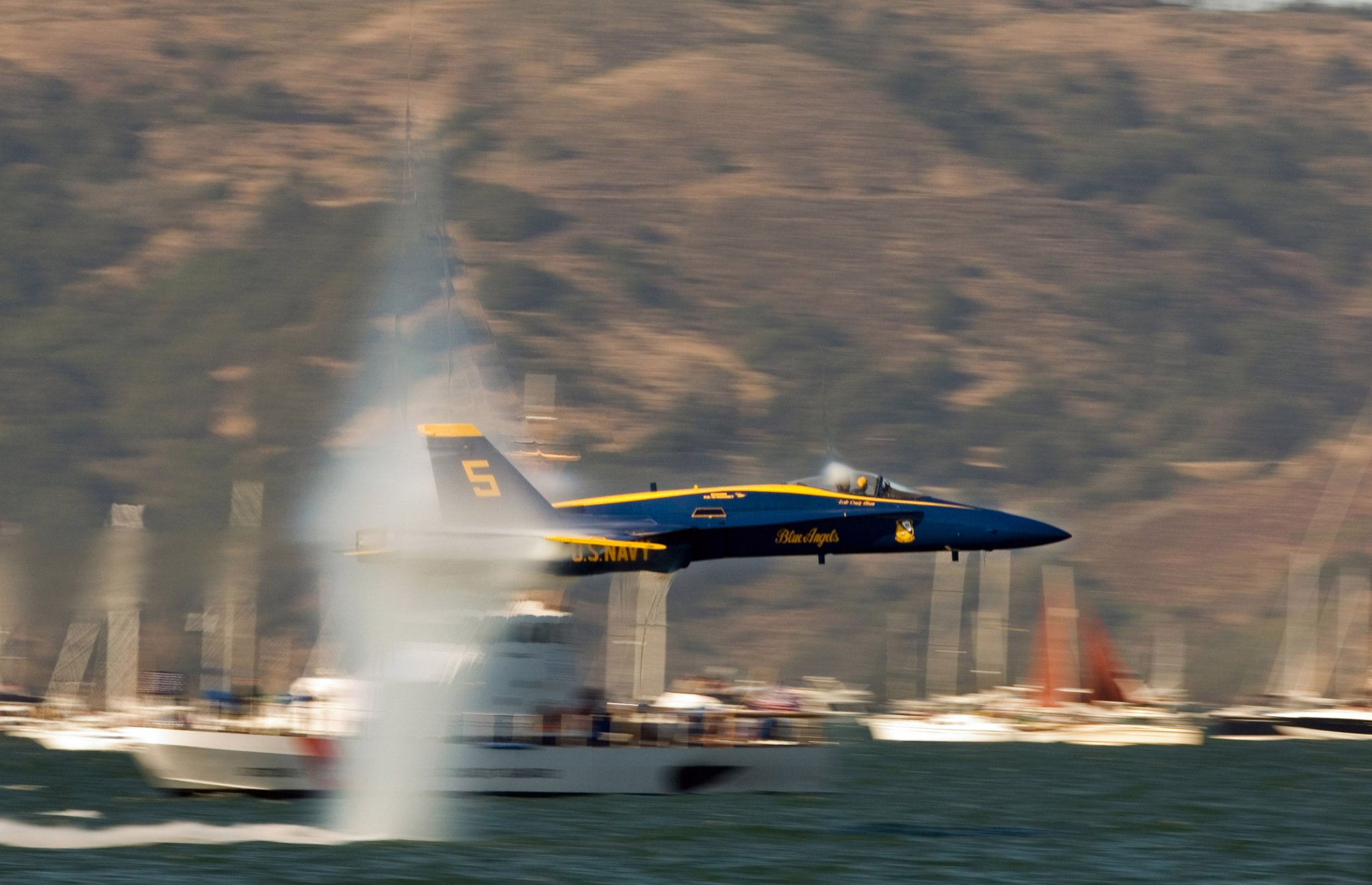

If you will notice, there is a lot more happening around this aircraft than just "clouds." Look at what is happening in the water behind and 30 feet below it. If nothing else, though momentary, I don't know what that much instantaneous pressure differential would do to you if you were within inches of it. It would be interesting to see what Mythbusters said about it. I'll make the time.
It's an Angel flying just above the water. It is also photo shopped. I was standing 300 feet behind a Mirage the other day and could feel the heat with it just sitting there idling.

Watching the water after the plane passes there is no real effect on it at all. No waves or anything of the sort.
There’s less of a disturbance in the water than my kid’s 10hp tin boat kicks up. Are you STILL on about this?

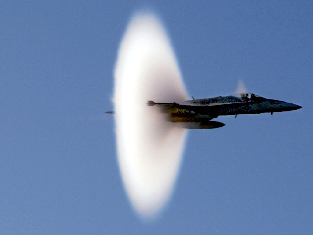

That condensation is caused by nothing more than a localised low pressure region in a particularly humid atmosphere.
Condensation is not unique to supersonic objects either, it will occur any time the relative humidity reaches 100%, whether that is caused by a drop in pressure, drop in temperature or increase in water vapour content.
Additionally, as the water vapour content increases, the pressure or temperature drop required for condensation to occur, decreases. Depending on the RH in your above scenario the pressure differential required to cause condensation COULD be as low as a fraction of a PSI, the human body can withstand many tens of shockwave PSI before death/damage, one paper on this is linked in the source below.
