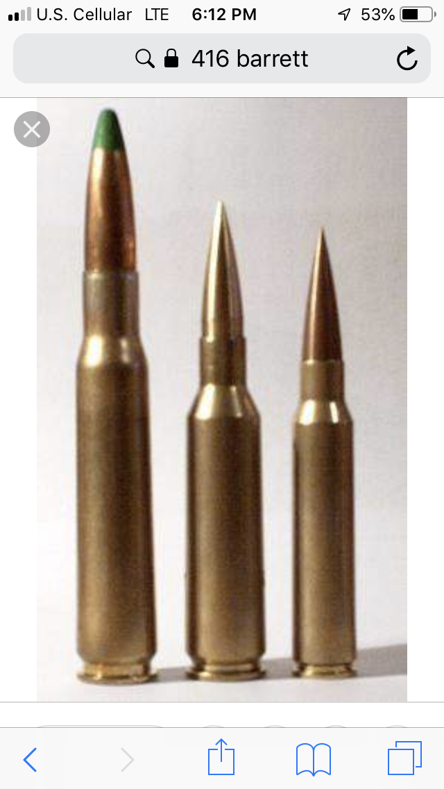

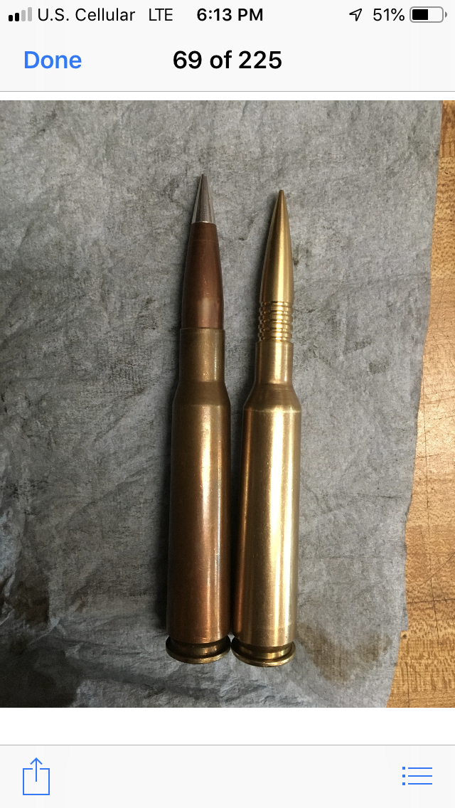

50 on the left, Barrett in the middle.
The Garrett is pretty much just necking down the 50. Not shortening it.
Reactions: armorpl8chikn
Threads too small maybe on the barrel?
There is a lot of "Flat" on top of those threads.........:eek:
And, to me, most importantly.........Was this the first round fired from a new build ?
If so, to me, it really points to what Geno is saying about the trunion threads being too small/inadequate diameter for proper/acceptable/safe thread engagement. Actually, the more I think about it, given that the barrel was launched down range, that has to be what it is. IMHO, Geno's right.
Barrett isn’t a 50bmg case. He had 215gr of powder behind this.
He normally shoots 416 Barrett, but wanted more case capacity
