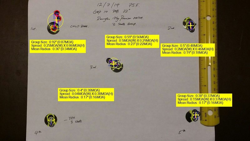

    3/4 inches are my best 5 shot groups with the rifle (Fgm 168) I would say the rifle overall is an Moa rifle with match Ammo. I rarely get to shoot past 300 yards, so hard to tell. For a longer distance shooting, you might be better off with an 18 and 20 inch barrel on the gap and mws. Another thing to keep in mind is that the scar has a pencil thin barrel where the gap and mws have heavier profile barrels. In the end though my scar eats everything, and that wasn't my experience with a 20 inch mws and an 18 inch gap 10
    Take the above accuracy numbers with a grain of salt. I would love to see all 3 of those rifles produce 6x5 targets. I assure you none of them would result in the numbers posted above.;) Will they sometimes shoot a group that measures the above numbers, sure. But they will not consistently shoot those numbers. A GAP10 is an accurate rifle, it is not a 0.3moa rifle by a long shot.
    You wont find many people that shoot custom bolts guns across a 6x5 that result in 0.3moa... We need to get off this my gun shot a group that measured .325" so its a 0.3moa gun BS.
    Now back to the OP. You will want to add JP into your mix. They are very accurate factory guns. If you want to save money and have every aspect of the gun be exactly as you want and it be very accurate you can build your own as well. Bartlein barrel, billet ambi matching receiver set, Geissele SSA-E or SD-E trigger, JP BCG, Magpul PRS stock, SLR adjustable gas block, take your pick of handguards (Geissele, SLR, Daniel Defense, Seekins, keymod, mlok, etc), JP SCS or standard 308 rifle buffer, ERGO grip, etc. You can have the best of everything and have it exactly as you want it for cheaper than the above rifles and it will be more accurate than "most" of them.
    Fair enough. I was giving my best set of groups. And those groups weren't done once, they've been done almost a handful of times.
    the problem with using averages is that it incorporates user error. Maybe might be more accurate to say that the scar is moa, lmt 3/4, and gap .5 inch rifles with match grade ammo
    Only if the user is not capable. Using a bigger sample set tell you what the rifle is truly capable of. My experience with all 3 of those guns is GAP10 just under 3/4moa 6x5, LMT 3/4moa to submoa 6x5 and SCAR17 1.25moa 6x5 at best. We dont measure guns accuracy around here by cherry picked groups. If that was the case I have a 0.080" 6.5x47L, a 0.1" 223 Bolt gun, a .25" 308 gasser, etc etc..... Accuracy is measured on what the gun can repeatably do time after time. Not something it did one time. Take your guns, go out and shoot 5x5 or 6x5 and see what I mean.
