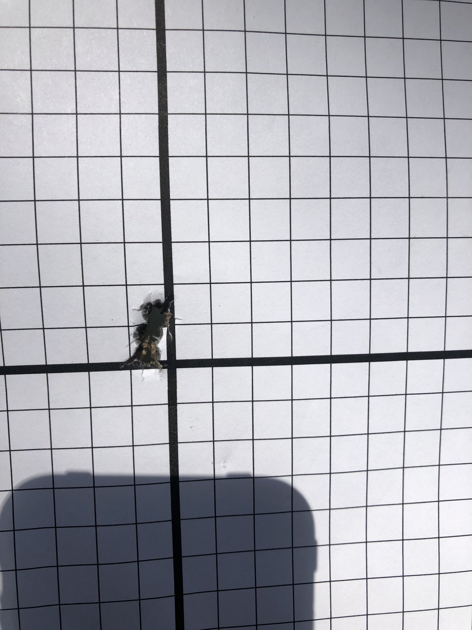

Paul - @LRRPF52 has a bunch of experience with 6.5 Grendel in Short Barrels.
I'm sure he can guide you toward the do's and don'ts in the world of Short rifles.
He's responsible for my entry into the Grendel World.
5 Rounds of hand loaded 120 Nosler Ballistic Tip at 100 yards

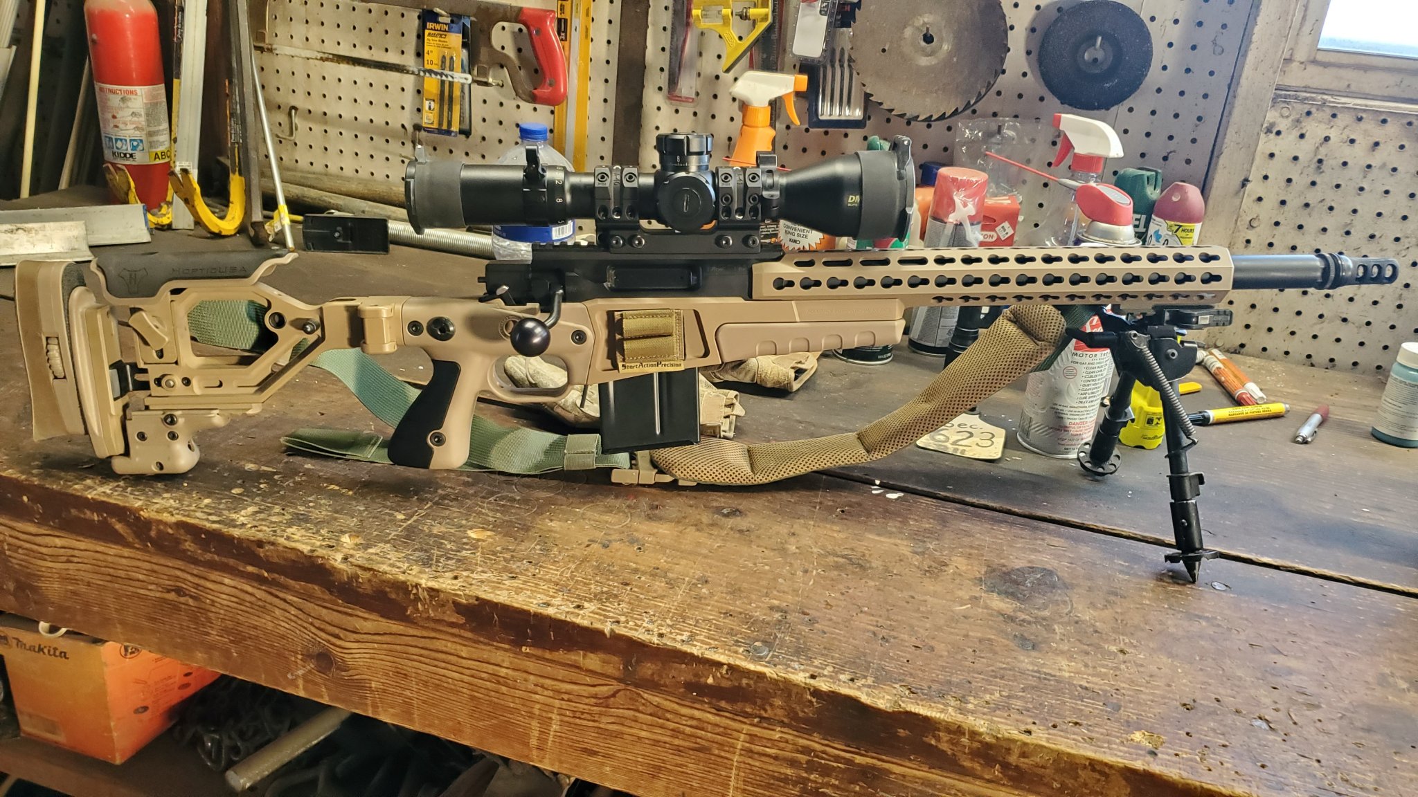

When you say "very compact", what kind of physical space dimensions are we talking about?
Does something like this fit the size you're talking about?
If you go up to a 6CM, you will need a larger/bulkier action that will be difficult to maintain a sight picture with in such a small package.
The little SAKO Vixen-inspired Howa Mini Action is a very handy, lightweight bolt action with a lot of versatility and ease of carry.
Reactions: Blue72
Exactly what im looking for. What chassis is that?

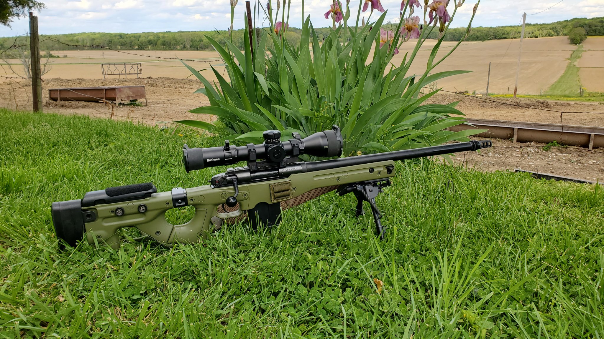

I am building a .22 grendel on the Howa Mini and looks like good velocity with 77 grainers in a 16 to 18 inch barrel.
Gonna be my backpack gun.
With .224 AR or .22 Grendel, I would look at 80gr and higher as well. You'll get way better wind-deflection and more energy on-target. A buddy of mine is doing a lot of wildcat work with .224 cats right now shooting 80gr and heavier. Surprisingly-capable out to 1000yds from a bolt gun. He's re-barreling Howa Mini actions and doing all kinds of work to them. Makes a great little training rifle.
