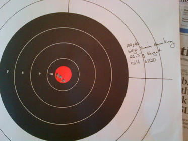

I'm going to disagree and say the High Speed National Match is the ticket for precision! It's another 60 bucks over the others, but for that you get an adjustable trigger with half the lock time and an even cleaner break. If you are shooting for precision, it's about the best there is in the AR platform.
I went from 2" groups at 100 yds. to a target like this with the SSA-E.
Boy was I tickled pink.
Not for field use it isn't. No doubt the nm is the best bench rest trigger for the ar out there but it will require a totally different setup to be field safe IMO. My buddy has one in his grendel and it's awesome for punching paper but not for hunting coyotes. The nm doesn't have any cleaner of a break than the ssae it just has a shorter break if you adjust it right. The nm requires the sear to be set right on the edge and the second stage set very light to get the full benefit of it which will not be a setting you would want for field use. The ssae is the perfect mix of precision and safety for a gun that won't live just on the bench. Of course that's just my opinion but I own or have shot all the ones being discussed. The nm is good and I will getting one for my 20" bench and prairie dog gun.
