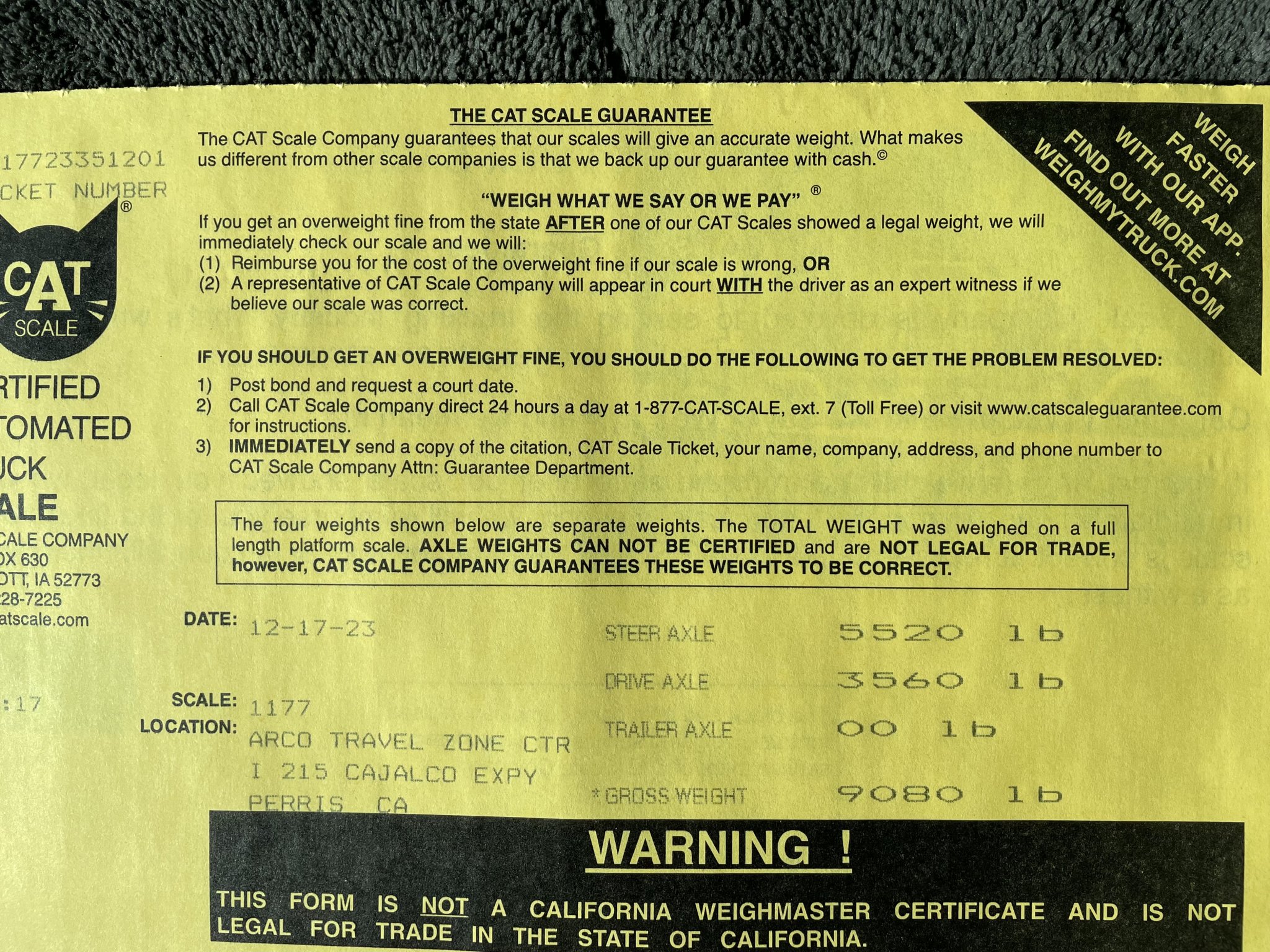

My work truck is a '21 F250, 6.2 gas with 3.73 gears, sits around 9k lbs tooled up on a daily basis and has never had anything on the bumper. Running the Wyoming highways on cruise at 70mph, even mild hills knocks me down to 4th gear and even 3rd when the winds are stiff on the nose. It's just the nature of gassers and double OD transmissions, where 4th is the 1:1.00 ratio gear. Getting downshifted isn't a bad thing, it's just how they behave these days with fuel efficiency being a federal mandated priority in the shift step programming and having multiple OD gears above 1:1 available.

I went looking for my window sticker but couldn't find it and the rear differential info wasn't in the door panel. But sounds like I'd be best served getting a different gear ratio.
