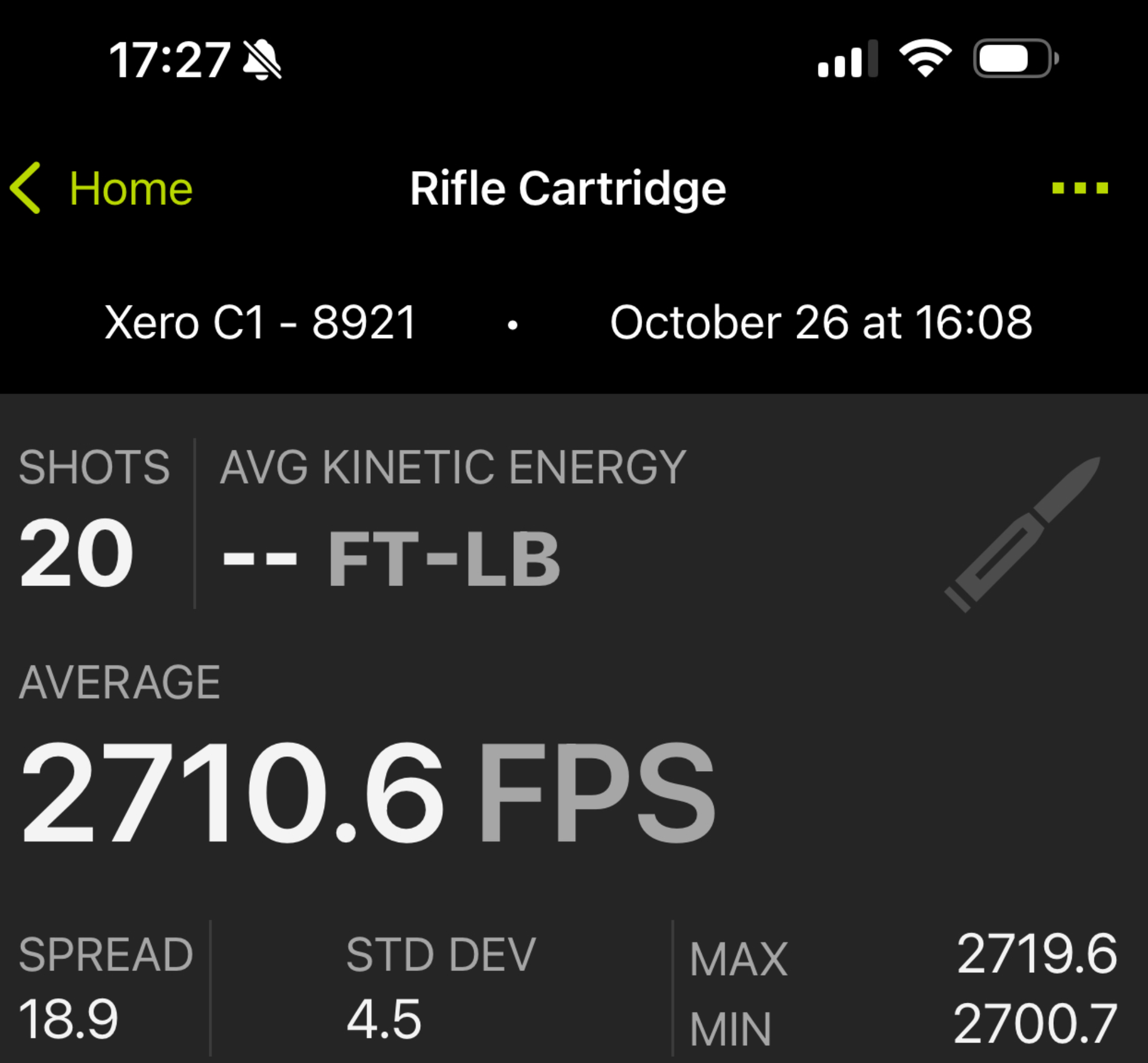

For me the Garmin specifically was a real game changer. Not having the chance to shoot more than 2k rounds a year including competitions, it gave me the intimacy with the behaviour of my gun+ammo that I was not able to achieve before. The Kestrel is all you need on top of that.
