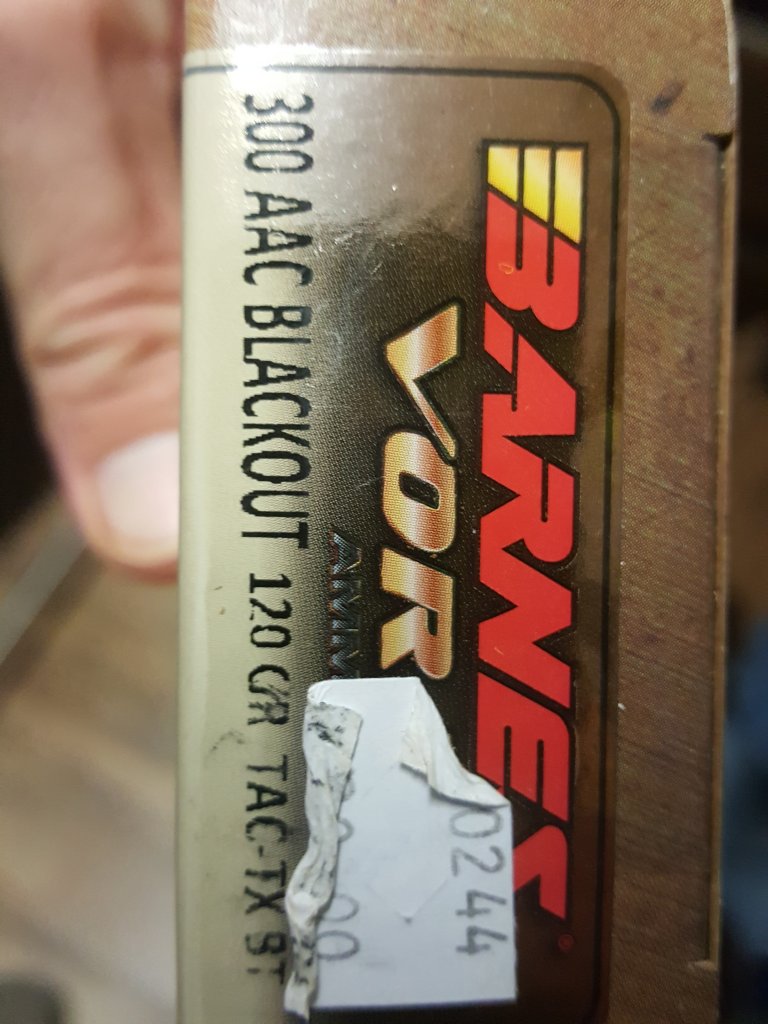

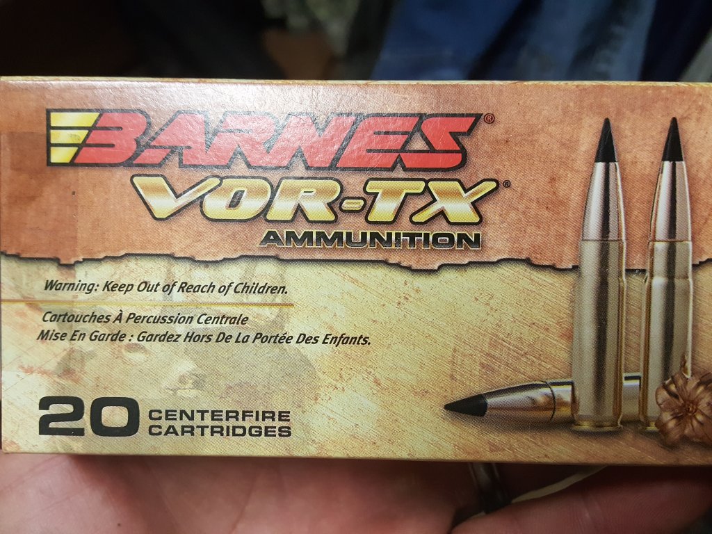

These work great on hogs. Haven't tried them on deer. I would suggest keeping ot within 100-150 yards if want to drop them where they stand. 120 gr Tac-TX
You sure those are 120gr? Mine of those are all 110gr I believe.
For some reason I thought the op wanted to use subs, for supers I would use those Barnes loads. That's what I have been using.
