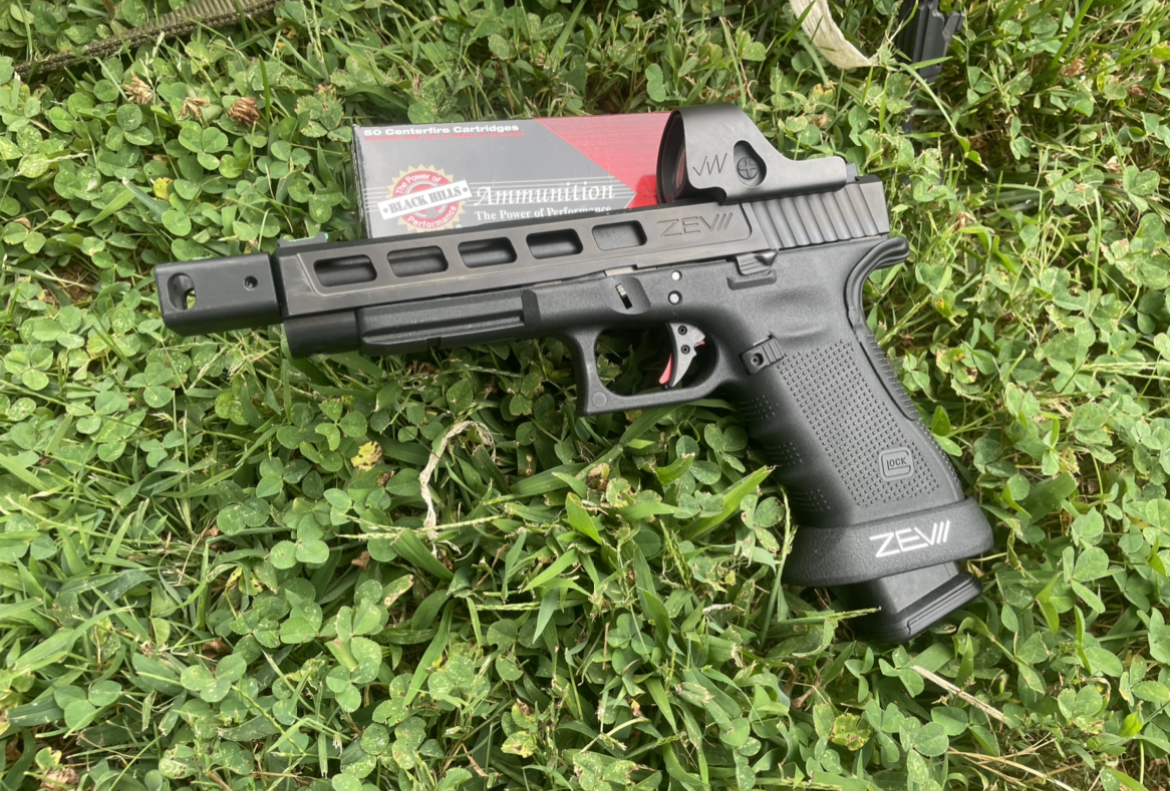

After last weeks night 2gun I have finally come to the conclusion that I need to at least properly try a pistol red dot. The irons were just too hard to align on 5”x5” flippers under a flashlight.
I have a couple RMRs piggybacked in URGI-ish builds and I like them enough for that but I am considering going a different direction on the pistol.
Pistol is used for 3 gun and run and guns.
Pistol will 100% be under muddy water multiple times per run and run.
2-5 night matches per year, about the same for day matches.
Rain or shine, we shoot.
I will be moving from white light to Nightvision later this year and it needs to be a good candidate for passive aiming
Already have Safariland for G34, Prodigy and M17 with red dot. Probably going to use a gen3 G17 w/o MOA cut (dovetail plate mount) for now but may try the Prodigy as well.
Have been looking at:
ACRO p2 ( concerned about FOV)
Holosun 509 (have reservations on China and reliability)
RMR ( open emitter, not in love with distortion but I can live with it)
507Comp (same shit as 509)
Leupold DPP NV (no real opinion)
Also, thinking I really want back up irons. If not to start, eventually.
Having only shot behind the RMR on a pistol I am fucking paralyzed by analysis. Could use for advice from though who regularly shoot in the rain, and use NODs.
Thanks,
Chris

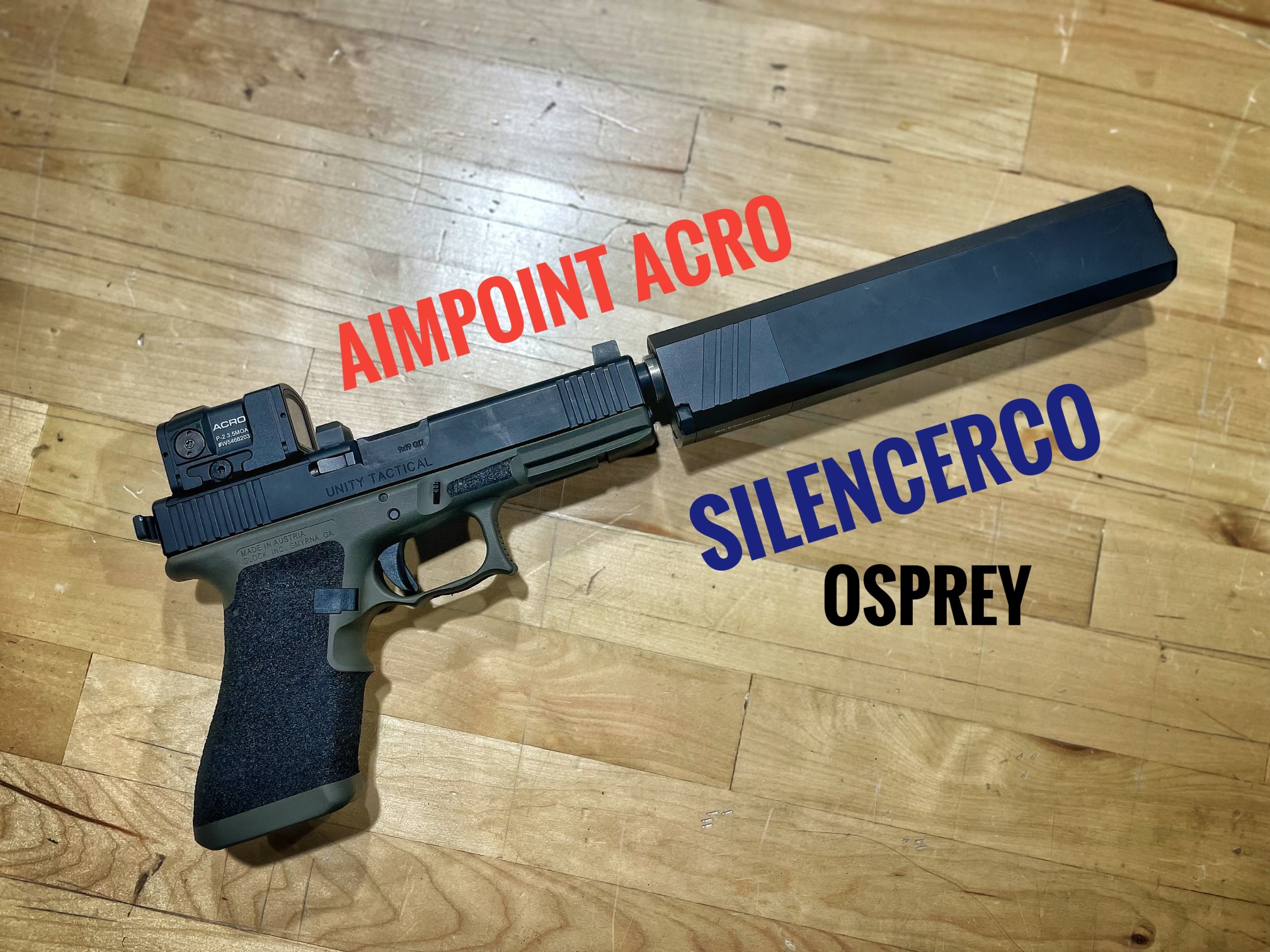

acro p2 is what you seek ;)
This is how I’m leaning, and my gut feeling is since I’m fairly used to the RMR on a piggyback my “pencil tube” concern with the ACRO may not be an issue.

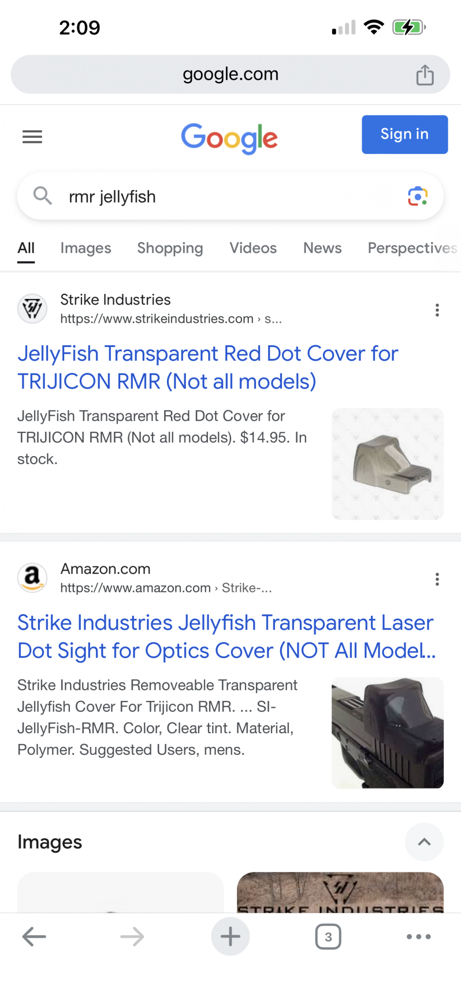

What do you folks think about running a jellyfish on an open emitter?
Completely useless in my experience. Pulled my rmr off carry gun and put it on my franchi affinity 3 for turkey season. Was worried about water messing up the dot. Thanks to @308pirate shared videos I feel better now. Opening day in Ohio last year for turkey season it was wet and rainy as hell. I could barely see through the jellyfish with it dry. Once it got wet forget about it. I ended up pulling it off and idk even know where it is now. Have had rain/dew from moving through the turkey woods on the rmr but not that big of a deal. This is what I bought, imho save your money. Or pm me and I’ll find mine and you can have it for free.

I think you should. If you don't want to be able to see shit.
Did you bother looking at the videos I posted?
So, I did in fact. I live in WI. My drop tests are occasionally in snow. Ice has rendered my RMR useless, as in unable to complete the event. Just this year, it snowed (actual blizzard) so hard the 200y stage was reduced to 50y because of visibility. My holstered pistol caught so much snow I couldn't use it and I'd rather a $15 solution than a $500. It's cheap to ask the question, but I suppose you run the risk of Bear pit dwellers talking shit.
Alright, so it's value is a cover and not any sort of "sacrificial lens". Sounds like something else is in order, thx.

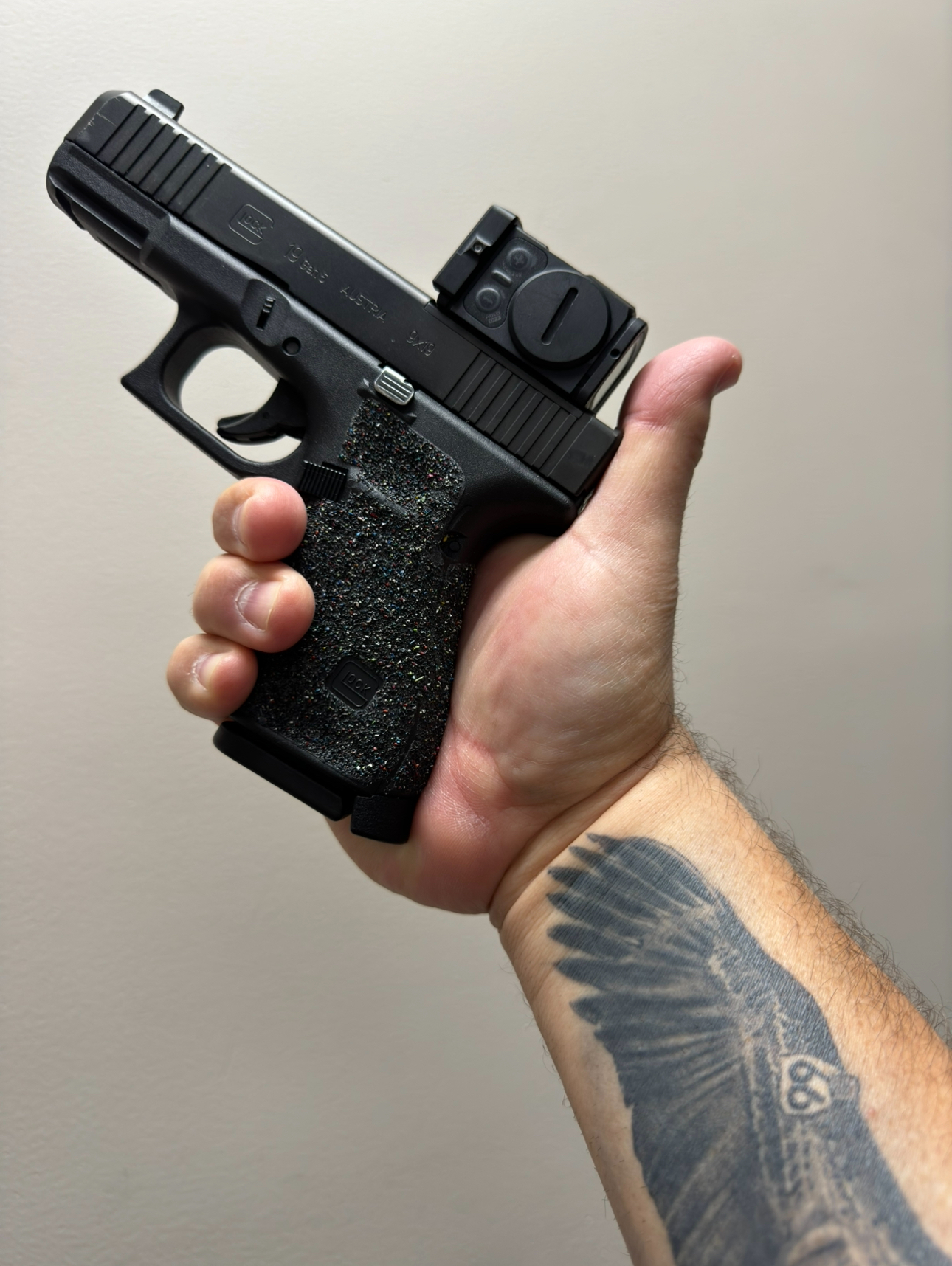

So I just bought my wife a Walther PDP, is there a plate to get the ACRO to work on it? Also, she struggles with finding the dot so I was thinking the large (50-60moa) circle around a 3moa dot would help find center quicker. Is that a reticle available in the ACRO?
Thx,
JoeZ
Aimpoint doesn't offer gimmicky reticle options because they're a Mil optics maker, and the optic's chassis & lens "frame" the dot.
The main reason people have trouble is poor pistol presentation to target. It's just a training issue and the fastest way to learn to get the dot to superimpose over the intended POI is to use masking tape to cover the steel sights so they're not visible, then with an empty pistol- practice pressing the pistol out toward the target, then back toward the eye, all the while focusing on the target[...]
[...] Pretend the pistol is on a rail and have her focus on the target while pressing it out and then back in. After she gets good at that, have her draw from holster, raise the leveled pistol to eye, then do the rail thing out and back, then back into holster.
For the PDP mounting plate: https://benstoegerproshop.com/walth...for-aimpoint-acro-by-forward-controls-design/
A good, short video that should help any shooter trying to learn the use of dot optics:
Reactions: JoeZ and CSTactical
Yes. A simple internet search will turn them up. In fact, if you look at the paperwork that came with the pistol it will tell you how to get one FOR FREE
That's because her grip (and index if drawing from a holster) are terrible. No gimmicks will fix that. She needs instructions from someome who knows what good grip and index are.
