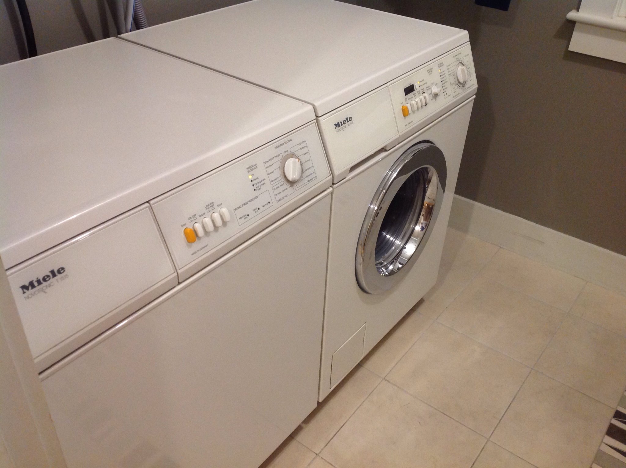

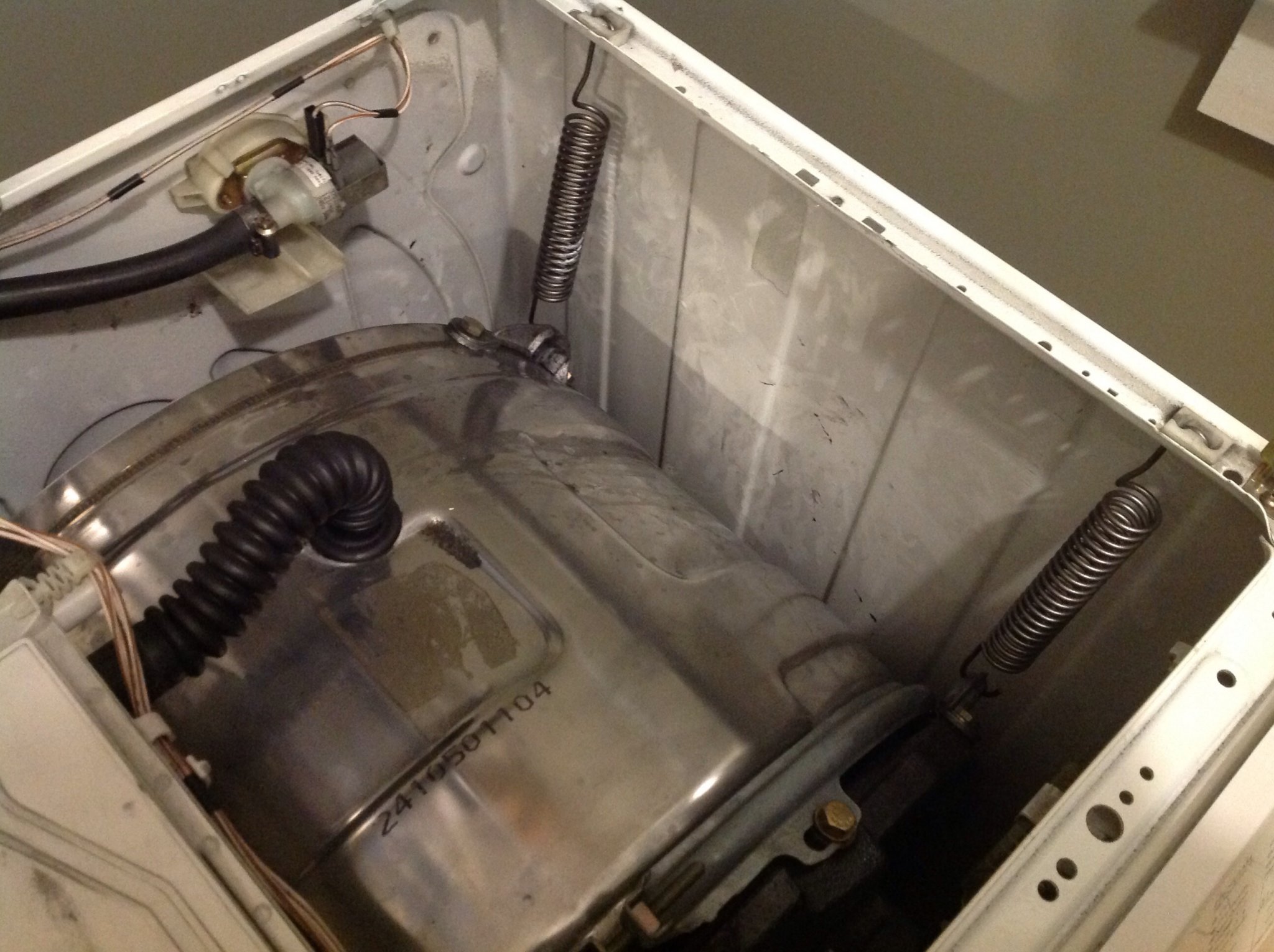

    Im thinking my Miele washer is giving up the ghost.
    Got twenty years out of it, made some repairs, think the springs, shocks or main bearing may be shot.
    Heard Speed Queen front loaders are pretty repairable if they break. Kind of spendy. Made in USA.
    Second floor install.
    Bigger capacity is better. Kids go through too many clothes each week and would be nice to throw queen size comforter in rather than going to laundromat.

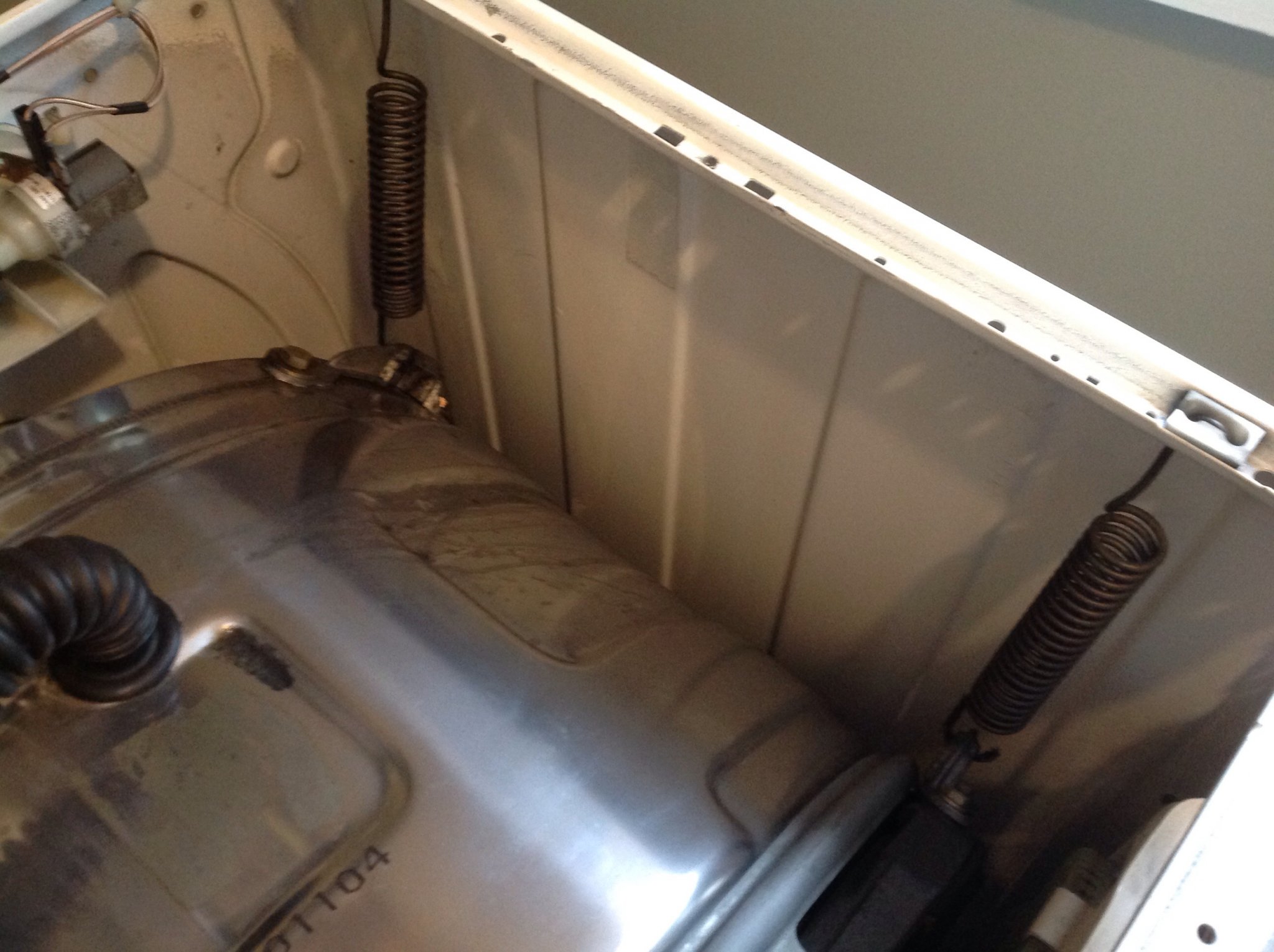

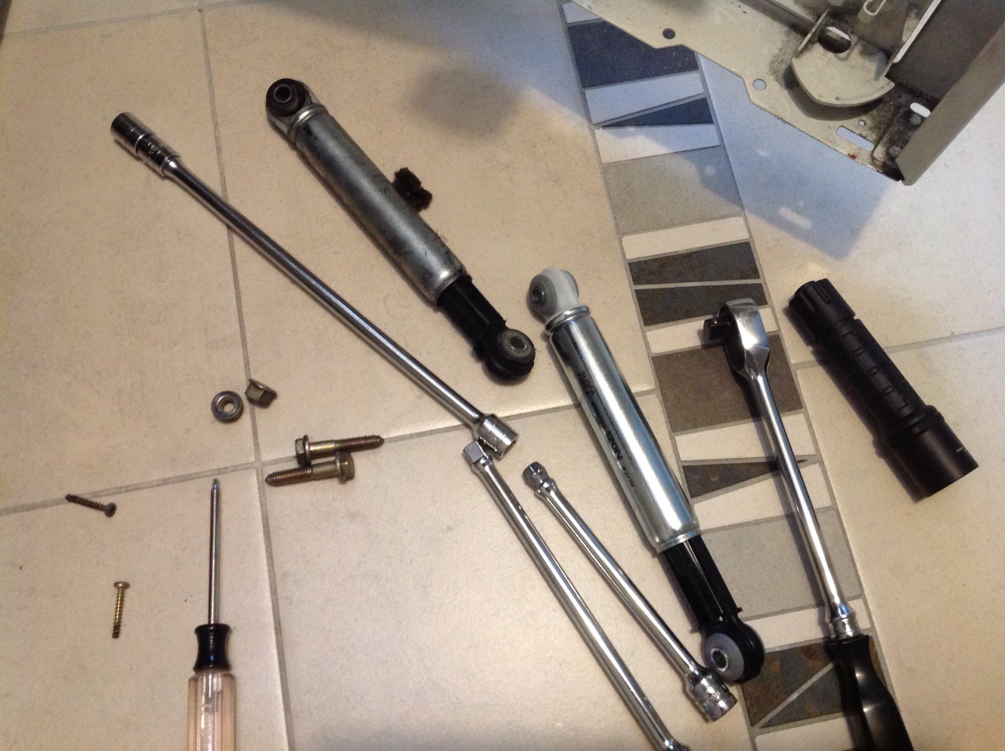

    After looking at a bunch of youtube videos for changing springs and shocks on my Miele Im giving that a thought. Might price up parts this AM.

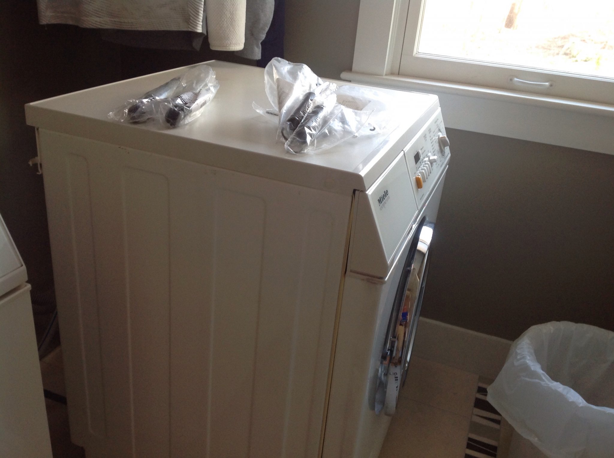

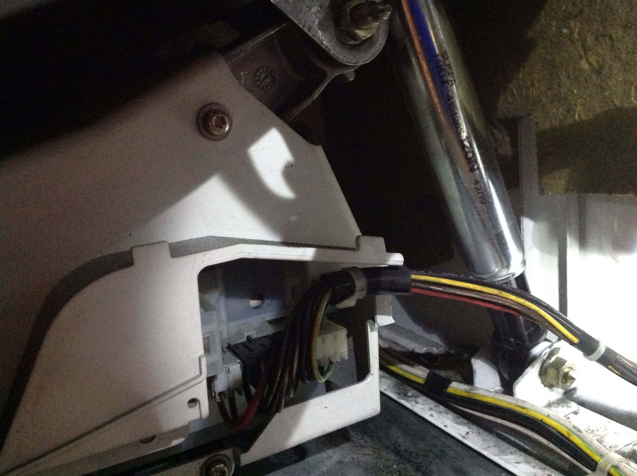

    Ordered 4 new springs and two shock/dampers.
    $180 with overnight shipping.
    Will see if I can keep it running.

    Parts in route, fingers crossed.
    Ive either turned a $2K expenditure into a $180 expenditure (and a Saturday of free time) or I made my $2K expenditure a $2K plus $180 expense.

    Miele is about the best brand you can buy..............yes, $$$$...........but they do what they are supposed to do.......I work in the pharmaceutical industry........we have Miele dish washers in our lab............8K-10K for a dishwasher?

    Sounds good but I think when it went unbalanced it caused another fault code.
    When it gets to the rinse cycle I get a blinking light which is a fault code of some sort.
    Quick search indicates it could be a drain filter but that's too easy a fix, I won't be that lucky.

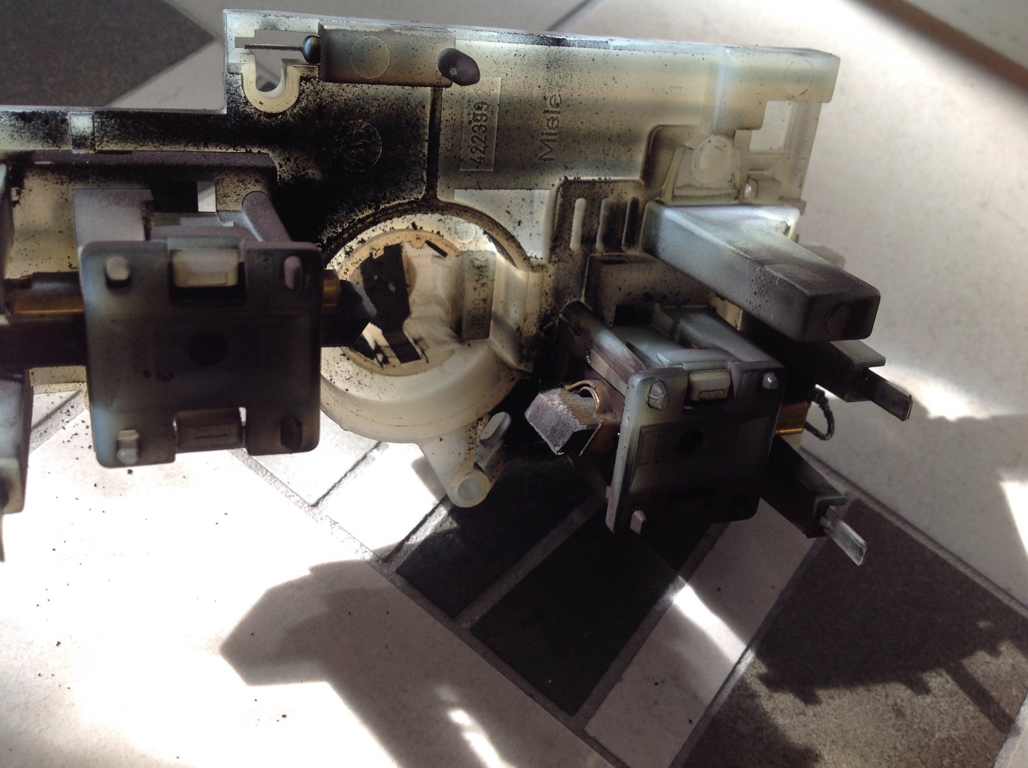

    Im betting motor brushes are worn after twenty years.
    I used to be able to call Miele and the techs would do diagnostics right over the phone having me punch shit into the control panel, than tell me what parts to get but they started sucking about that ten years or so ago.

    Going up to check it again in a moment, I'll flush the drain filter.
    The shocks were completely compressed and the new springs are noticeably shorter. Work that certainly had to be done but if fixing this fault costs me a repair man I'll be wishing I had just gone with the analog Speed Queen top loader.

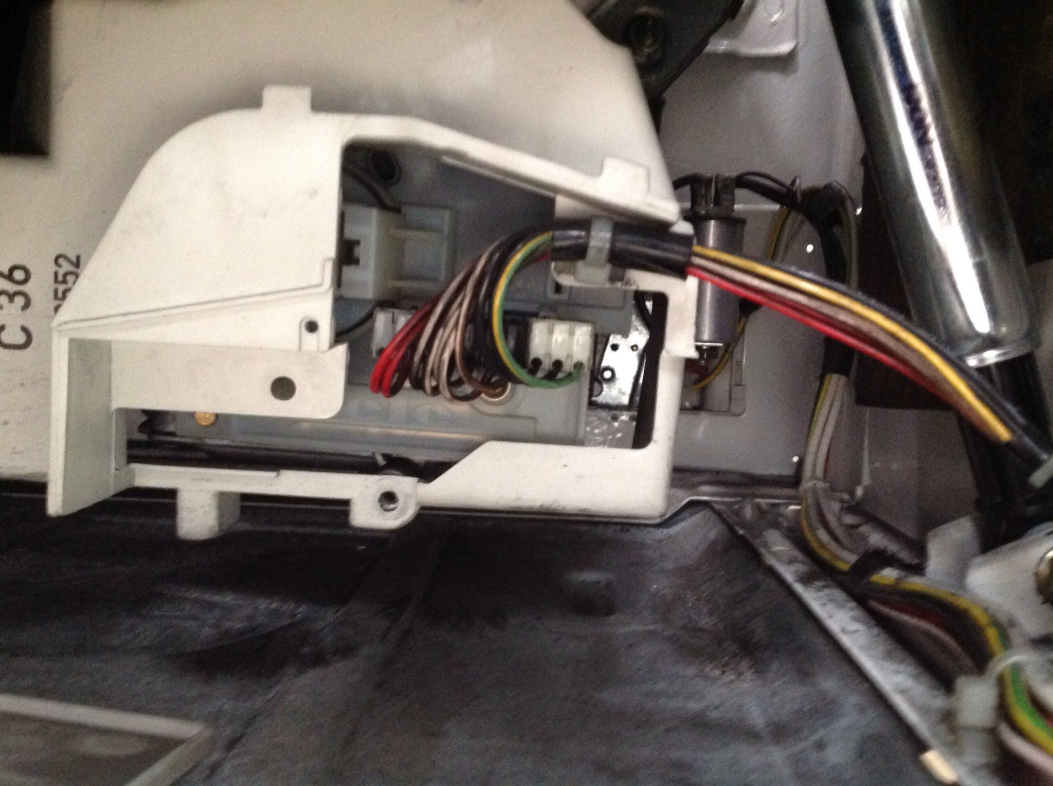

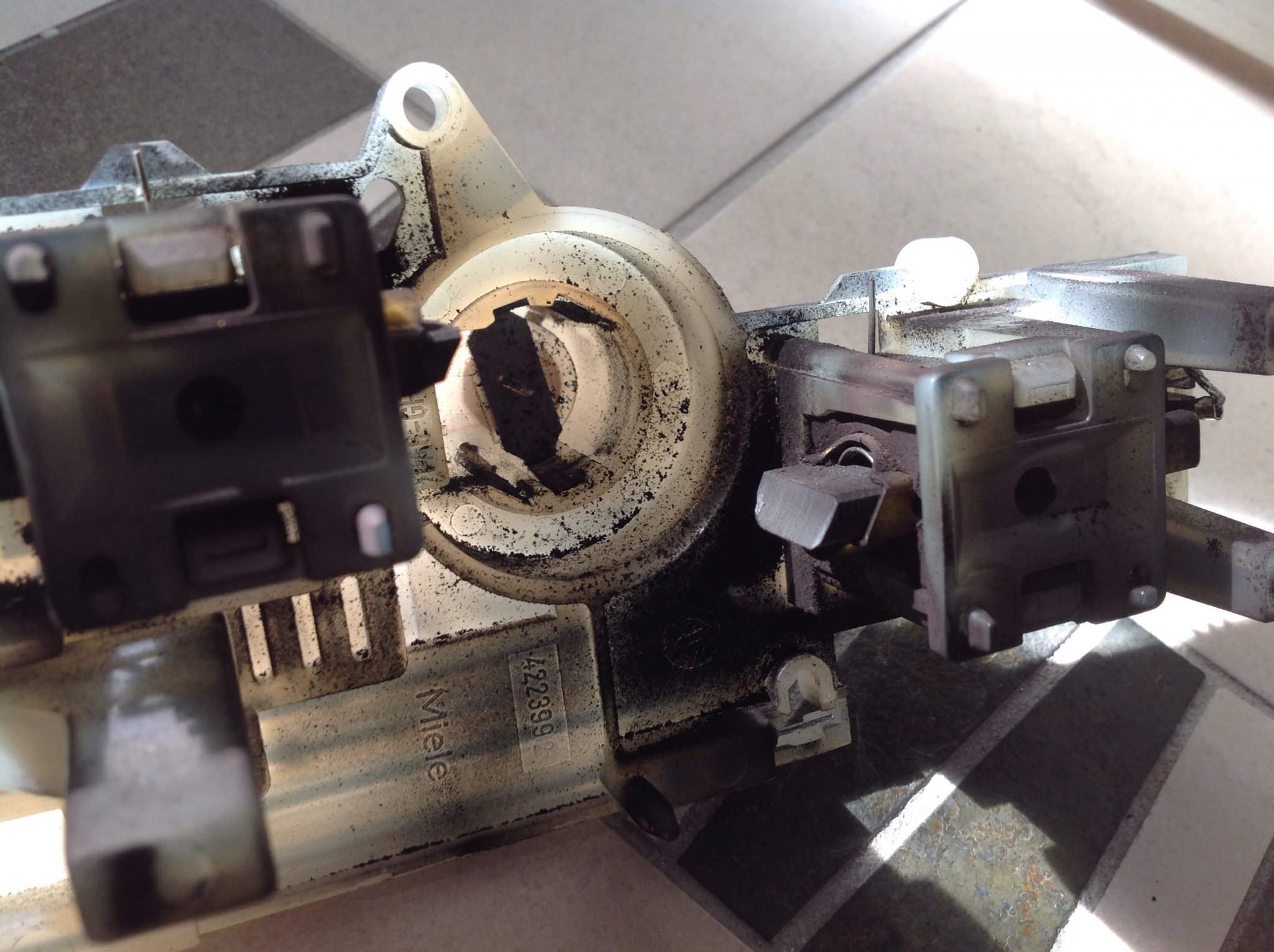

    One of the pictures here seems to show the motor brushes accessible from the front of the machine.
    I might as well open it up one more time and if the carbon is gone than that would be a cheap fix.
