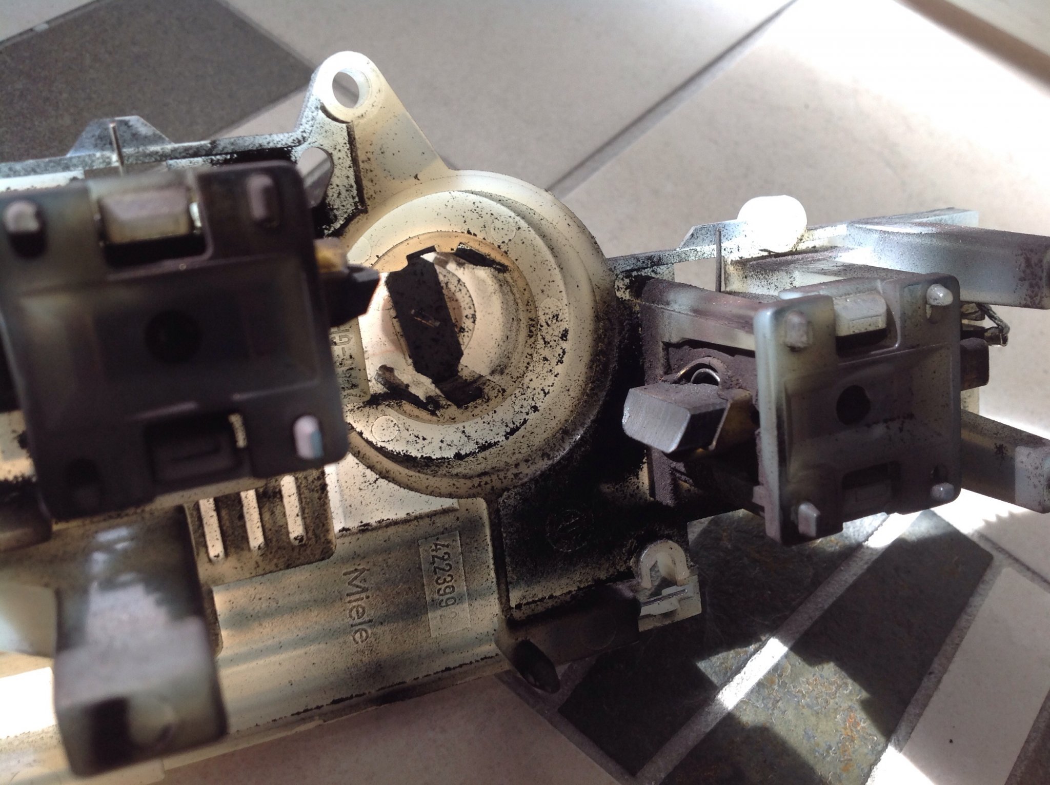

Can't get a picture of the armature......feels smooth, not scored.
Looking at how long new brushes are and comparing to ones on my machine they are real short.
The diameter of the armature would seem to indicate barely contacting.

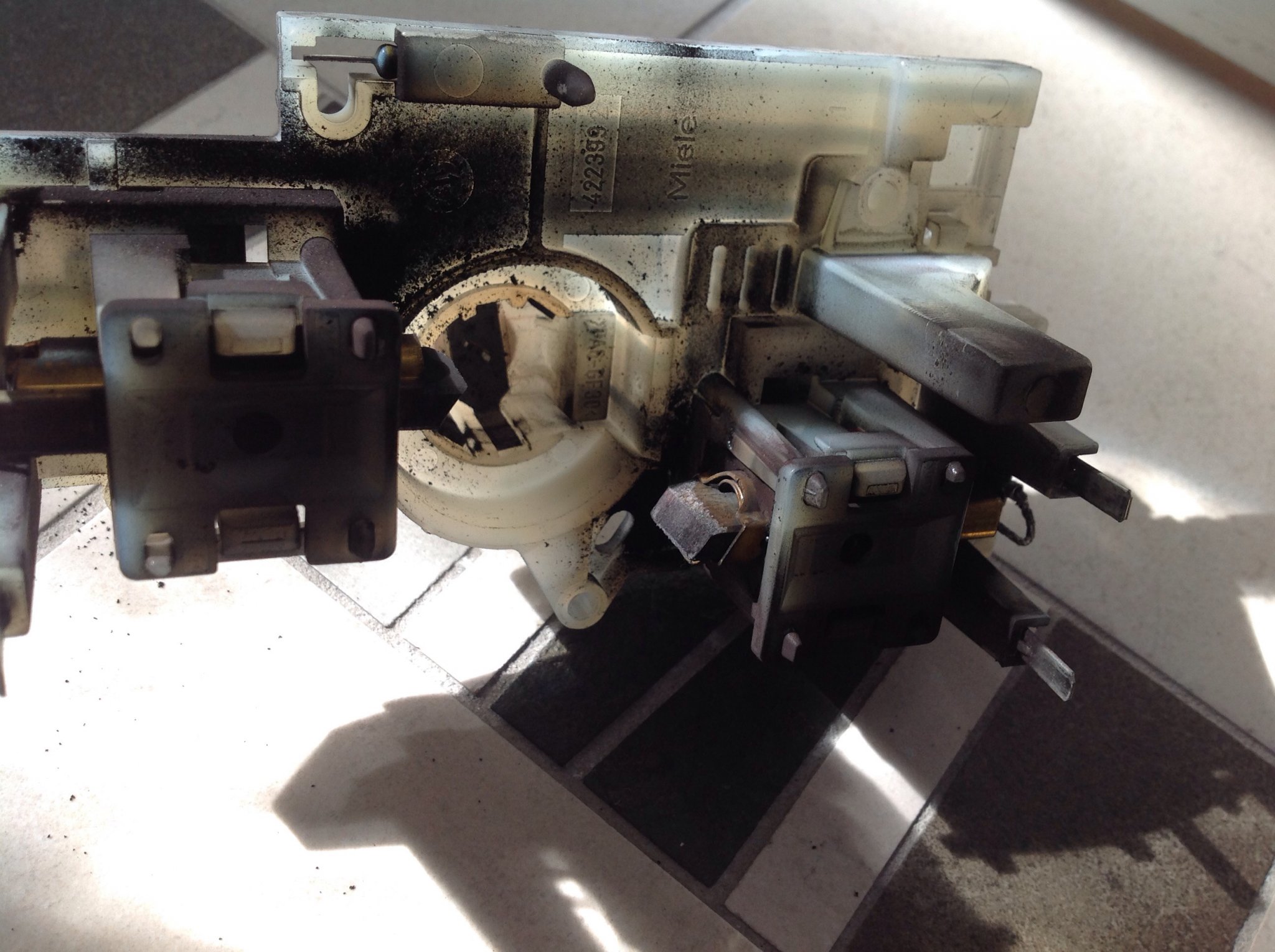

The brushes look short from wear
This is a new brush I screen shotted from a Youtube video. Compared to mine lots bigger....story of my life.
This guy is showing how to change brushes. Unlikely the parts he is using are actually used as the housing is not covered in carbon like mine is from twenty years of use.
My used brushes look like the "old brushes" in his video.
Ill probably just buy the entire tacho housing with the brushes preinstalled and just attach it to my motor as an assembly.
Found some more info on line that the "Fault Code" I was getting indicates a contact problem in the tacho housing.

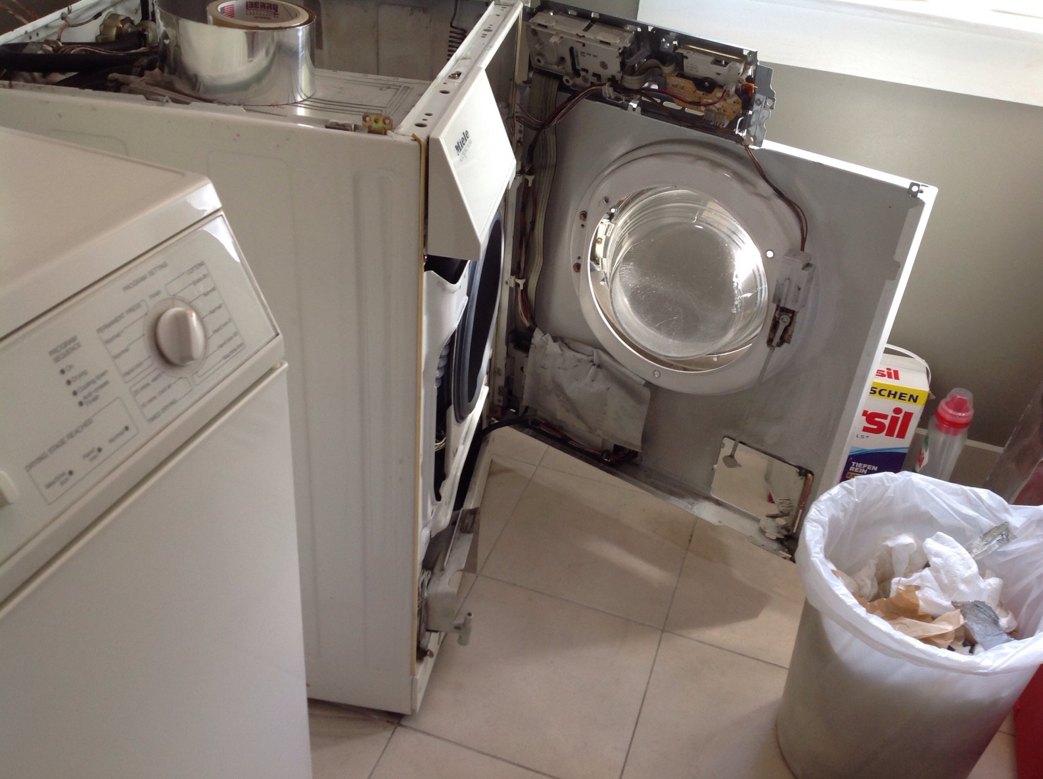

I thought the tacho module was going to be inaccessible for me but I noticed in the pictures I took last night that its right there in front of the machine so might as well try to put a new one in.

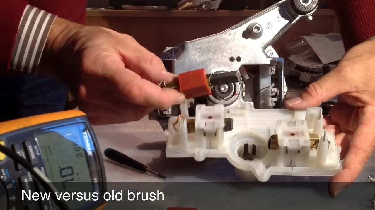

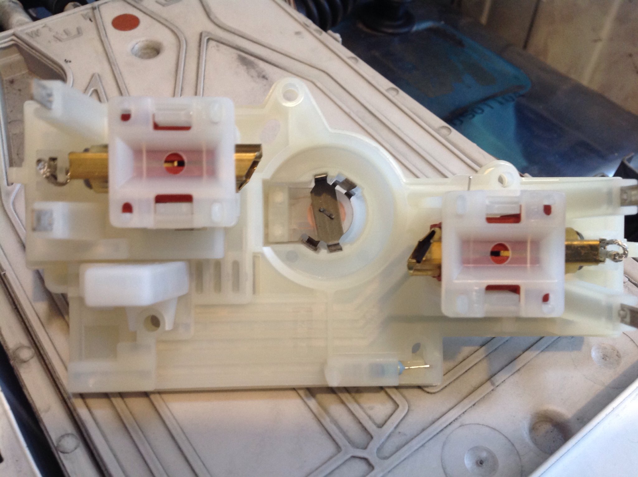

Oh man they booby trapped the shit out of me but I think I won.
Installed part as it came.
No good didn't work.
Opened up machine made sure brushes were ejected, buttoned it back up no good.
About to throw a wrench than I looked at both parts.
My old "cover" on the tacho has a brass pin on the bottom left screw hole. I'm guessing the brass pin and screw create some sort of contact.
The new tacho has no pin nor even a bore to fit one in.
I said screw it I will put the old cover on the new body.
Buttoned it up for a third time.....
Laundry!
Miele is a bunch of cunts. You might think they would tell the end user either verbally or instructions to avoid this trap.......or.........sell me the correct new part so I don't have to utilize old parts and toss the new piece as useless.
Waiting for a spin cycle to ensure I'm good but I think I beat this bitch.

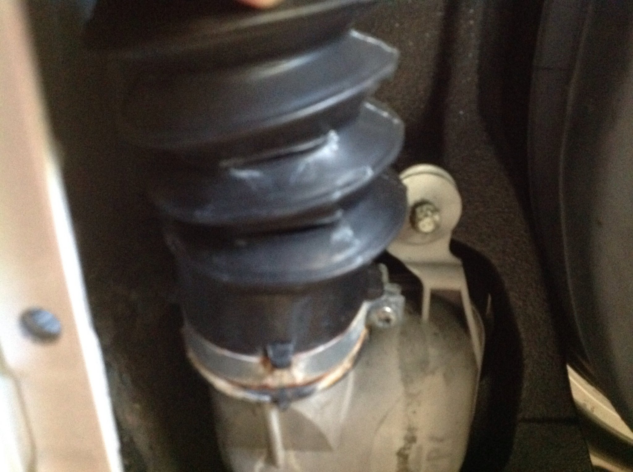

Changed the belt when I was in there.
Have to order the fill tube tomorrow.
Weird it is cracking there. They could use thicker rubber Im guessing.
