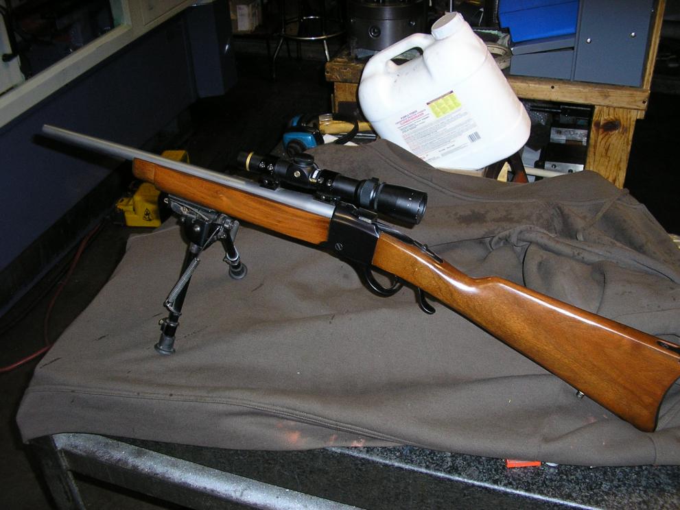

3000 fps with a 20 grainer out of that tiny case is crazy! Single shot right?
I just wish we had more squirrels around here. I got several calls from places I have hunted in the past telling me they were going to have alot of squirrels this year. Like an idiot i decided to get some builds completed that I've been putting off for the last 10-15 years. Got this .17 Squirrel back, then the .221 and will probably have the .375 back by mid summer and now everyone is saying the squirrel population is down again. I had planned on taking a break from my diesel hobby and do some shooting this year. Looks like I'll be playing with the truck again instead. Here's a pic of the .17. Not much to look at but it's short and light(feels like carrying a BB gun) and shoots alot better than i figured it would. If I put a 10 or 12 power scope on it I'd probably be impressed.

That li'l Ruger looks like a terminator style rig, ain't sexy but functional....
