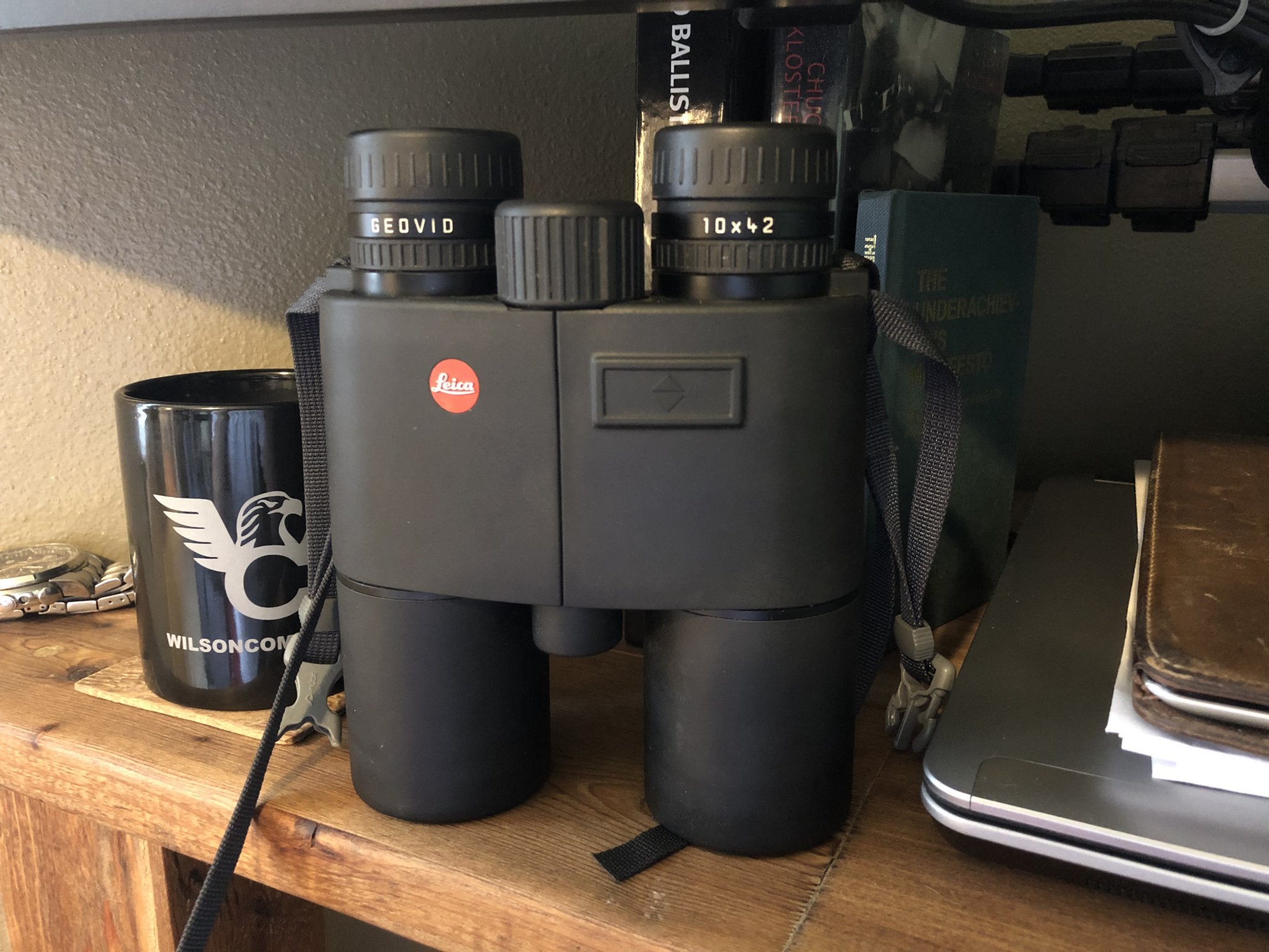

    I’ve used these Leica Geovid BRF-Ys for a few years now. Love ‘em.
    Reactions: Wyzrd
    Yup, these are the same ones that I just got. Found a great deal on them locally and I had to snatch them up. Before I did, I went to my local Sportsman Warehouse and checked out the Nikon Laserforce and Vortex Fury, and they both had a very noticeable bluish tint when looking through them. The Leicas are so much sharper, brighter, more pop, and no bluish tint (everything looks more neutral/natural). Edge to edge clarity is amazing, nice FOV, and zero chromatic aberration. Haven’t gotten them out to the range yet, but I’ve ranged a few things around my house and have gotten hits out to 1200+ already. Anyways, definitely worth the $ IMHO! Can’t wait to get these out in the field for critters.??
