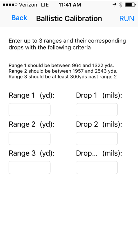

Savage LRP 6.5 Creedmore Hornady 143gr Hornady ELDX.
This is what my solver shows me as a truing screen. Are these ranges correct? 1900+ yds seems a bit far to true my 6.5? I was off 3.5" at 400yds & im sure I could not even hit a 4x8 peice of plywood at thoes ranges.
They are based on error probability. You can only get so accurate using a rifle and shooting at long range. Even if you shoot a 1/2 MOA group at 800 yards, you will still not be able to refine to less than 20 or so FPS.
