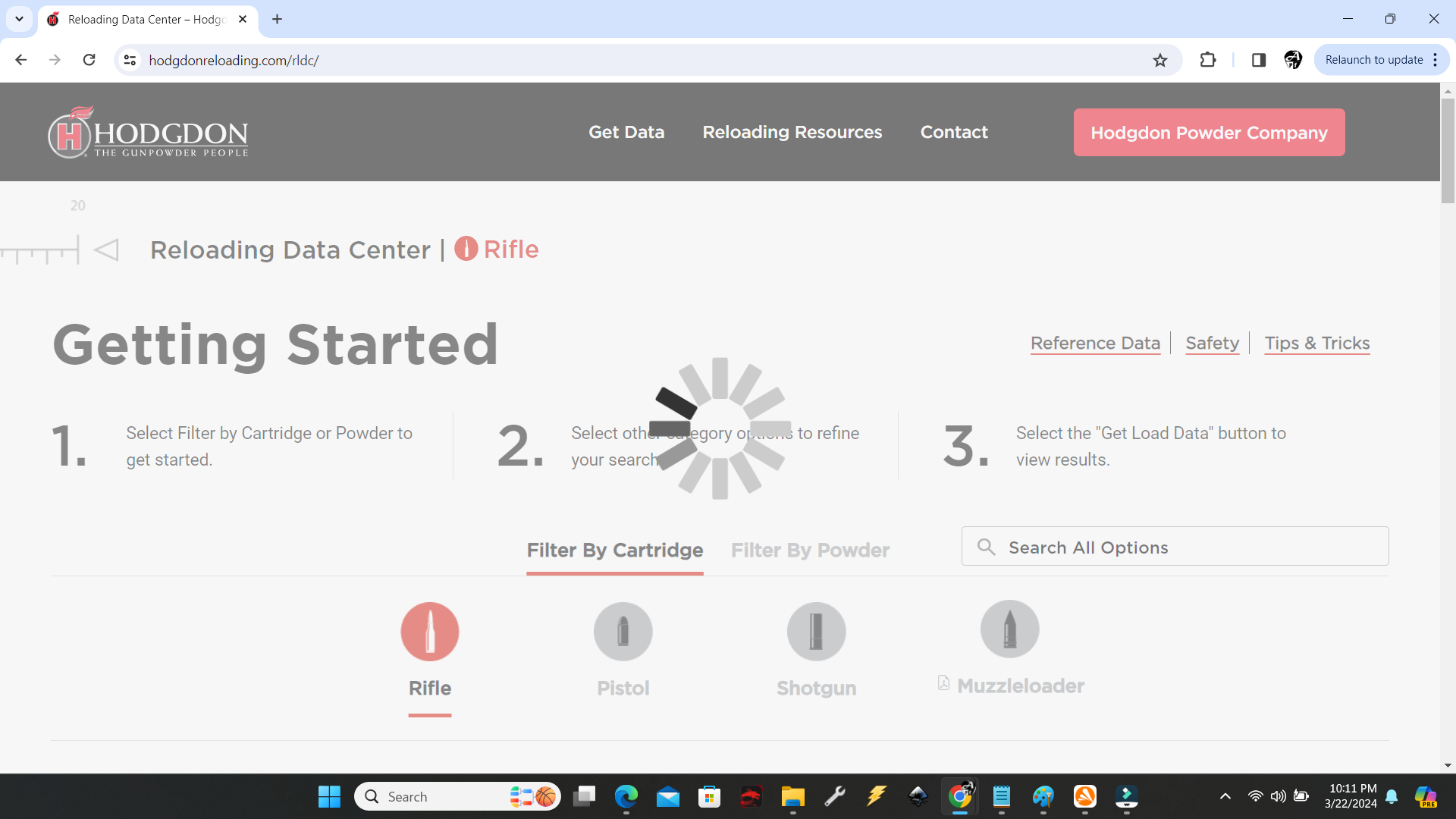

So I went to Hodgdon's site......for an hour it's has been loading the page (refreshed a bunch or times).

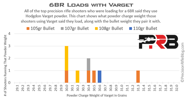

Not sure what powder your using but around 30.0 of Varget for 105’s to 107’s is the easy ticket. May need to play with seating depth but should work well for you
I have read that. but would prefer to have a min charge and do a ladder for accuracy. I feel like I will miss nodes and waste time chasing with out a ladder test. I could do it in ten-twenty rounds.

I have yet to find even a single instance of load data online anywhere for 6BR w/ varget with berger 105s.
Yes there are other people's recipe. But as I have stated that is not load data. you can take chances. I won't.

And I have seen that page on accurate shooter, but it only lists the load that person found they like.
I was trying to find min and max.

Hodgdon's data section of their site still appears to be down.
