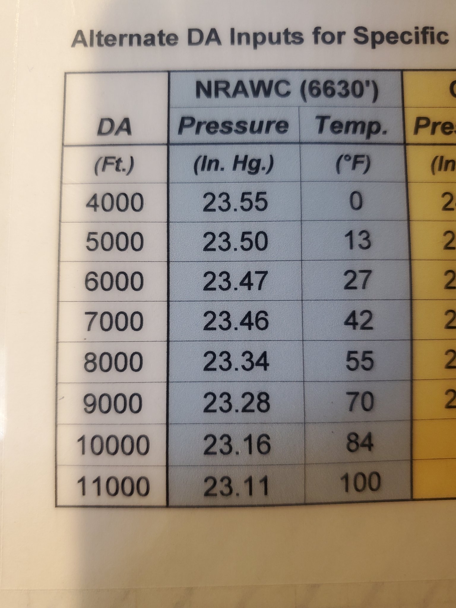

    With a little thought and effort it's possible to select air temperature bands that double as rough and ready elevation bands. Referencing the attached image, as we move left one column in the drops we get the same basic effect as reducing the elevation by ~1000ft and if we move right by 1 column then it's the same as moving up ~1000ft. When I say "the same" this is not to be taken as being a precise to X number of decimals. It's an approximation true but it's an approximation which is precise enough while still being easy to use under time pressure. So far this temperature banding set has allowed me to use a single DOPE card while changing elevation from sea level to 6000ft elevation. This system is, of course, not infinitely extensible but it's functional for a surprisingly wide range of temp/elevation/pressure conditions. If it's raining then and the DOPE is for fair skies just drift 1 column further right.
    An example usage: All of the data is indexed on 1000' elevation and I climb up to 4000ft and find myself in a place that's rocking a 60F temperature and I've got a target at 900yrds. Find the dope for 900yrds @60F (7.9mils), move right 3 columns and use that number (7.5 mils). Any fool can estimate with reasonable accuracy what the air temperature is and any fool can know to within ~1000ft what their elevation is by knowing where they are going ahead of time and looking at the range of elevations available in the area so it's possible, even with mathematics skills limited to what a 7yo child with a learning disability can do, cover a wildly variable set of conditions and locations with only a single dope card. DA is handy as heck, when I'm contemplating landing in the very near future. Otherwise, I don't find it to be so.
    Reactions: LastShot300
    For my hasty field cards I use a variation of this. Basically I get the pressure from my kestrel. I have cards for every .50” Hg from 0-100 degrees. I just find the pressure chart closest to actual pressure and then find the temp column. Gives me the DA and my drops. Humidity is assumed to be 50% always. This method adjusts my MV for the temp differences at the given DA.
    the tables were inspired by your OG spreadsheets.
    While I personally think of .5inHg might be a little more granular than necessary, nobody ever died from having too good of information. Also...
    Yes you could easily do it every 1” but I have macros and v lookups and pivot tables in excel that auto creates the tables from a raw data import so I can literally do 20 spreadsheets for a gun from 31.92-20.92 in about 20 minutes.
    then as I actually shoot in those conditions i can easily go back and manually enter true dope and refine the tables.
