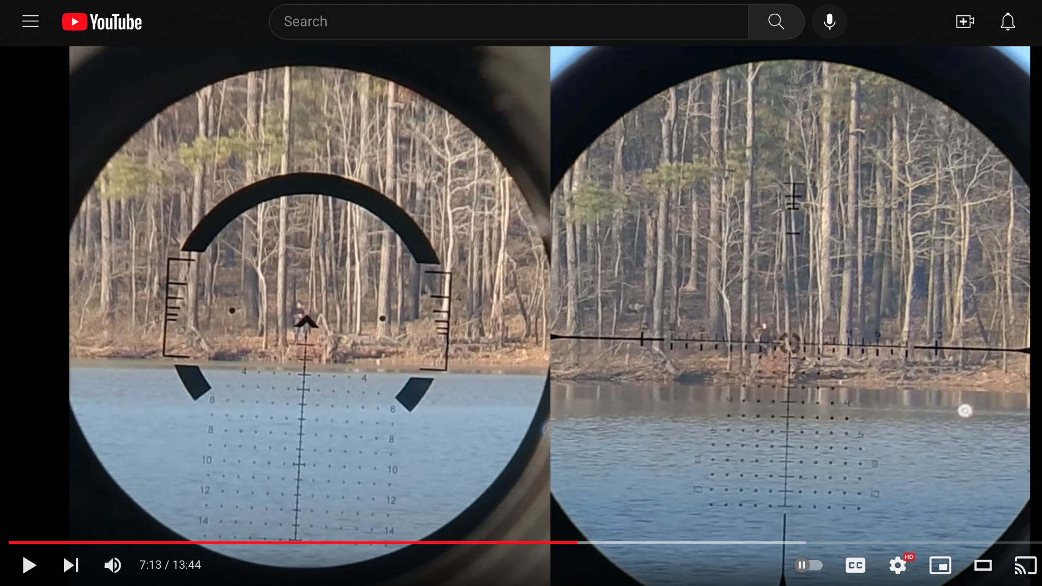

I'm not sure we're watching the same video. At max rez available to me (1080p) I cannot see any real difference in target ID (or much else) the two scopes when he looks across the lake.Consider this comparison between a PA 2.5-10 and the Vortex 1-10. Surely having adjustable parallax had some part in the advantage the MPVO has over the LPVO at 600yds?
Looking at the vast majority of setups, many (including myself) have given to the offset mRDS despite 1x bottom ends. With this is the liberation from "true 1x" bottom ends. Admittedly I use the hell out of my 1.5-2.5x range between 25y-250y depending on target size...I don't believe anything under 2.5x bottom end IN CONJUNCTION with a well placed mRDS loses much, but gains so much more for the crowd that wants a more precisionish feature set.
Comparing scope image through a camera is far from ideal.I'm not sure we're watching the same video. At max rez available to me (1080p) I cannot see any real difference in target ID (or much else) the two scopes when he looks across the lake.
The kicker is when he adjusts the PA's parallax (at 3:10) from 50 to 600 he admits he can't see any difference at all.
This is also where he also says things that indicate he is gauging everything by the video shot through the scopes vs him looking through the scopes with his naked eye at the time of filming!
Holy moly!
Screen grab at 1080p above. We can't gauge much from pictures through scopes, man. Certainly not color.
With your naked eye, if the two scopes have equal quality, raw resolution comparo's will be thrown off by the PA's much larger front objective (24mm vs 44mm), not by parallax.
