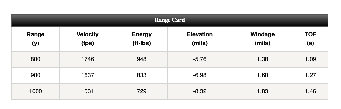

    I think I can probably live without it so long as the zeroing process doesnt eat a bunch of my mils. 6.5CM and I will def be shooting 1k with it but the m7x itself has tons of travel(26 mils). I'm sure even with something slower I'll be well under 15 mils of adjustment to get to 1k.
    Maybe thats the answer, most scopes with this large of objectives are also carrying so much elevation travel it's a non issue and I'm just paranoid.
    I guess if I was shooting further than 1k I might start to need to try worry more, but I don't really intend to be pressing that far.
