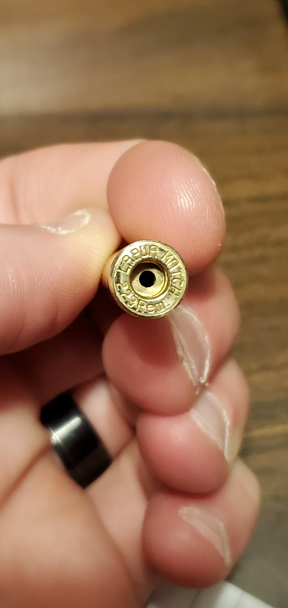

It's leaving a ring around the base of the case, it's gritty feeling when you chamber a round. I don't know how else to explain it. Other than it ain't right. That's all I know...

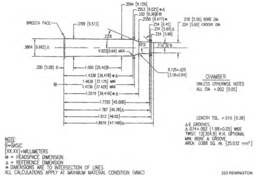

Yup short headspace will do that to you. Supposedly it’s shorter so the case doesn’t have to expand so much upon first firing causing thinning in the case head. theory is there is no need to fire form brass, virgin brass fits the chamber perfect.
Sounds like you need to take a few thousands off the base of the die or the shell holder. You can even try those Redding competition shell holders. The marks on the face of the base is from the bolt face rubbing against the base of the case when chambering or ejecting a fired case from the chamber.
Only thing I can come up with is he cut the chamber way to fucking tight or short...

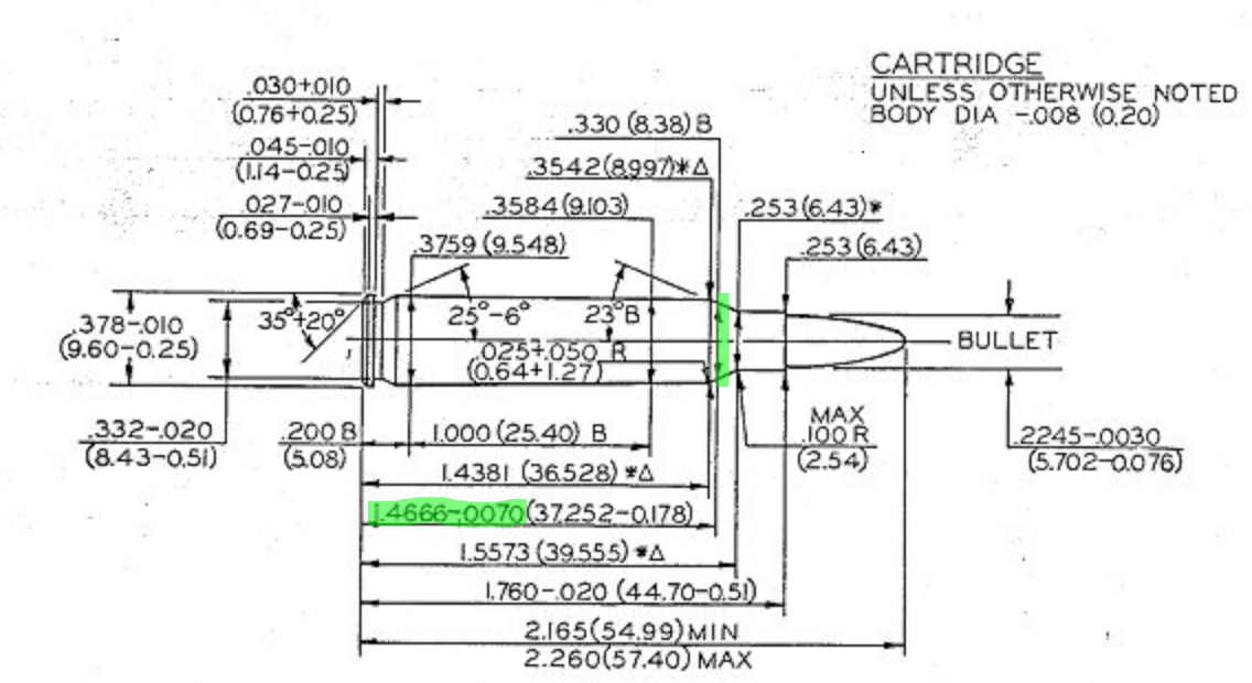

1.455" is a far cry from a min of 1.463"

Forget the SAAMI specs each go gauge is diff and each comparator is different so no numbers will be the same. That’s why SAAMI has a huge range in their numbers. Just use the fired Starline brass to determine headspace numbers. If bolt is slightly snug when chambering a fire case that is what you need to size your Lapua brass too.

It is actually possible for saami chambers to be minimum size and brass to be maximum size and the brass too large for chamber. However, just because its inside saami is no reason to not run the reamer back in and save you a ton of time.

So min spec chamber is what 1.460" essentially correct?
Mine is coming out to 1.455"
Lapua brass is coming out to 1.456"-1.458"
Starline is coming out to 1.455"-1.456"
He needs to cut it to at least 1.458" or 1.460" then correct?

What is the chamber minimum exactly? Is it 1.460" or 1.463" I keep seeing or hearing both listed...
I may just have him go 1.460" or 5 thou deeper just to be on the safe side of things.
My other main question is this though. How come the starline will size down to 1.454" after firing, but the virgin/fired lapua won't size down more than 1.456"? I don't understand that at all...
1.4666 -.007
Go download the specs from SAAMI. It's 223 Remington. Wylde is only the throat geometry.
Perfect, thank you guys. I'm just gonna have him do 1.460" then, that should be enough to chamber any lapua brass and other manufacturers brass while still being enough of a tight chamber. I don't know why the fuck he went 1.455"...

The chamber technically needs to chamber 1.460 brass, but the chamber itself would be slighlty above brass size... i believe was the point raised by post #47. If I'm readin the print correctly, the min-spec on the chamber calls for ±1.463 to 1.464 (more accurately, 1.4636 as published).
(@TheOfficeT-Rex please double check my logic).
