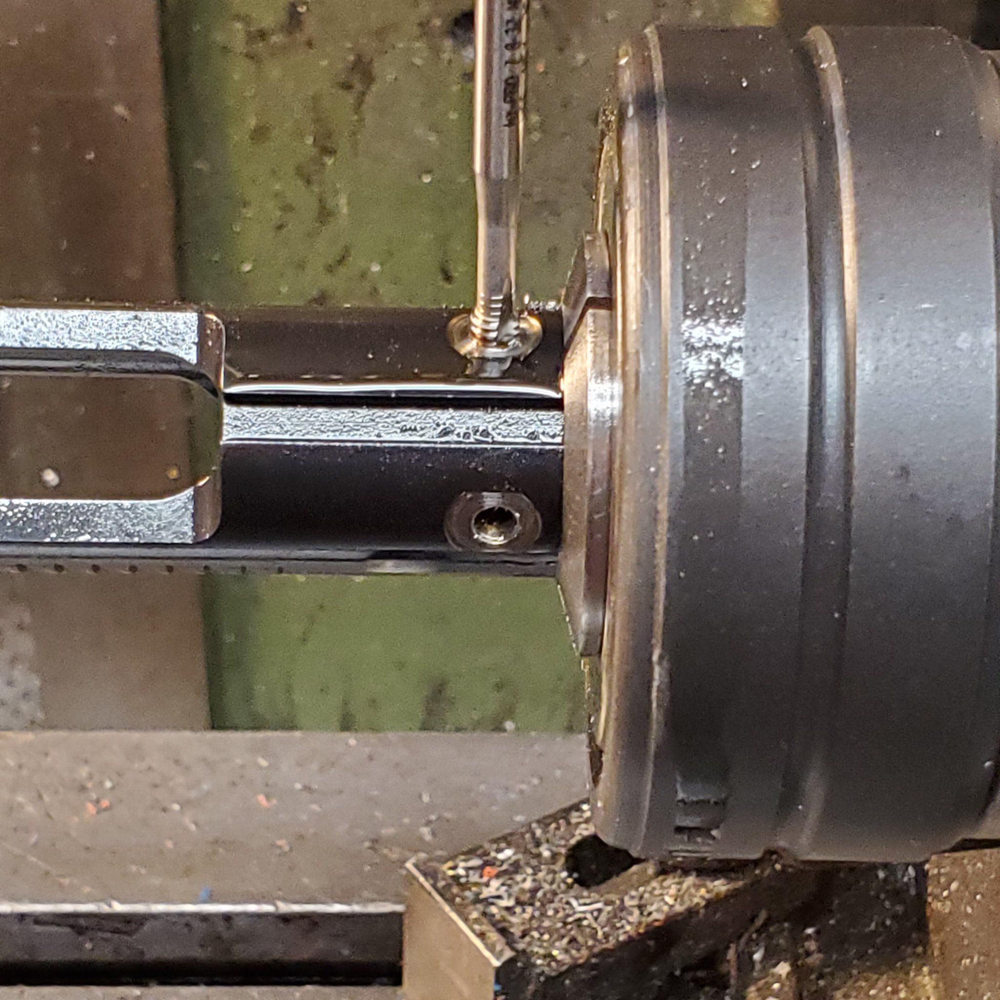

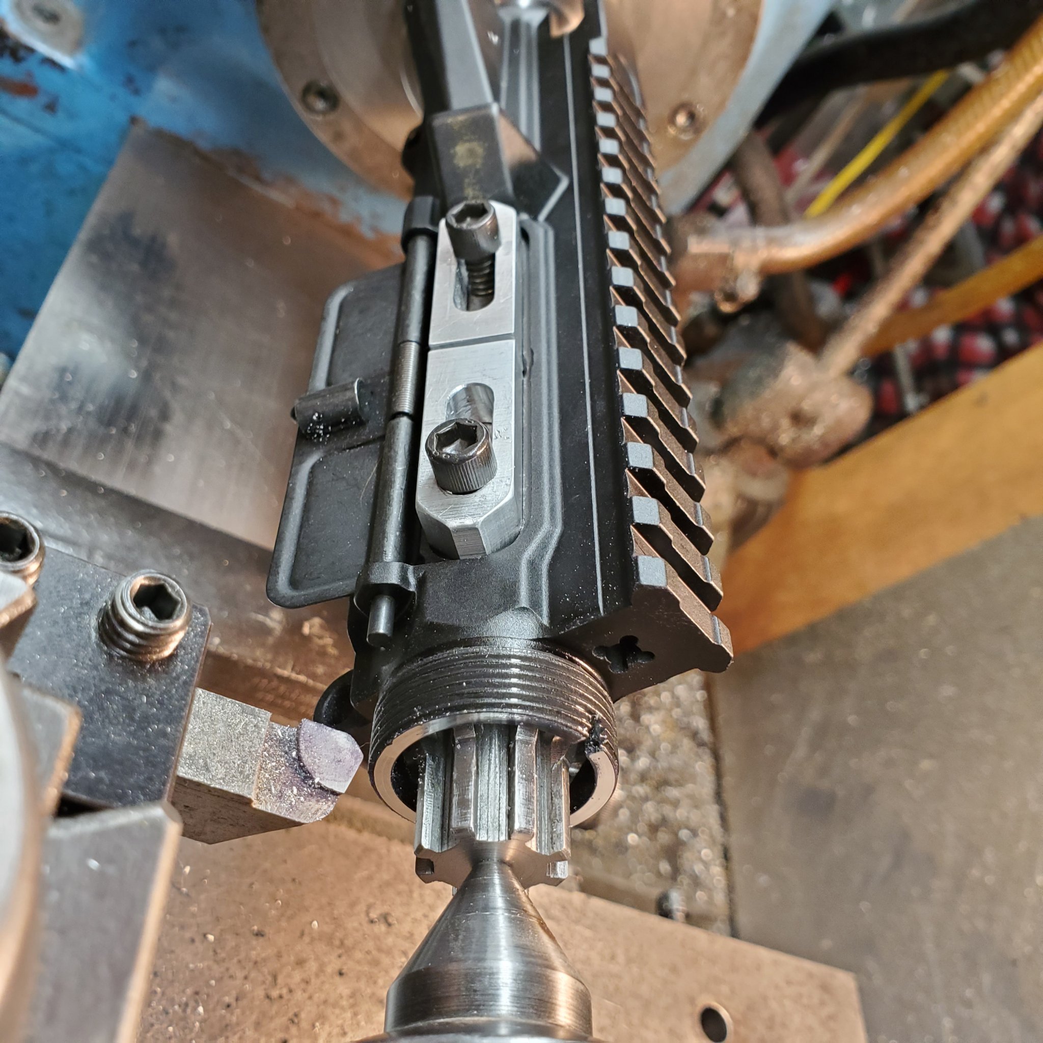

I had trouble with the 224 Valkyrie, so I dissassembled, went back and started over. Different, barrel 6.5 twist, checked out the, as offered, Areo Precision upper ...it needed attention. Center the bolt carrier group, made a huge difference with the 224 Valkyrie, more than any other caliber, also glue in with green bearing sleeve High Temperature loctite. Wax the reciever for easy disassembly. I know its easy for me to do, cause I have machine shop and machine tools, but every caliber bottle neck cartridge can be .5" shooter 5 shot grouper in the AR platform. But sometimes ya gotta do more than just assemble parts. Start with a quality barrel, usually expensive, build your own. That's how I do it.
Now the 224 Valkyrie shoots to my expectations.
