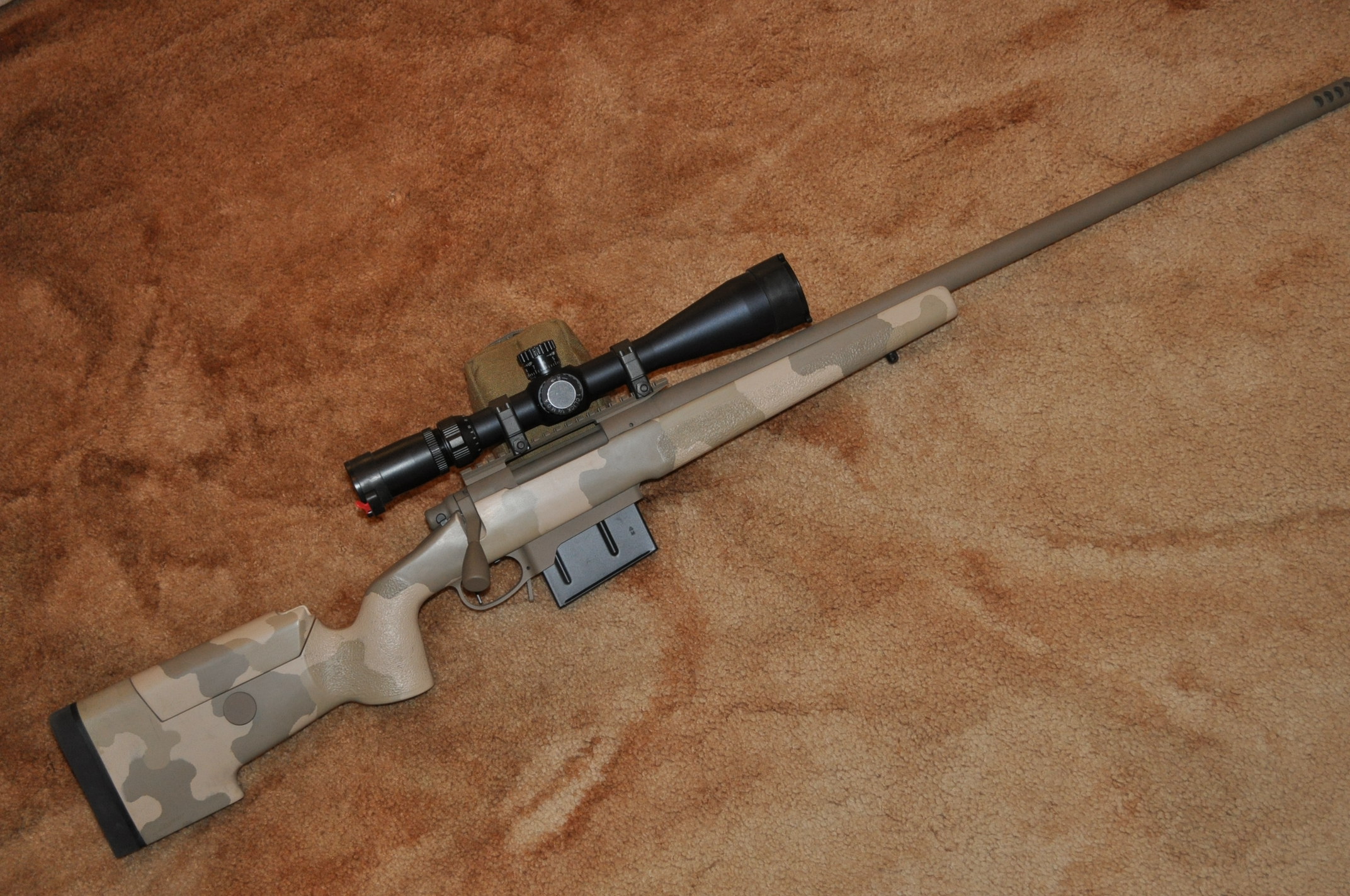

Who said the 30-06 has no place in this modern world? I beg to differ. I love the 30-06 so much I had the guys at Short Action Customs (SAC) create this masterpiece for me.

Specs:
BAT Tactical Long Action
Schneider Fluted Barrel, 1-10 Twist, MTU Contour, 30" Long.
APA Fat Bastard Brake
McMillan A5 Stock, Fully Adjustable. (McMillan "McCamo" Finish)
Surgeon DBM Bottom Metal
Timney Wide Shoe Trigger Set At 2 1/2 Lbs.
All Metal Is Cerakoted Desert Sage With OD Green Accents

30+" 30-06 with a break makes me scratch my head. What's the purpose of YOUR rifles? Heavy bench hunting?

Just for fun my friend. I have dedicated hunting rifles. I have lots of short and long range rigs. I have plenty of pistols and "CQB/ Battle carbines and rifles.
They all have a place. This 30-06 will be for prone shooting out to 1000 yards on steel targets, just for fun.

gonz'...that rifle with a good bullet will get you out to a mile with consistent accuracy.
I'm at 4000' ASL, and I take my 22.5" 30-06 to 1500+ yards with repeatable accuracy. I'm sending 208s at 2720 fps.
Your 30-06 will shoot like a 300 WinMag with a 26" bbl.

The 1st CF rifle I fired was Dad's old '03'A3 - not an ideal rifle for prairie dogs, but I wish I still had it. When I told him I was going into town to buy a new M70 in 243 Win, he told me to take the '06 along and trade it off, as "There's no reason to have more than one hi-power rifle on the place." That was in '68, and there's a darned sight more than one hi-power here in my office today.
Hadn't played with an '06 for a long, long time, and had only chambered three for customers in the 9yrs I've been doing custom barrel work. But about a month ago, after reading some posts on the '06, I got to looking around the shop, and realized I had all the parts to build myself a fairly nice rifle in .30-'06. So I trued a new M700 LA, chambered a Bartlein 5R 1-11tw sendero contour with a Serengeti reamer, bedded it in a desert camo McM A3-5 purchased off their inventory list, hung a straight shoe Timney trigger on it, along with a steel NF 20 MOA sloped base, and put my oldest Nikon 30mm 4-16x50 tactical scope on it with a set of steel TPS TRS rings, after CeraKoting the bbl'd action, base, & PTG Stealth DBM in FDE. And since I'm used to shooting 6 Dashers, 6 RATs, 6x47s, 6.5x47s, and 260 Imp 30*, I added a Harrell's Precision 4-port tactical brake. Wound up with a rifle weighing just over 13lbs.
I'm still waiting on some Berger 185 Hybrids & Juggernauts to arrive; since all I had in quantity were 155s & S175MKs, I've been shooting the 175s with Data 86, a surplus Czech single base extruded powder that was advertised as having a burn rate between 4350 & 4831. Have been mostly very pleased with the accuracy, but have yet to get any chrono data. Based on come-ups at 600 & 700, I'd guess my velocity is around 2750fps, which according to a couple of you guys should be a fairly mild load in the '06 case. Whatever - the rifle is fun to shoot, and I'm looking forward to getting more experience with it when the weather settles down a bit. We're getting gusts in excess of 45mph today - don't think I'd have much luck keeping the sky screens sitting upright.
DAMN! That's pretty awesome for some parts laying around the shop. I have a 308 that I built up some, but I have a special affinity for the 30-06. If you decide to kick that bucket of parts to the closet, I'm sure someone like myself would give it a good home...
