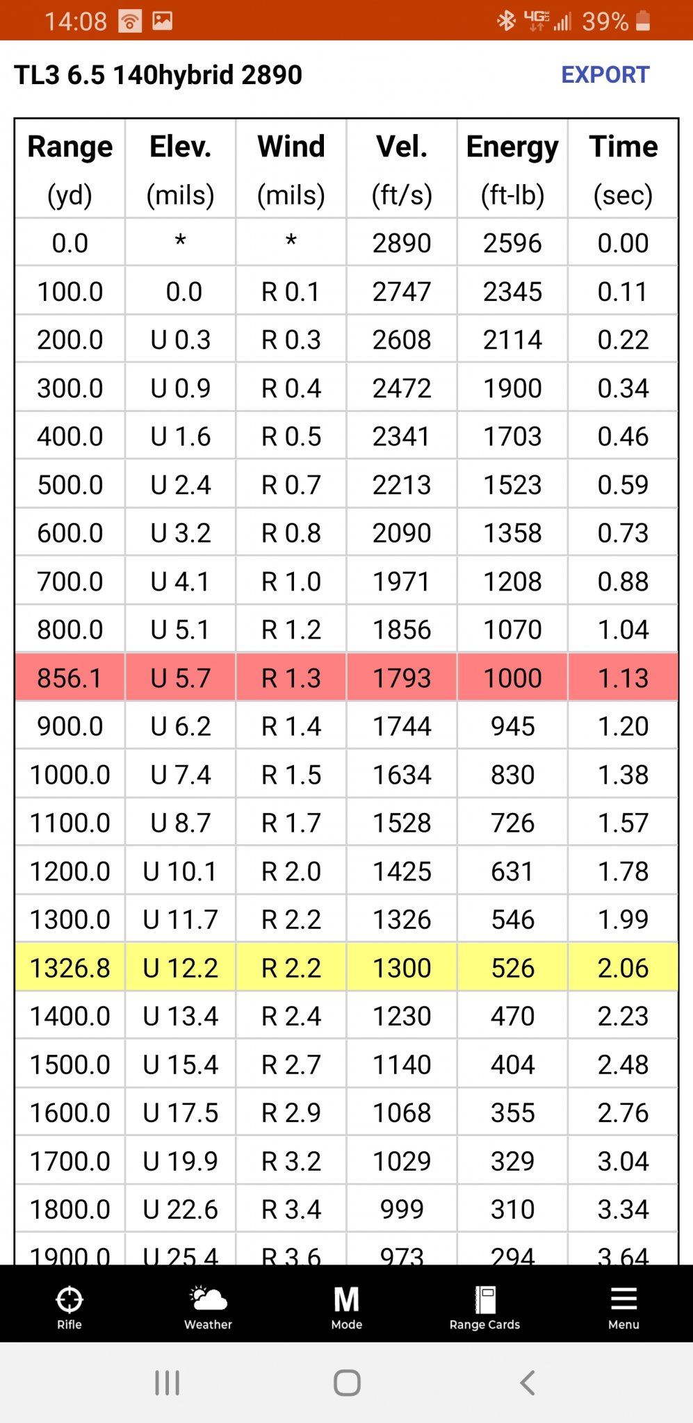

that's what i meant. comparing a 284 parent case versus a much smaller one
that's like saying a 22 creed smokes a 6ARC (6grendel). 22creed is bigger case and smaller bullet like the 6.5-284, versus the bigger 6mm ARC which has a much smaller case
look at a 162 at 2850-2900 which is possible with a short action 284, a 7SAW and a 7-08AI
10mph
2000DA

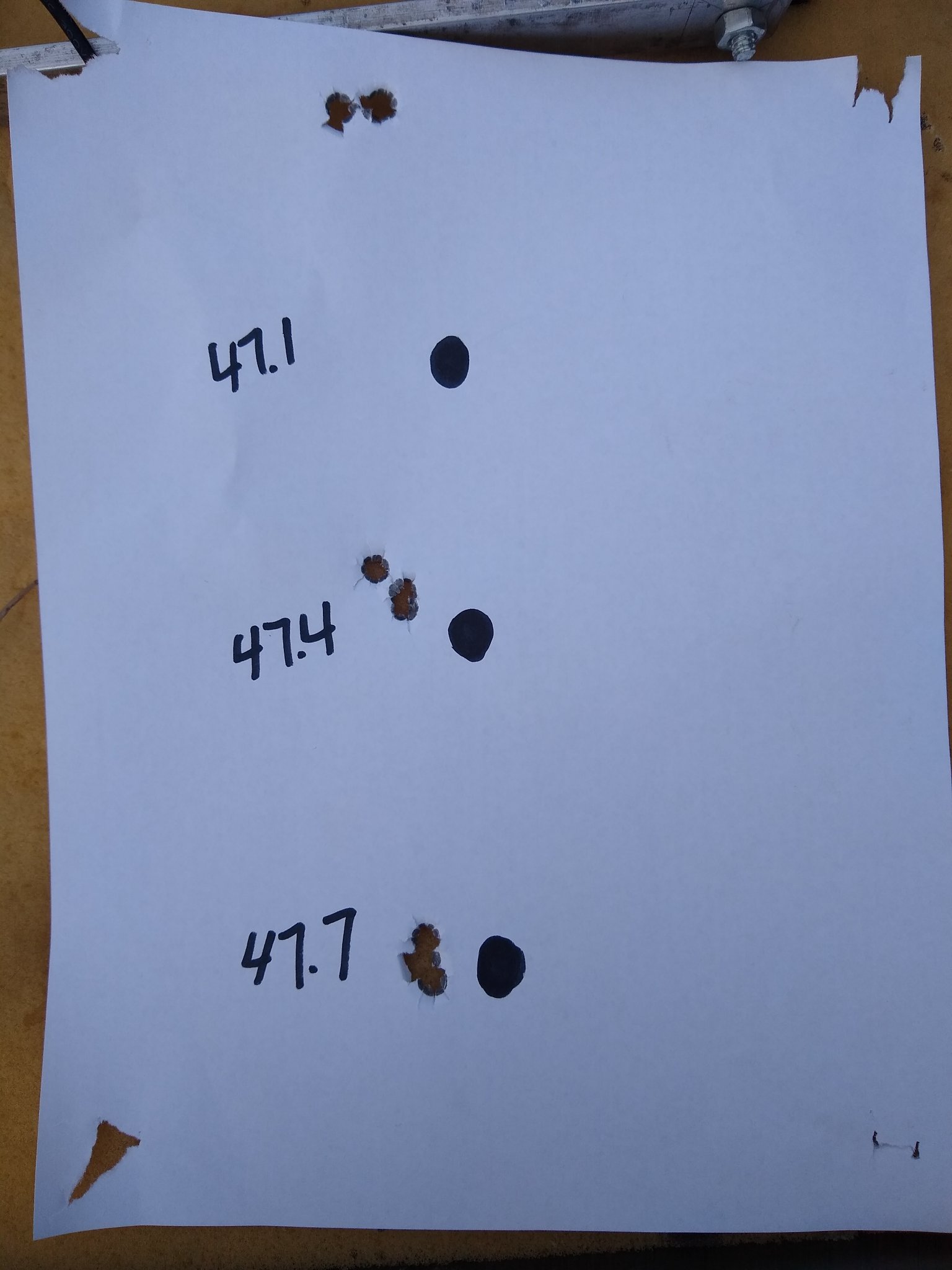

To the OP:
According to Quick Load 47.7gr H4350 is roughly 81,497 PSI in a 7-08 with 180gr Berger VLD loaded at 2.960 COAL. Do not try this. This guy is either full of shit or has a magic wand he waves before pulling the trigger on that load.
Well, I guess if you also have a magic wand to wave before risking your face and forearm, then go ahead.
Edit to add: It's also 115% of case fill.

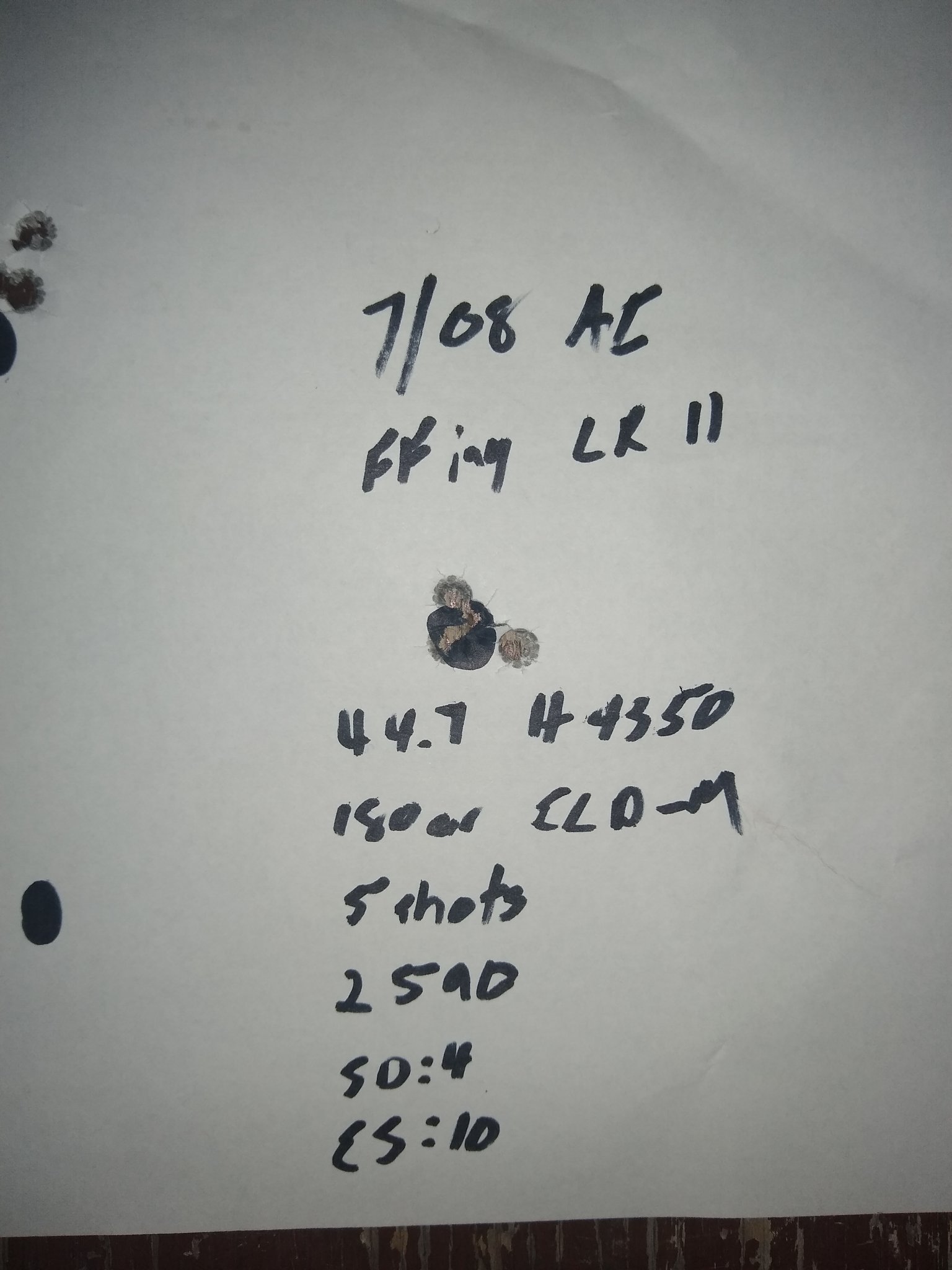

I should've said, this is for my 7/08 ackley. But here is the fireforming load. I didn't mean to mislead. Apologies.

25" McGowan 1/9 heavy varmint
Shot about 800 rounds with the standard 7/08 then reset as a 7/08 ackley.
Originally throated @ 2.960 with 180s eldm
Neck is .3185 allowing for sizing down lake city brass and still having clearance.
Edit- no clue what the freebore was, I can't remember, but I am jumping them a ways. Probably .070 when loaded at 2.96.
Barrel has 2.5 or 3k on it.
Xbr 8208 gets me 2800-2850 with 162s
I can check my load data but I was getting 2700-2770 with sierra 175s and various powders.
180s I tried with h4350 and that's it.
