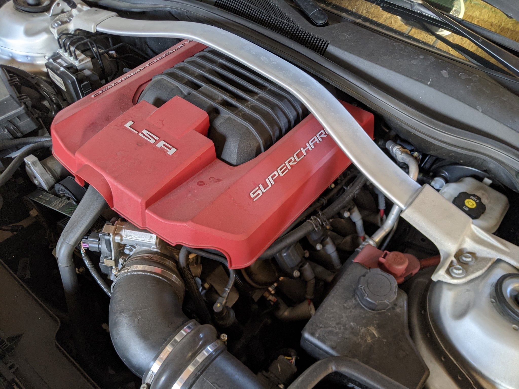

Boost. They used superchargers.
Yep. And then after WWII, all those aircraft engineers and mechanics brought their tradecraft to dirt tracks, drag strips, and (eventually) road courses around the country. Most every standard hot-rodding invention (and a few that are not so typical) can be traced back to their ingenuity - cylinder head porting, turbos, supercharging, nitrous oxide, water injection, and the importance of detonation-resistant (read: high octane) fuel. Not so glamorously but probably more important, there were also a number of innovations that improved the durability and efficiency of internal combustion engines for commercial transportation purposes.
50/50 meth/water is still a popular recipe today for squeezing that last lil' bit from a forced-induction engine. Once you've achieved blowtorch-like discharge temperatures from the charge cooling system by spinning a too-small blower too fast, a dose of windshield washer fluid keeps the intake temps under control and thus allows a bit more ignition timing advance and a bit less fuel, and thus MOAR POWWA!!!

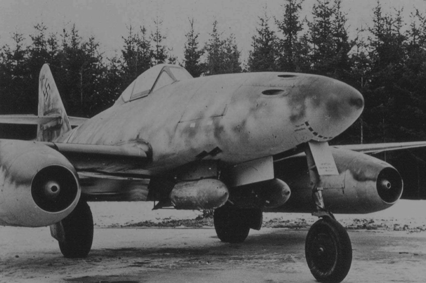

Nothing could match a Me262 jet in WW2.
The P51 had endurance like no other airplane thanx to its wing, also the me262 was a pig I helped a little reverse engineering them at pain field Everett, we borrowed an original one fro a navy base in Florida and took it apart, it’s downfall was that by the time the German engineer came up with the design they were out of aluminum so it was a heavy pig, and had no endurance.........

Collings Foundation has (had?) a flying Me262 and I was sitting on the ramp in Amarillo 7-8 years ago and it landed & taxied in...SUCH a distinctive sound...
Good thing the Germans designed an engine that had a lot of turbine lag and wasn't very reliable.
The ones built in Everett didn’t use the original engines they were way too inefficient they put another engine inside the original cowlings.....
Were you involved in the contract to build the 262 for various customers such as museums? I saw the last one being build some years ago. I think I saw one flying from my office window off Airport Road that same year (~2010?)
As far as I know they all went to South Africa, I just helped out, I actually was working for the university of Washington’s atmospheric aircraft flying over oilwell fires in the Middle East and such taking air samples, I was not a scientist I was just a lowely aircraft mechanic😀
Had they done it in 1942 instead of 1945 the war could have been a much different outcome. Thankfully we had pretty much decimated them when the 262 was ready. No gas and no parts.
