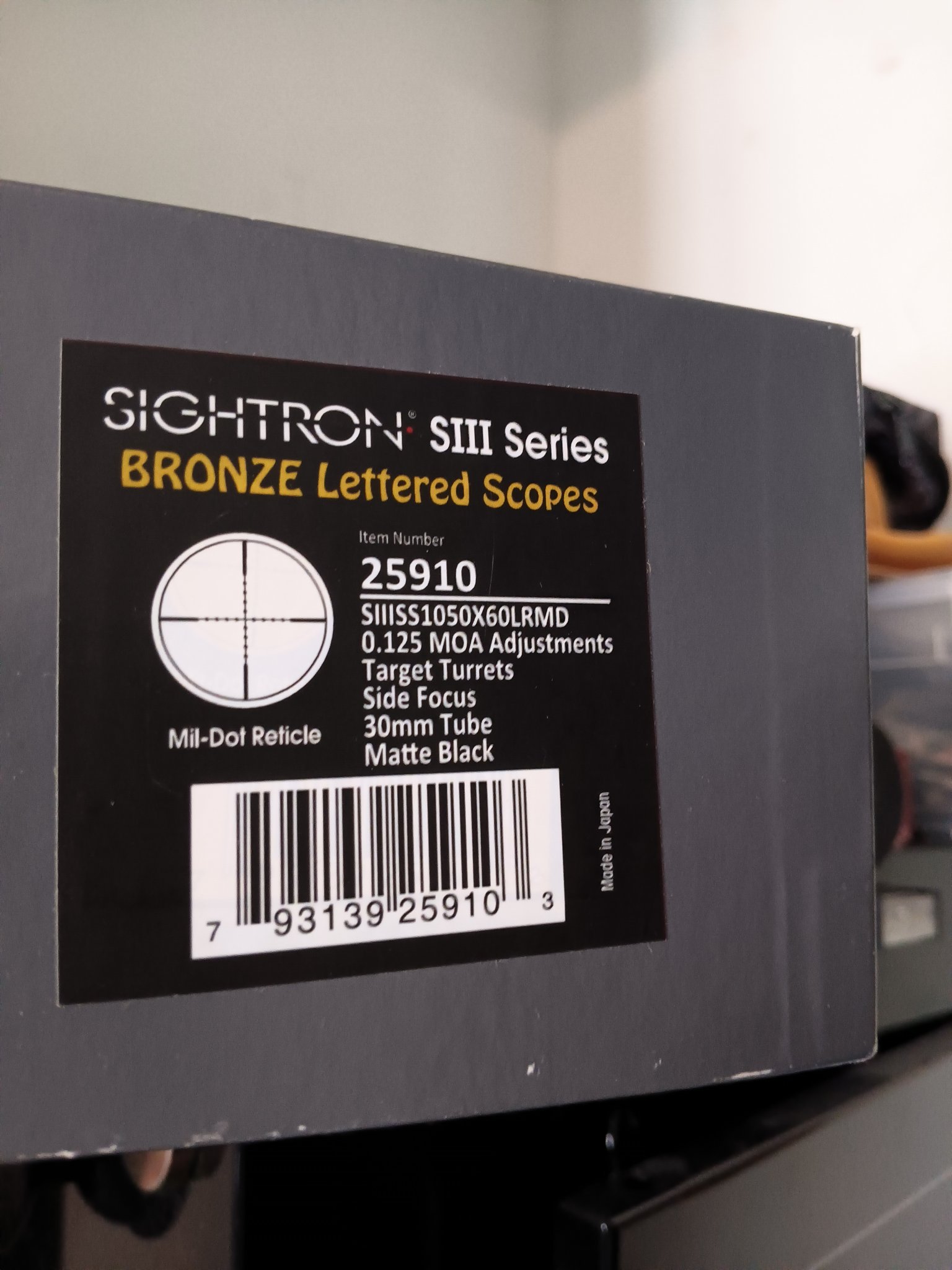

I recently received an older used Sightron SIII series scope. It has [per label] 0.125 MOA adjustments and is configured with a Mil-Dot Reticle. Since the manufacturer produced it this way, I assume there is some valid reason for this configuration.
  1. What is the reasoning for this type of thing?
  2. Are there any good references for getting the most out of this configuration?
Thoughts?

Because long ago, when the mil ret came out it was simple to reprogram to etch that ret, The erector had to be completely retooled, money & time. Some units are still that way. Some people who can't quickly operate in both still use those kinds of set ups as training aids.

Well, I never would have any of that. Sightron is willing to charge $175 to change the reticle to their MOA or fine cross hair reticle.
Is there any risk (aside from the cost) of having them perform that task. Is it something that Could impact its precision?

No worries with Sightron.
Get what makes you happy.
I still have and use a 3-12x42 mil dot with 1/4 moa capped turrets in SFP. Works great for hunting, as it gets dialed every few years when I put a new barrel on for sight in. Otherwise it's a 100% hold only on 12x.
That said, I'd never use that for a match with the great tech we have today.
I also have a .125moa dot reticle with .125moa target turrets. Works great for fixed distance indoor benchrest.

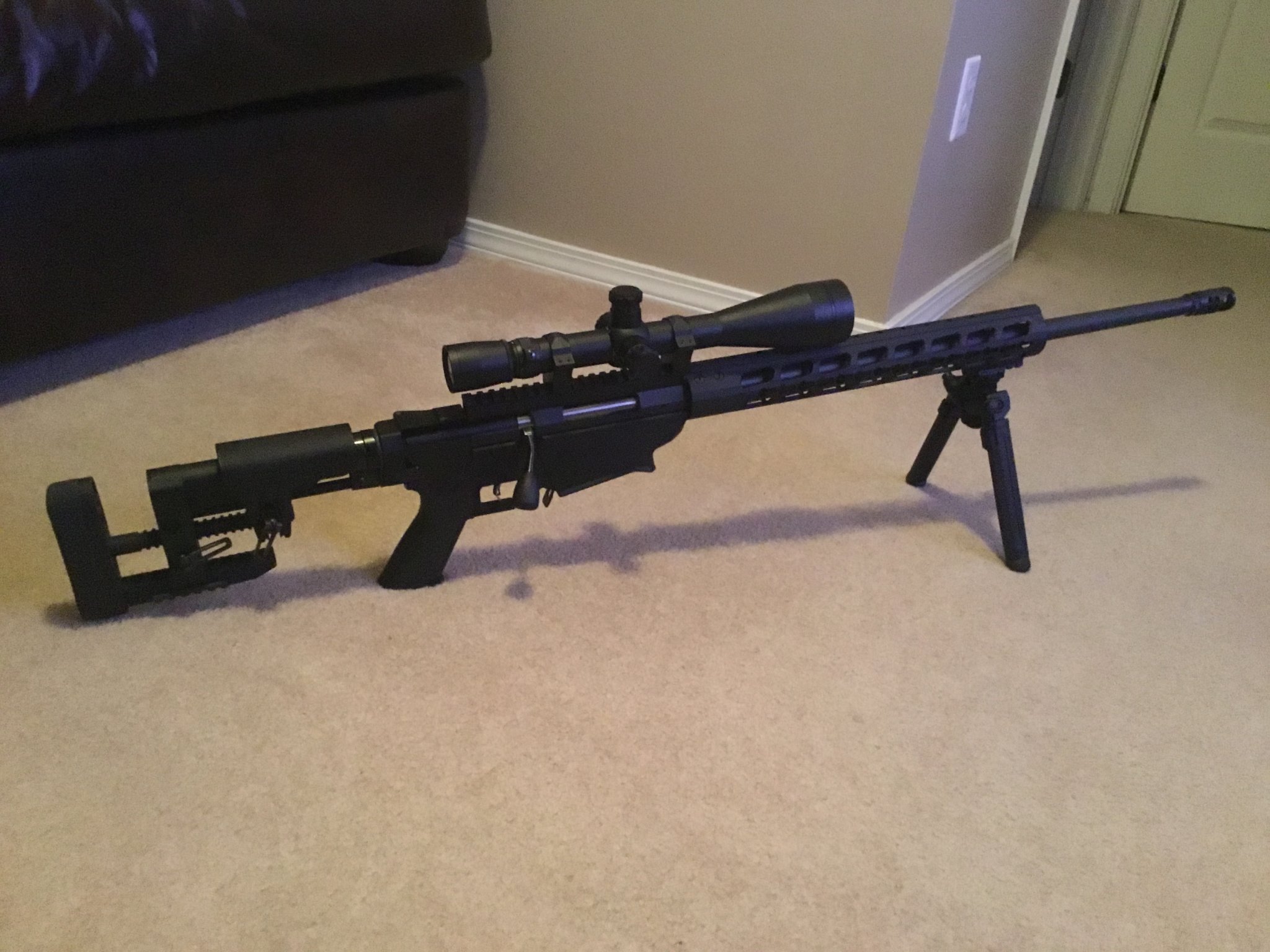

Our son loaned me a Leupold he purchased when he was still in college. had mil dot reticle and MOA turrets.
Put it on my RPR in 6.5 Creedmoor that I purchased in 2017. Got the thing worked out perfectly. Sighted in at 200 yards, the first mil dot was set for 300 yards. Perfect for Top Shot in Hodge, Louisiana which has a max range of 300 yards. For everywhere else, had 200 and 300 good to go, no sight changes necessary and everything else was MOA settings and the old scope always returned to zero. Crazy as heck, but I figured it out, worked like a charm and the old scope was built like a tank, never failed.

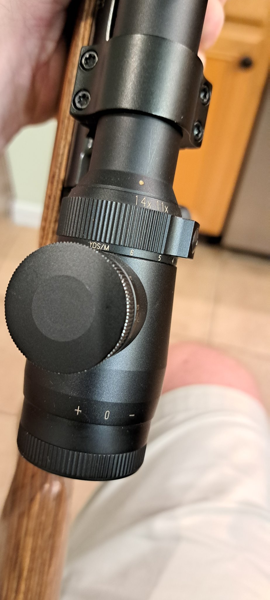

One thing people often overlook with "mixed" scopes.....they are mostly SFP.
So if having a mil reticle tweeks yer trousers too much. Just go ahead and back that magnification off just a scosh. Turn that 24X true mil subtended reticle into a 23.25X true MOA subtended reticle. Make every mil equal to 4 MOA instead of 3.438 MOA. Now if have the have half mil hashmark on your reticle layout....you got 2 and 4 MOA tickmarks.

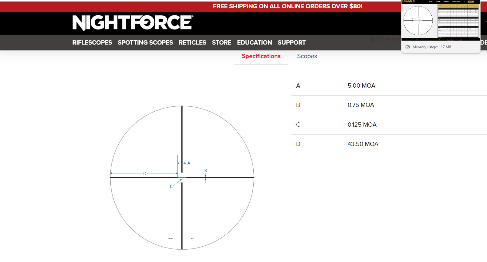

Interesting, all of the versions I'm able to find of the T6 AO are either a fine hair, a center dot, or a plex. Pretty cool if they had an actual MOA-based drop/ranging reticle in a scope like that. Would love to see what it looked like. All of the older drop reticles that I'm familiar with are along the lines of either a mil-dot, a windage-ticked cross hair with a "ranging field", the TDS reticles, and some cartridge specific ranging/BDC reticles.
You're right. This is a ranging reticle.
Correct. If the user knows the manufacture specs for that version, it certainly is.
If you are just going to pull images from the web, why didn't you pull something like this one:
There is a LOT of similar resources available. If the user is actually experienced with this type reticle, they can easily split some sections down even further. For example one half of A is easily discerned for a 2.5 MOA element.
