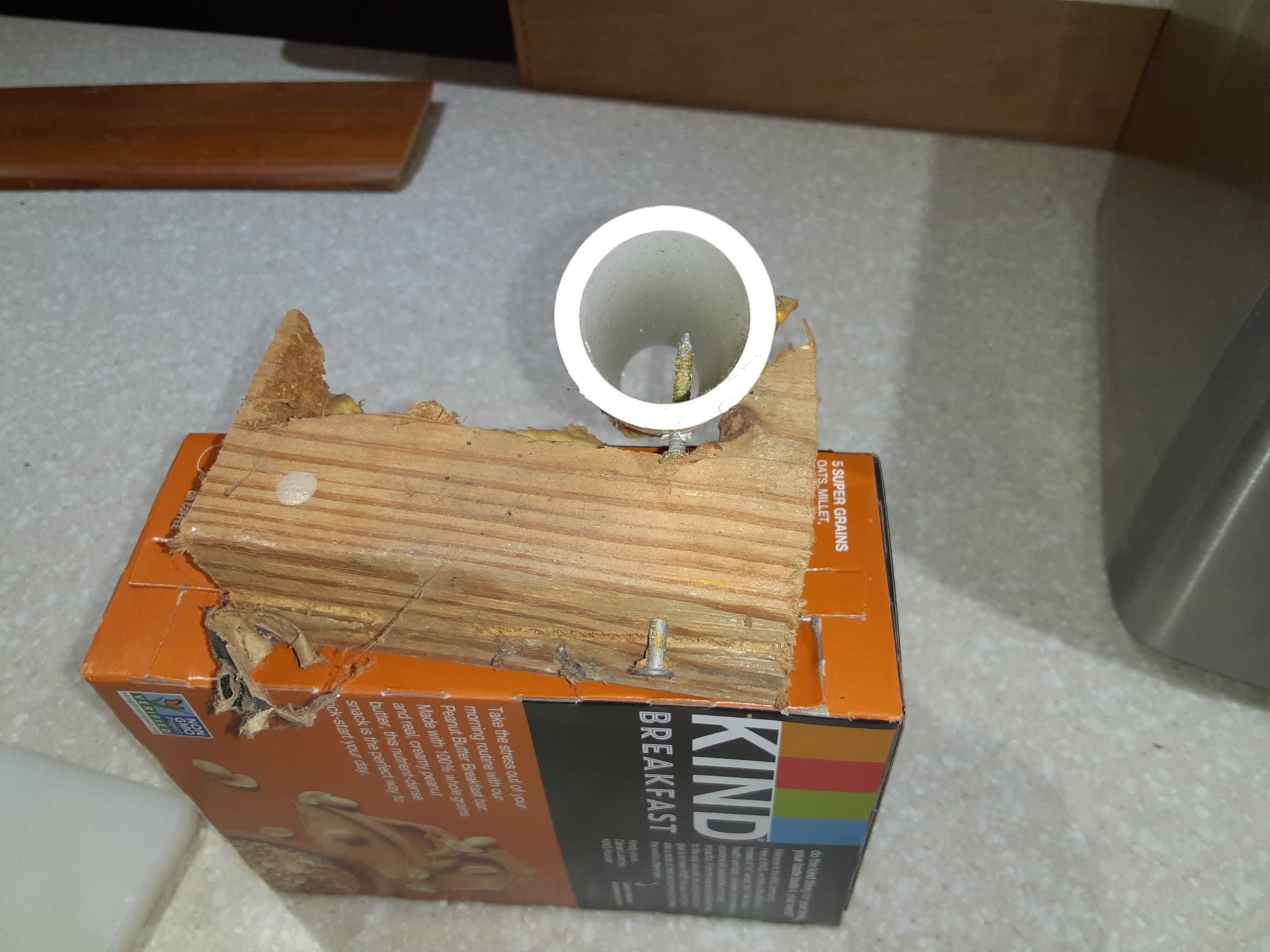

We need a dumbass construction sticky- post stupid stuff you’ve seen on site. It’d be legendary.
Found this on my house build 15 yrs ago. 3/4 pvc
Reactions: JJMoody and KZP
I found the exact same situation in a house belonging to a customer. He had squishy squish sounds under his kitchen hardwood. Turns out an installer had failed to use clips on the Pex and it was resting against the drywall. A drywall screw missed the stud and went right into the line.
It took 4 years to rust out and leak.
Not doing shoddy work makes everyone’s life better down the road.
On Pex, it is proven.
