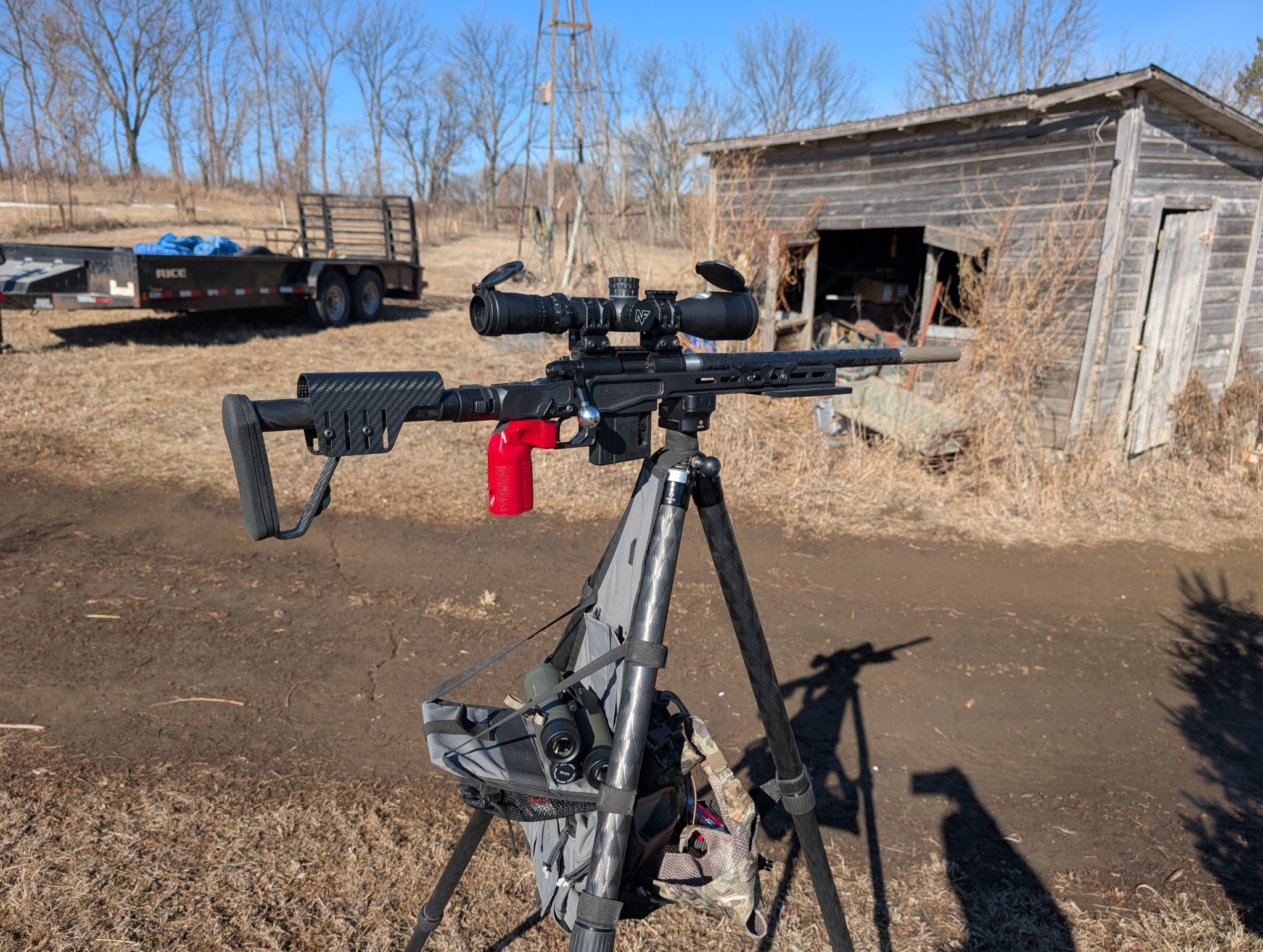

I had my gunsmith convert over my 18" Rimx proof research carbon barrel to my vudoo action. Funny enough, after coming the breech, it fits and shoots equally on all 3 of my vudoo actions I currently have. It's been cut with the good ol 52D reamer and was a test to see if the 52 chamber makes this decent shooting barrel shoot even better (was a solid performer already but does shoot noticably better now with same ammo). I also knew that the harmonic temperament is different between carbon fiber and stainless steel. I was able to " tune" my JK Armament suppressor by adding baffles and shooting it till it hit a sweet spot. I was knocking over sparrows (7 for 10) at distances of 90-115yds with ok ammo, not Tenex or Centerfire X lol.
This was theory and I wasn't willing to lose that much money by selling it at a loss so I got it to a vudoo and I'm pleased that it works. Benchrest season is coming and to make under the weight cap and play in Custom Class at our club of 10.5 lbs I hope to run this as a full benchrest rig
