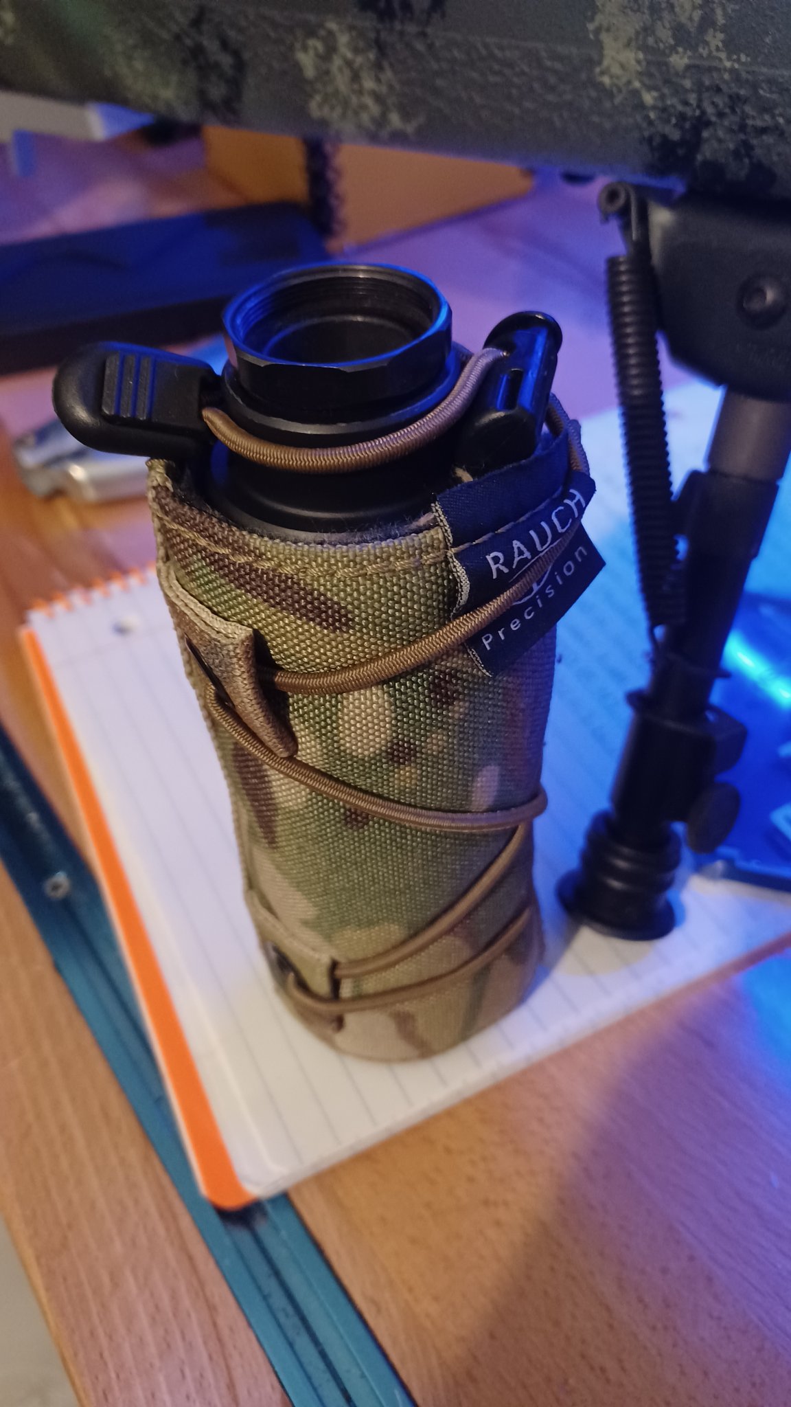

    First I’ll say that I have not tried every can cover out there or even close. But I do use amageddon gear suppressor covers and have had zero issues with it sliding forward, yet I can easily slide it backwards onto the barrel to cool off the can.
    I have one that I bought back in 2015-16 that’s still in use today. Matches and everything. I only use them on bolts and not semis.
    The precision underground one is built the same way and I would use them too with no problem.

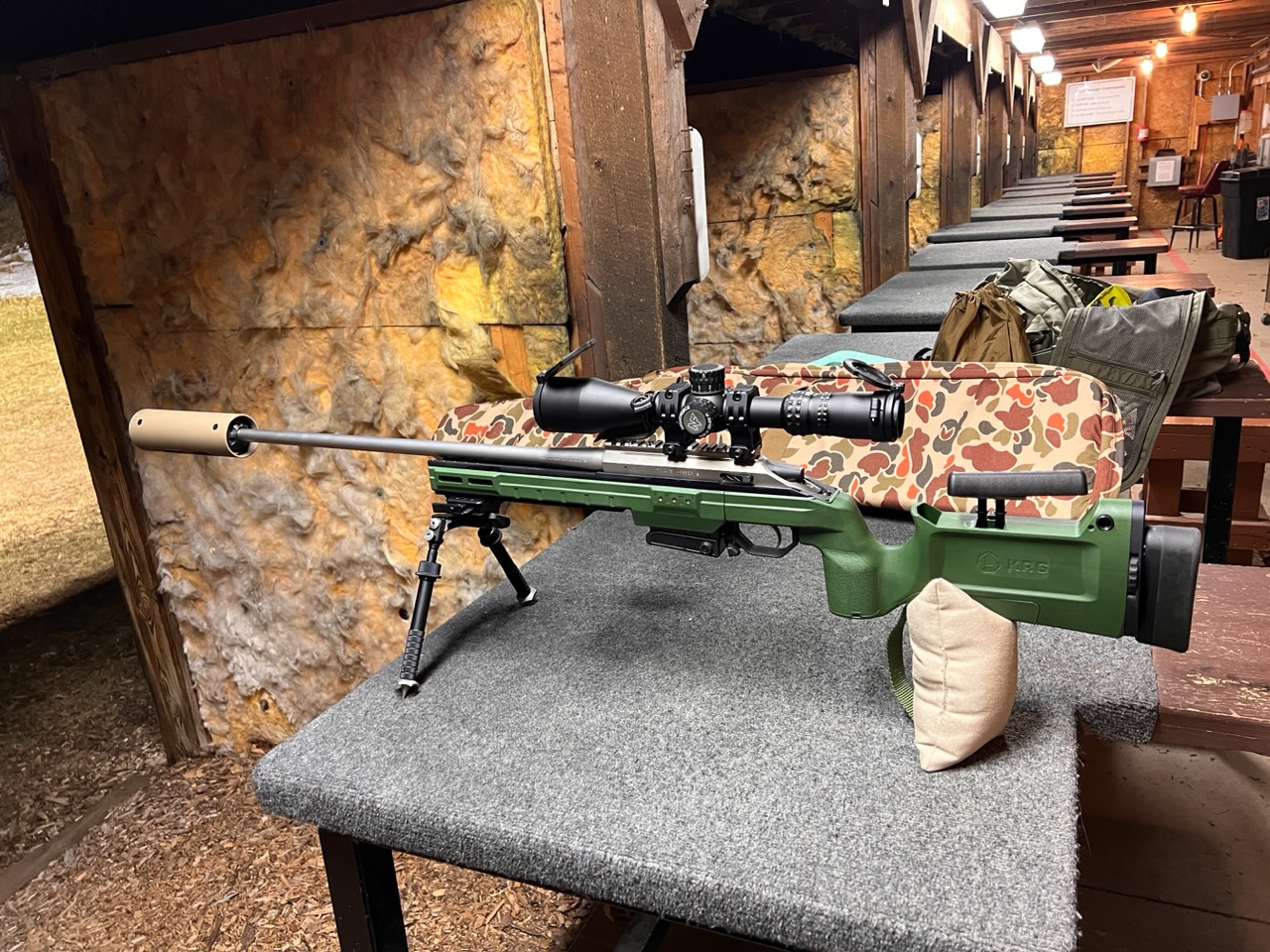

    I am digging that range! Where that be?

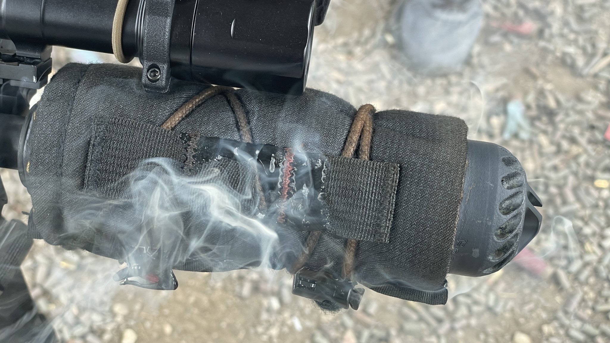

    Agreed. I recently fried one well under their firing schedule which the print out and include with the suppressor. That same verbiage is not on their site. Still, mine pretty much melted and sent up giant smoke signals with less than 120 rounds. I emailed Armageddon twice and never got a response. From my experience, they don't stand behind their product. Not only did the nylon portions turn to liquid glue and give me cancer, the entire cover is crispy. the cover itself doesn't look that bad in the photo below but the inside is like rice paper.
