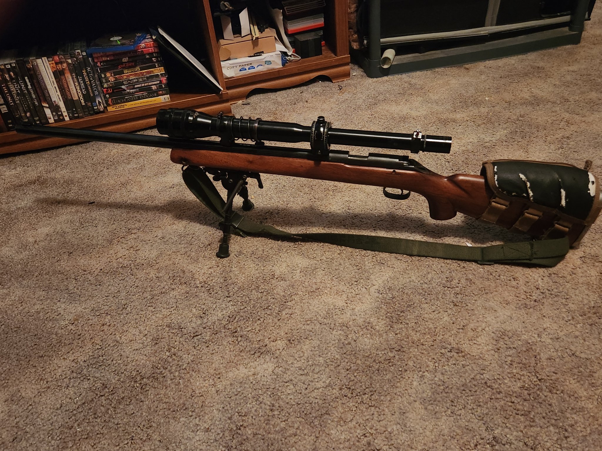

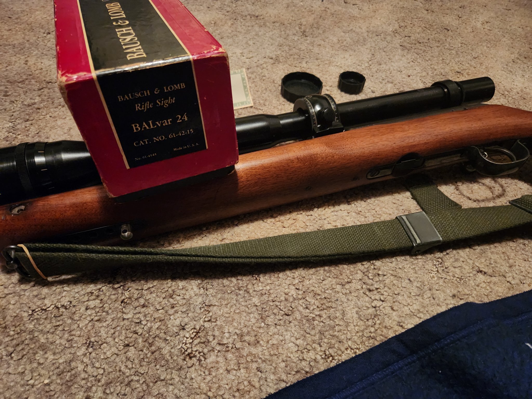

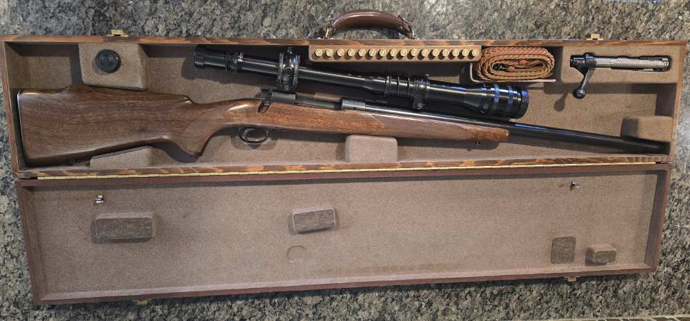

    Well I finally picked up a scope I've been trying to get for 4 years now. Gun Show had a few gems to be had. This Bausch & Lomb 6-24x50 with the externally adjusted erector and the adjustment "knobs" around the maintube just looks killer. Has a tapering fine crosshair.
    I passed this scope up last year at the same location and forgot about it as we rushed to beat a incoming blizzard. But I got her now. Hopefully it's not a turd. The box was a nice extra.

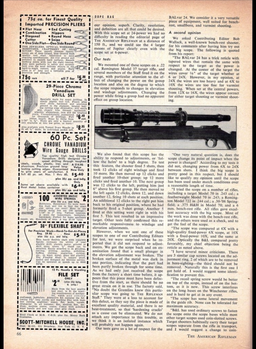

    Well been doing some research that some may enjoy. Searching around I found the operators manual and a 1956 American Rifleman article on this scope and some ads. I'll post screenshots cuz I'm good like that. Getting this info spread around guarantees we don't lose it.

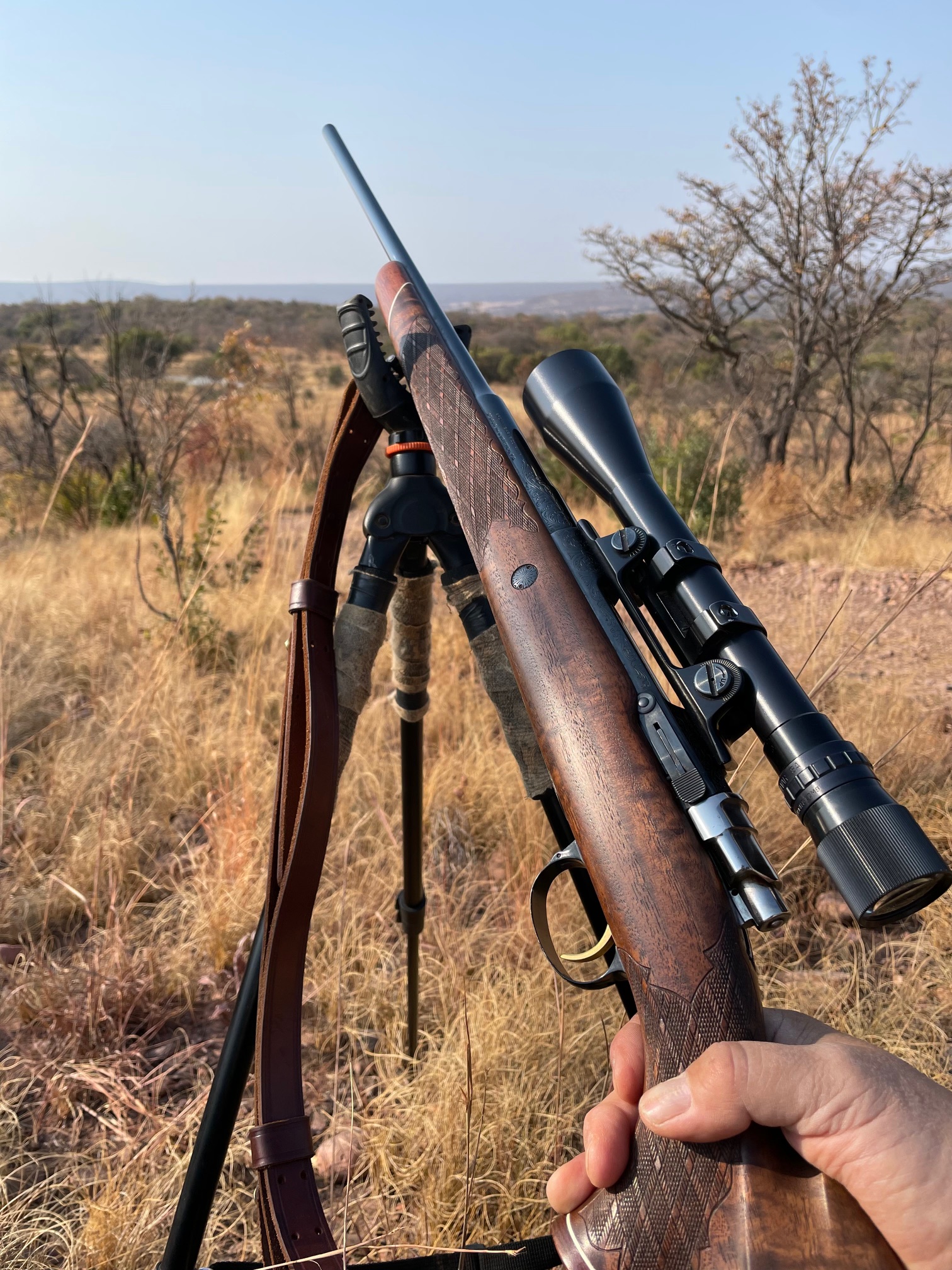

    DFOOSKING - Great find brother! The Balvar is not a turd. It is a relic from days gone by and a very fine optic. I have two of them. One is mounted on one of my fine Winchester 52's. I often compete in 22 BR matches using a 52 wearing either a 20x Unertl or the 6-24x Balvar. When I first got my Balvar, I mounted it on the rifle and bore sighted it off sandbags on my back porch. I had placed a empty soup can at 50y to aim at and was stunned when I found that I could read the fine print on the label from 50y.
    The Balvar is one of the clearest scopes ever. A little bit of Trivia: In the 50's and 60's, Bausch & Lomb was hired to make the large camera lenses for the super powered aerial spy cameras used first on the U2 and then the SR71 spy planes. They had access to a rare deposit of nearly pure quartz sand that was used to make glass of exceptional optical clarity. From time to time one of those bigass lenses had a flaw in it and rather than scrap them, they cut them up to make rifle scopes, namely the Balvar product line. It is like using a scope that was built using recovered alien technology. It was also one of the most expensive scopes in the world at that time. At $240 ea in 1956, for the price of one Balvar you could buy nearly three of the top of the line premier Winchester Model 52's which were selling for $88.50 in 1956. Yes, it is impractical and clunky for use in the field but for target work at one distance like 50y, it is as good as they get.
    In the 60's B&L also made a slightly more modern 2.5-8x Bavar variable hunting scope. You could buy three pre-64 Model 70's for the price of one. I mounted one of those onto my 1963 vintage FN Browning Mauser style 308 and took it on Safari in Africa last year and it performed flawlessly. Made five one-shot kills with it on that trip. By the end of the hunt, my African PH and his lead tracker were both in love with it. The clarity of that scope is every bit on par with a Swarovski. Bought it for $60 on Ebay, lol.

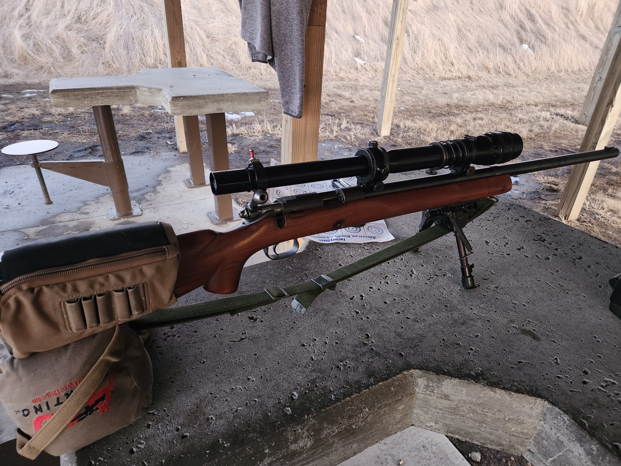

    Pics below: 1.) FN Browning 308 with Balvar 2.5-8x. 2.) Winchester 52B Named "Pretty Gurl" wearing Balvar 6-24x
    View attachment 8584858View attachment 8584859

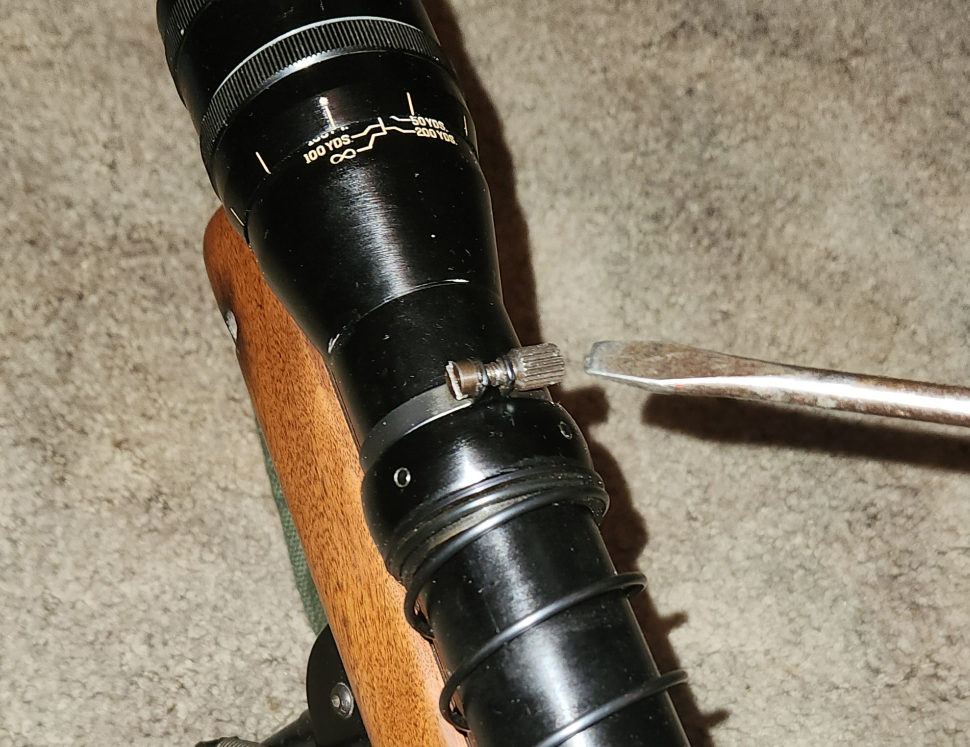

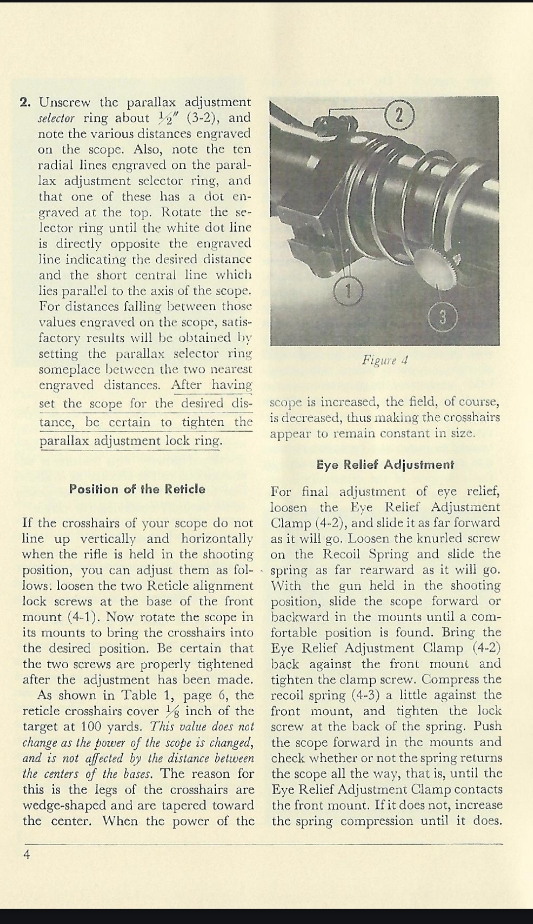

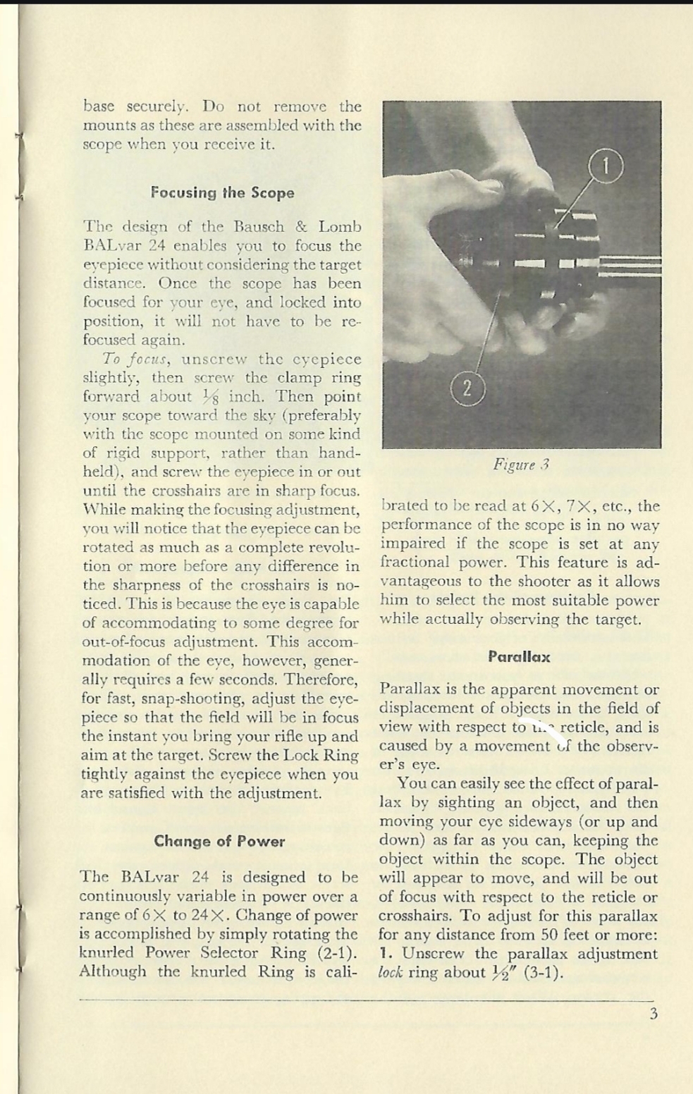

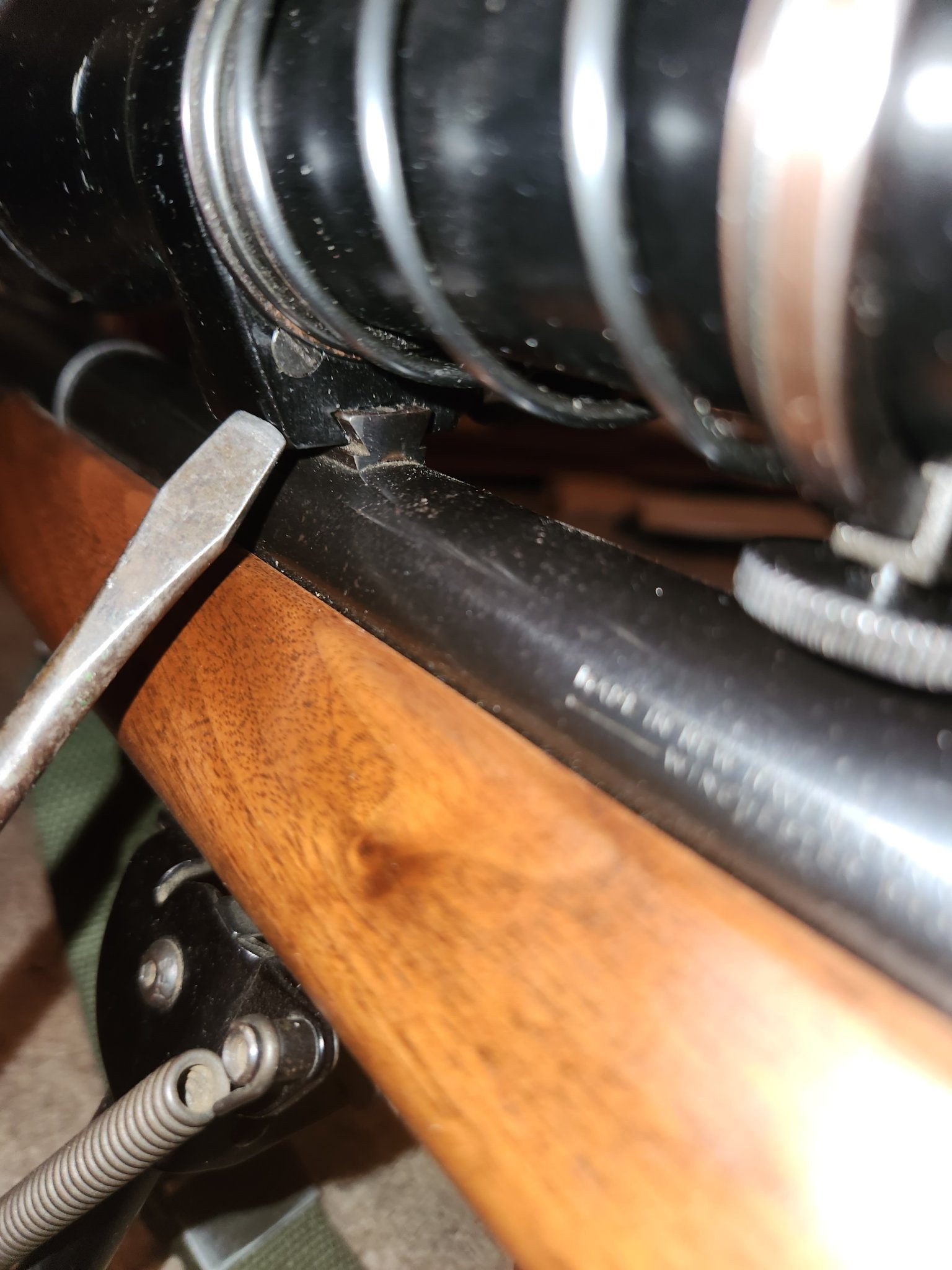

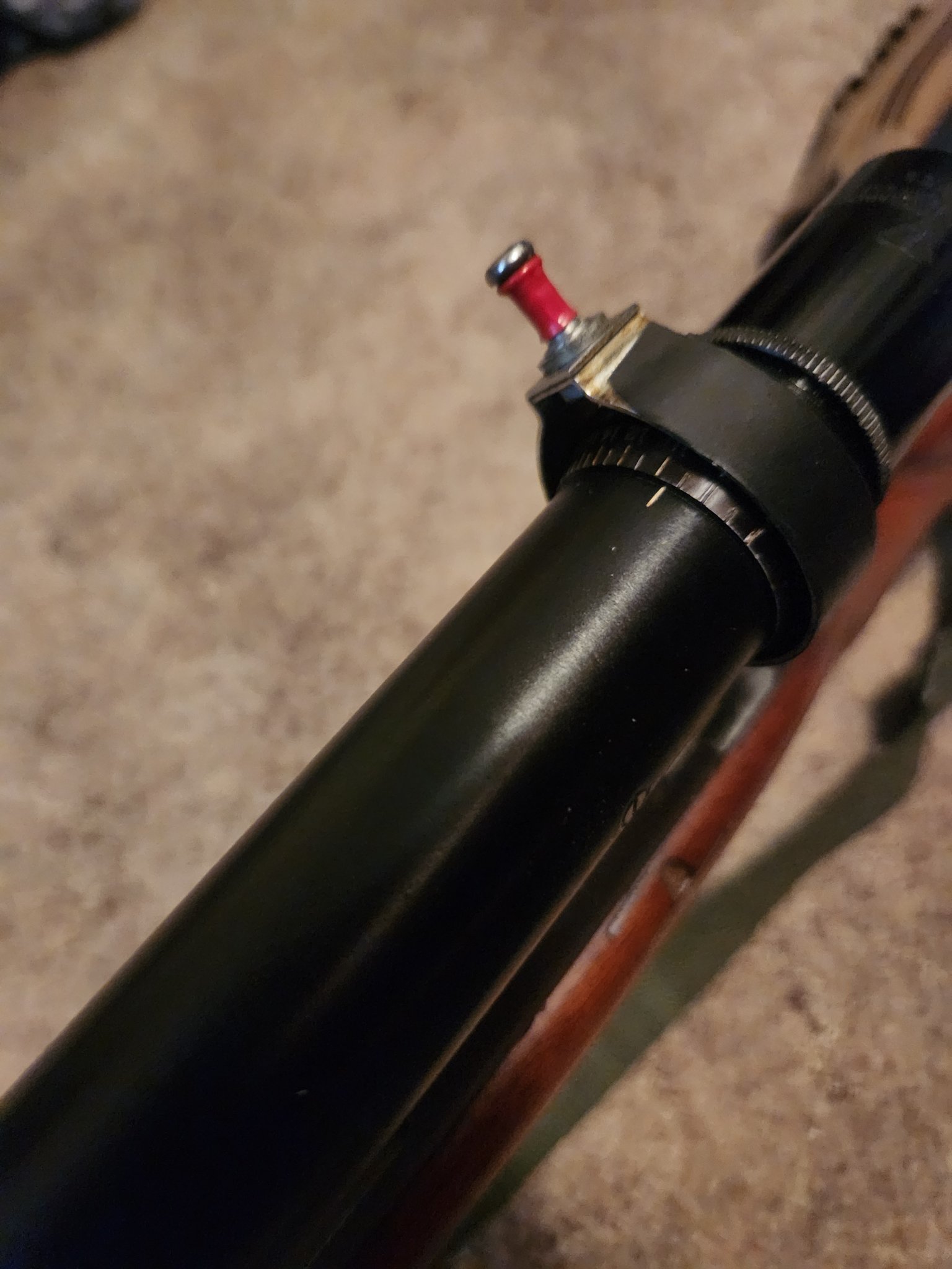

    So as I have now read the instructions. This seperate lock ring here sets the eye relief. You loosen it and slide it forward or rearward till the you have your eye relief where you want it and then lock it back down against the front ring. So that question is answered.
    These two underneath screws loosened, allow you to turn the optic in the front ring to adjust for initial reticle level. Mine must be somewhat loose as I had it turn on my and that freaked me the F out there. The spring has thumbwheel to tighten to set spring tention. It tightens down into a slot in the maintube.
    Here is better pics of the cat tail that I got with it. Its a neat little piece and works great. The bolt handle gets in the way at the very bottom of magnification. Not really a big deal to me.

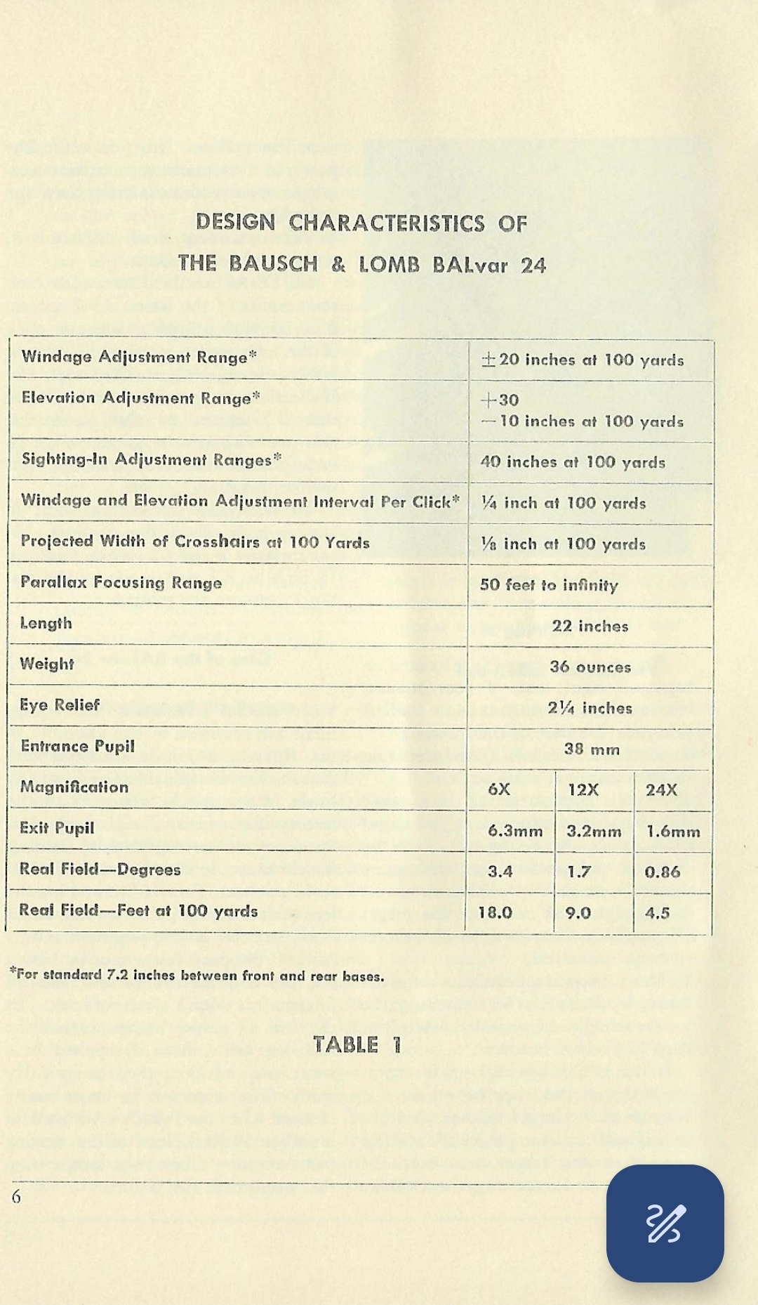

    One other question I got and need a little clarification. The manual here says the total travel iss only 40 inches(?)....
    Sure doesn't seem like much for a target optic. Does that mean we can at least maximize the use of that mere 40 inches of adjustment? Or are we basically stuck with roughly 20 up and 20 down upon sight-in. 20 would get me 175yds-ish. Not the end of world since this will likely be a 50yd benchrest setup more than anything.
    The hexagonal nuts hide screws that allow you to adjust the sights without using the knobs so they remain on zero and zero upon initial sight-in.

    You already seem to know more than 90% of the owners. The round adjustment system for both vertical and horizontal windage/elevation adjustment is rather limited in its travel but does enable very fine adjustments. The grease in them tends to dry over several decades so, if yours does not move well, you can take it apart and clean/grease it for better function. Do not do this unless you have to. Those adjustment screws under the hex caps enable you to do coarse adjustment to match the rifle, load and desired zero and then use the fine adjustment to complete the job, so it is more effective than it sounds at first. The focus/parallax adjustment on the front objective lens is also very fine and if your target moves from 50y to 50 meters you will want to re-adjust it. It is tedious to adjust but once you get it right, it does not move. It therefore for me at least made a better scope for shooting only one distance since I lack the patience to fu#k with it over and over.
    Something that I noticed with my first 52, a Pre-A speedlock rifle is this. I had a modern 6-24x optic mounted that worked very well, but when I mounted the big long BalVar onto the two mounting blocks on the bbl, the net effect is that it dampened the bbl harmonics so much that the already very accurate rifle became a total beast of a tack driver. I was thinking about selling the balvar which I had kept in the box for years without using it but after that happened, I said, no effin way, lol. I have had similar results with other bbl mounted optics. Those old bastids were on to something me thinks! I compete in a local outlaw 22lr BR match on a regular basis. I was always a mid pack competitor at that time. It was open to any factory 22lr repeater rifle but limited to sandbag rests only. No bipods or mechanical rests. We had about 16 regular competitors at that time and shot year round using a outdoor lighted range and indoor benches. Our group included 3 former national champions and several others who could win on a given night. After I mounted the Balvar, I went on a run for several months of winning many if not most of those matches. Today fully half of the competitors are now shooting old Winchester 52's and many are using bbl mounted optics like Unertl, Redfield, Lyman, Fecker, etc. Good luck with your BalVar. Let us know how it shoots once you get it all sorted.
    Well....most long term Hide members tend to know more than most. You spend enough time linked (even indirectly) to actual shooters.....your gonna learn something through osmosis. Versus the he said/she said/my cousin did sewing circle bullshit. The quote is true. "Its not that we are that good. Its just everyone else sucks that much." 😀
    The use the fine adjustment to complete the job, so it is more effective than it sounds at first. The focus/parallax adjustment on the front objective lens is also very fine and if your target moves from 50y to 50 meters you will want to re-adjust it.

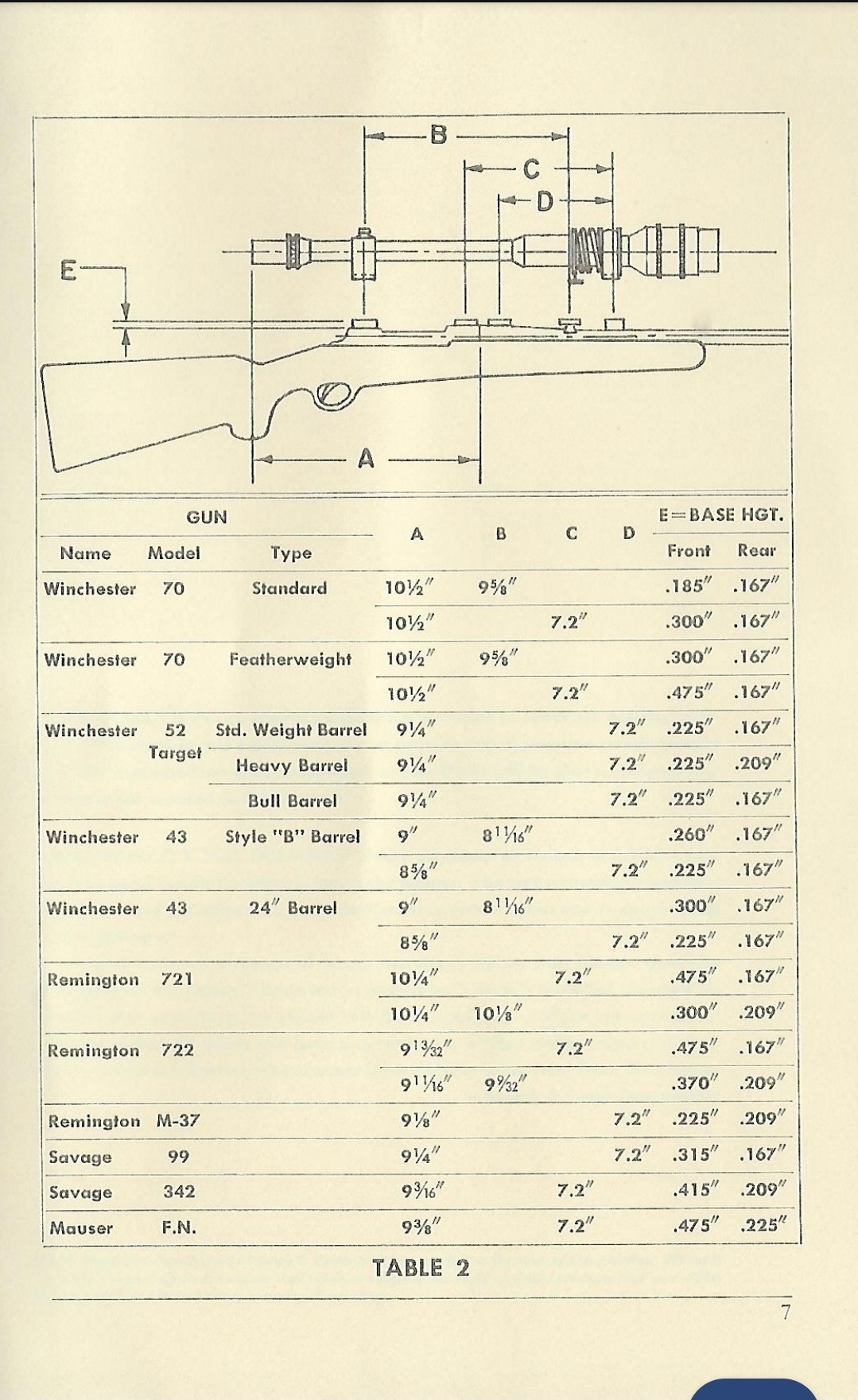

    If you need more elevation you can change front base height. Some bases are stepped so you can quickly change elevation then tune with scope adj.
    I have boxes of bases. Reach out anytime.
    I don't even know if blocks I got are technically correct. Lol
    I may have to take you up on that. Hopefully I won't have to. I dug out the blocks that came with my 52B when I originally bought it 8yrs ago. All I know is the scope slid on and the ring screws tightened down. This is my first externally adjusted optic I've ever owned.

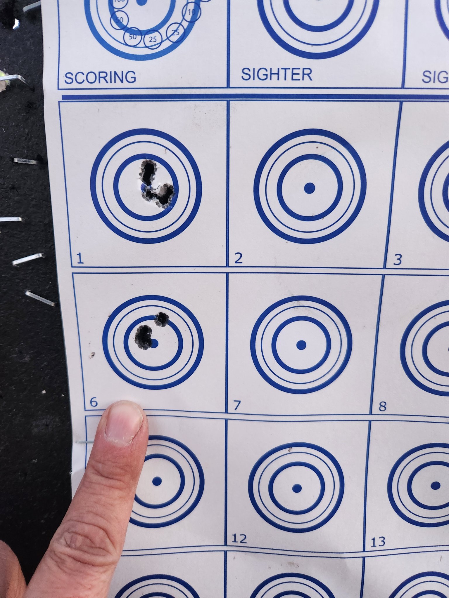

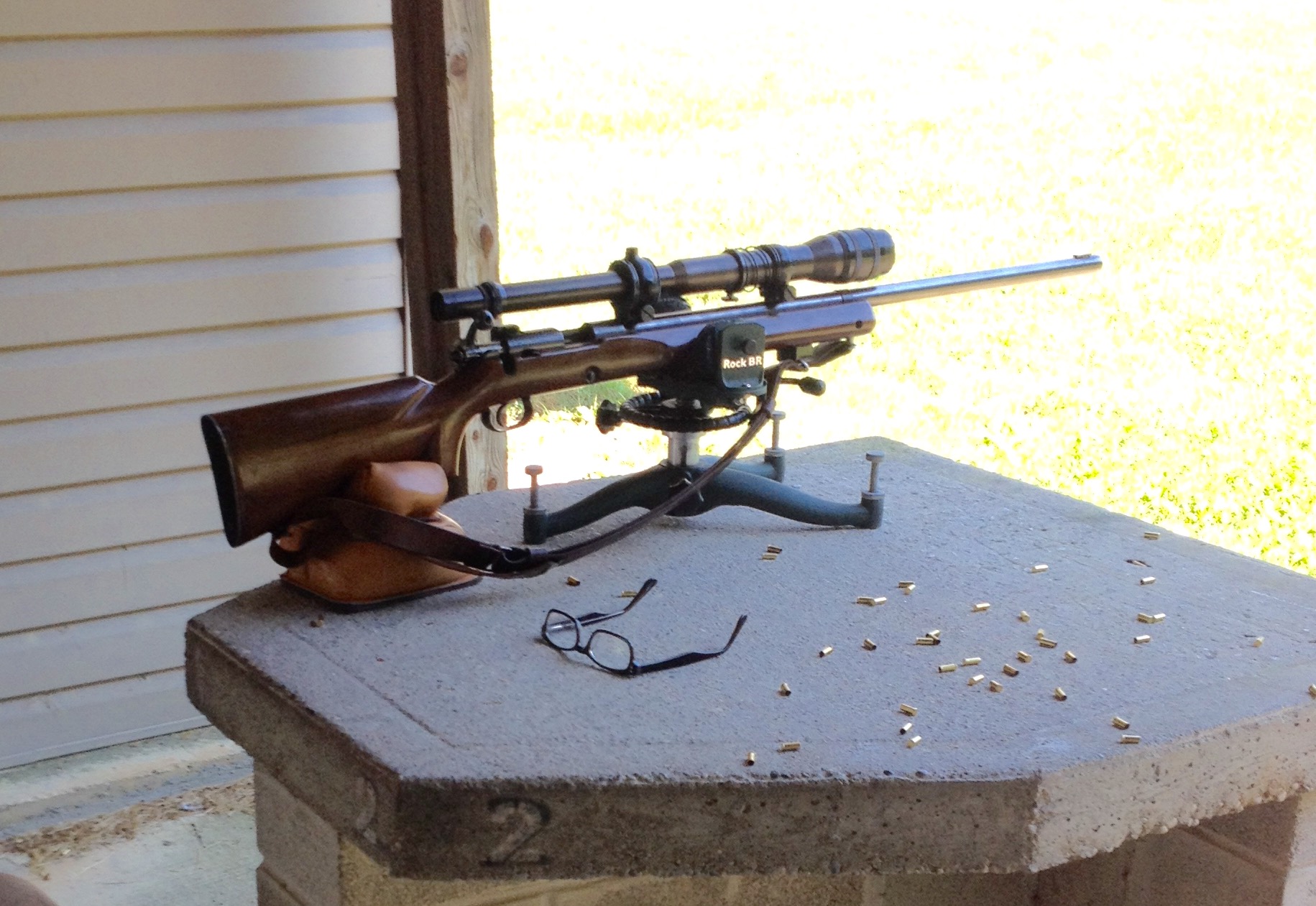

    Finally got out to the range today. We had a 50°F low wind day in January which is about 75 degrees warmer than normal. Left work early to get out and beat the sunset. I literally had nothing set up right so it was a mad rush to reset the eye relief, reticle cant, recoil spring tension, and open the gross adjustment caps so I could attempt to initial zero. Took 35rnds to get it kinda close.
    The ammo was already proven while running a previous modern optic. Just gotta learn the quirks of this thing. This (target 6) was the last quick 5 shot group before my ass went numb on the cold AF steel seat. We are supposed to drop back down to 15°F so it's probably gonna be a while before I come to this. But I'm pretty happy.

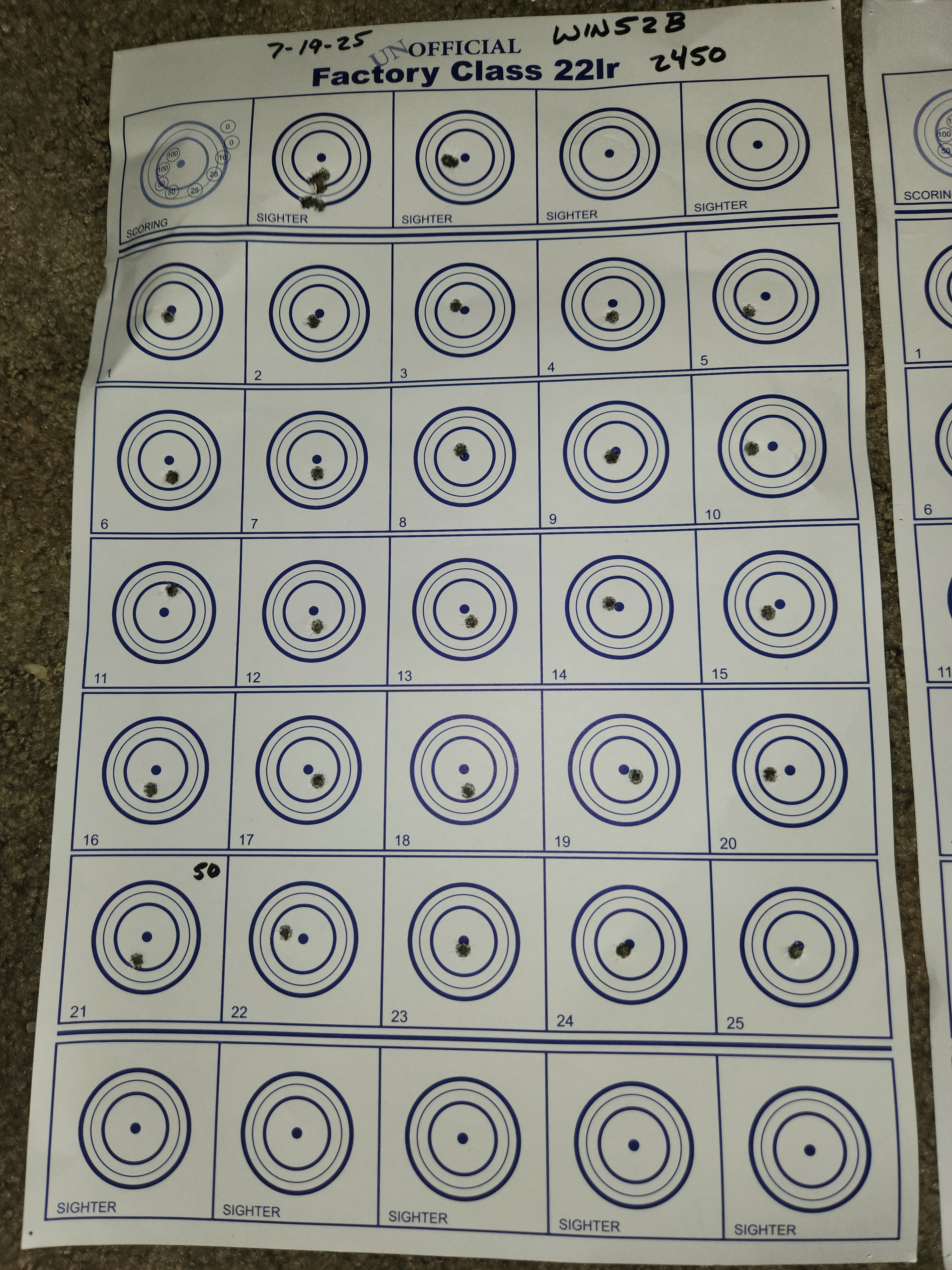

    First real actual benchrest run with the 52B! Shooting it legit for a score. Wind was gusting 6-8mph at half to quarter value. Temp was 77°F. We had multiple tornados pass through the area last night. So glad to get outside today.....especially when its not hot as balls.
    Rifle was pretty badly off zero to the right initially. Not sure why. Was way right even though wind was pushing to the left. Spent 10 rounds on sighters. So you got 5 to right of sighter target #1....then one way left....then 4 on center. Good...she's on now.
    Then Zig zagging towards the bottom. Even shot the sighter row along the bottom (I know they don't count). I was on a roll and didn't want ro stop. Go figure, it was my best row impacts-wise.
    The gun definitely prefers to be kept hot. Was struggling to keep the 5rnd mag loaded. I probably spent about 5min to shoot the whole scoring portion.
    You guys will have to tell me what you score this. I'm not sure what is a X based on the diagram....cutting the dot at all....or stamping it out entirely. Target #1, #18 and #19 were close. I could see someone saying #18 being out. It would be kinda cool if the first run ever was 2500 with 13X's. Albeit an ugly 2500.
    Had a beautiful summer weekend. The plan is to get some 10 round mags so I can stay on the gun longer. Keep breaking position to reload the 5 round mag (plus putting one in the snout) doesn't help....trying to keep on it just that little bit longer. Keeping heat in the gun.
    Shooting on the public range means you wanna get your shots off before some Joe Random comes in needing a cold range. I'm not rushing by any means. But it's probably taking between 5 and 8 minutes to shoot. Had some teenagers checking the rig out today. They thought the 52B was a cannon looking at the barrel. 😆
    The scope keeps needing minor adjustments. Good thing for sighters. You can see on the first target below....the impacts out of the bag are quite low. Ammo being so spendy, I try to check zero in 5 shots. This took a few more. Came back the next day and it did hold zero surprisingly. So far the 52B has been slightly more consistent than my B14R Stainless. Apples and Oranges there....just an observation.
