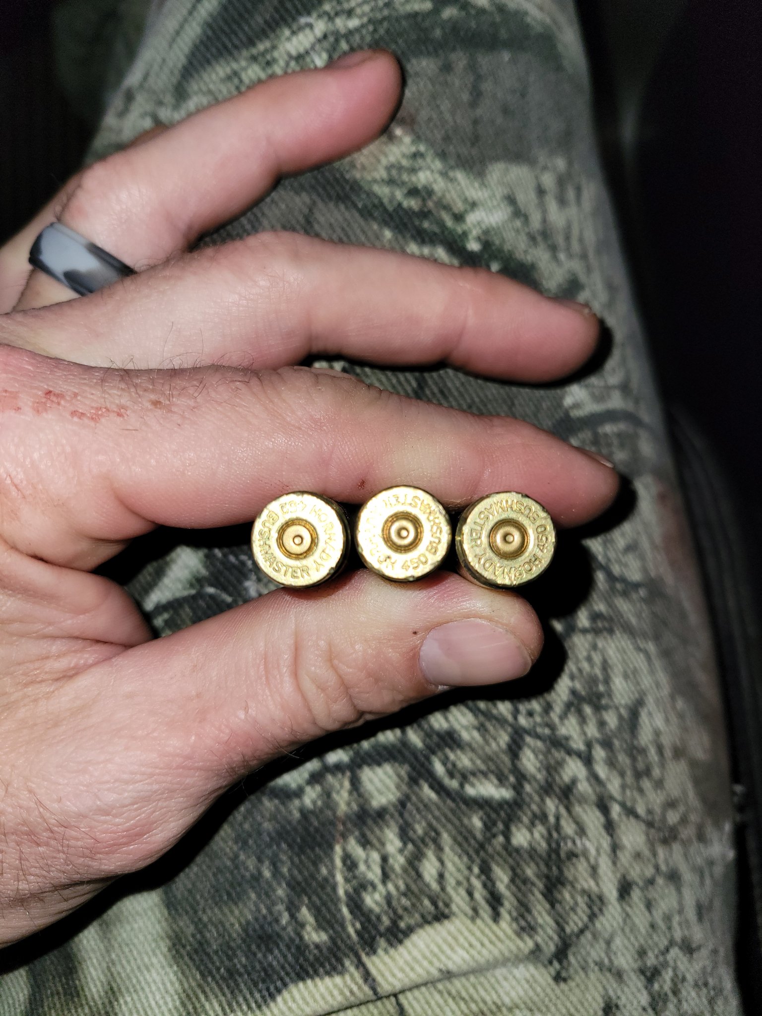

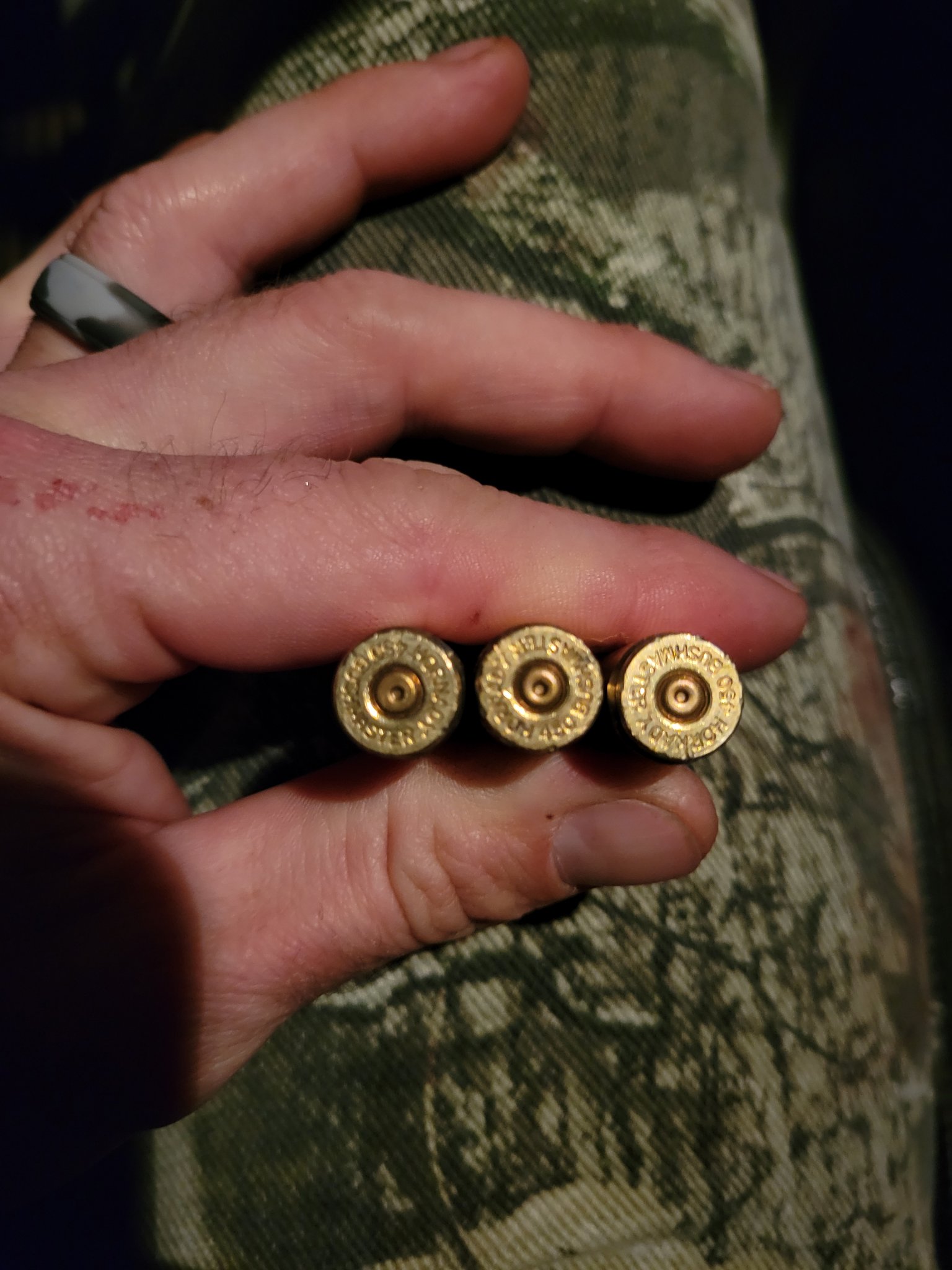

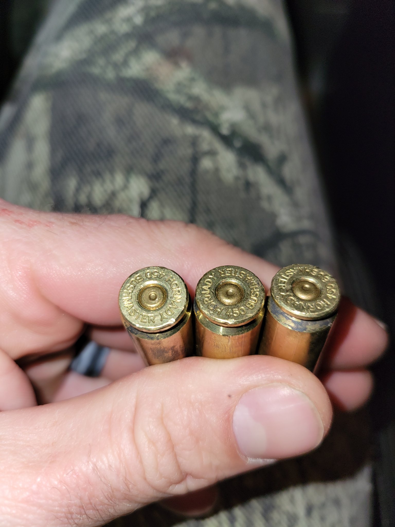

So has anyone had issues with Winchester #41 primers?
I have had some failure to fire in my 300bo subs ( Ar-15) and now today I had 2 out of 3 on my 450 bushmaster. Lucky enough the doe I shot must have been deaf at 30 yards as I cycled out the 2 no firing rounds.
The one at the left is the one that fired, all are primed on a CPS.
