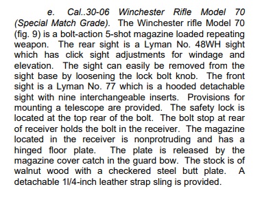

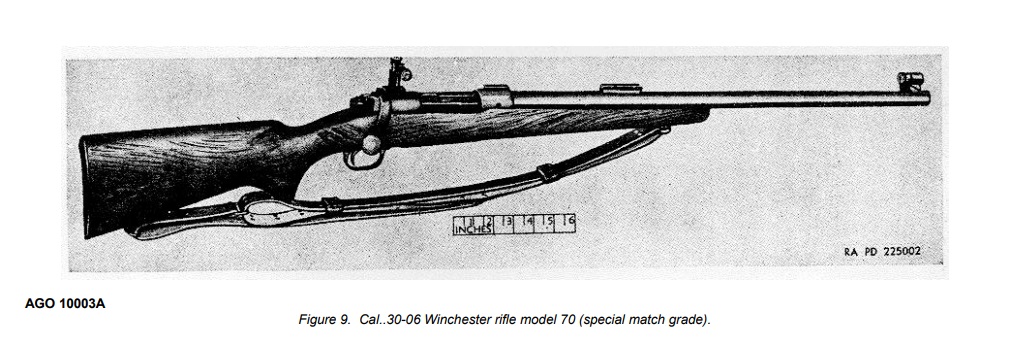

Steffen, the US Army used the Winchester Model 70 as a target competition rifle and never standardized it for general issue to troop units.
Link to 1959 manual: Army Manual for Competition and Training Weapons

Thanks for the Infos. As Sergant hlee wrote: They want regular standard rifles in the competition. So the proof that they rifle was used for training and match purpose is no help.
Would the sniper M70 used in Vietnam have been ordern regular as equipment it would be no problem, but in fact they were build from the existing match rifles and never regular ordered for what they were used.

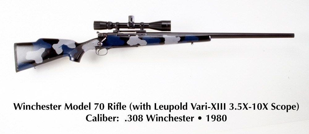

As for the FBI, their elite Hostage Rescue Team (HRT) did build a few M70 sniper rifles around 1980 using pre-64 actions, but that is not going to help re this match in Germany - since it's about iron sights and pre-1966 "service rifles." Fyi: the FBI HRT team is tiny compared to the size of the FBI itself.

The last part of this sentence is key. The FBI did not field the M70 as a "standard weapon", anymore than the USMC fielded Remington M700s as a "standard service rifle" back in the 1960s. (The M40s were bought as dedicated sniper rifles with a 3-9x scope - not as iron sighted service rifle). Likewise, the FBI apparently bought a few M70s in both the pre-64 and post-64 configuration, in a very ad hoc fashion, for the purpose of building them into dedicated sniper rifles. I don't know the size of the HRT (or SWAT) team back in 1980, but I'm guessing it was a fairly small number of specially trained agents:
...and in the early 1980s the FBI then built a very few similar to the USMC M40A1 rifles, but with a different McMillan stock.
Again, these rifles were likely small, ad hoc purchases and never fielded w ir/on sights - but donor rifles that were purpose built into sniper rifles.
