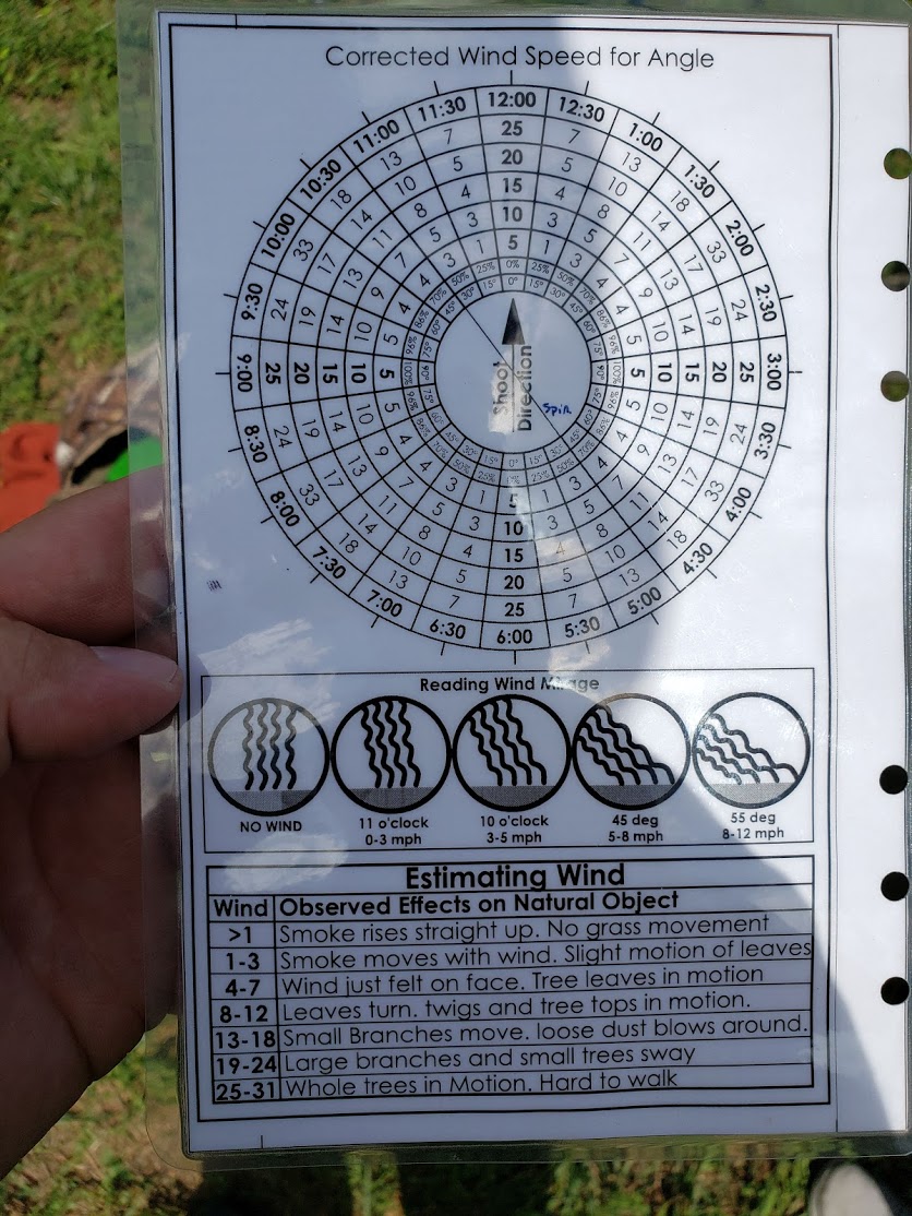

For reference here is how I have this in my data book.
