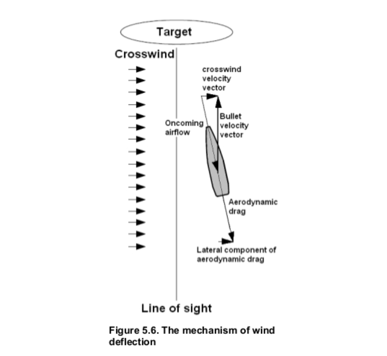

Post 47 above is perfect. Straight out of the book and chapter I recommended. Angle of attack is the relation of the nose of the bullet to the relative wind not direction of travel. Angle of attack in that diagram is yaw. AoA happens in the vertical plane not the horizontal. Furthermore, the relative wind is rarely straight down the axis except for a direct headwind or direct tailwind.
Thanks.
Yes. I'm new to this, but a pilot, so trying to simplify new information into a world I do understand.
no, the stabilization fights to keep the center of pressure behind the center of gravity. What causes the “push” is the decay in velocity and the bullets inability to create velocity once its fired. so that yaw angle gets larger when compared to the direction of flight (or line of sight throgh the scope) which does increase the aerodynamic drag forces on the projectile. Drag is a sideffect not a cause.
Which push are you referring to? The push to turn the bullet inte the wind or the push that deflects the bullet? Please be more specific in you response. You wrote above about the book Applied Ballistics. You know I did read Litz several times, and I know what it says. He says that the bullet turn into the wind so that the air resistance of the projectile is no longer in a straight line between the shooter and the target but at an angle. As the bullet travels down range this causes the bullet to be deflected offcourse. This is what Litz writes and it makes sense to me. As to the exact reason why the bullet turns into the wind he does not specify. I have drawn my owns conclusions as to why it turns and it has to be drag on the wind side.
Regarding your point about the gyroscopic stability you are playing a semantic game. The gyroscopic stabilization makes it harder to turn a spinning axle period. It strives to only move in the direction of the axle.
