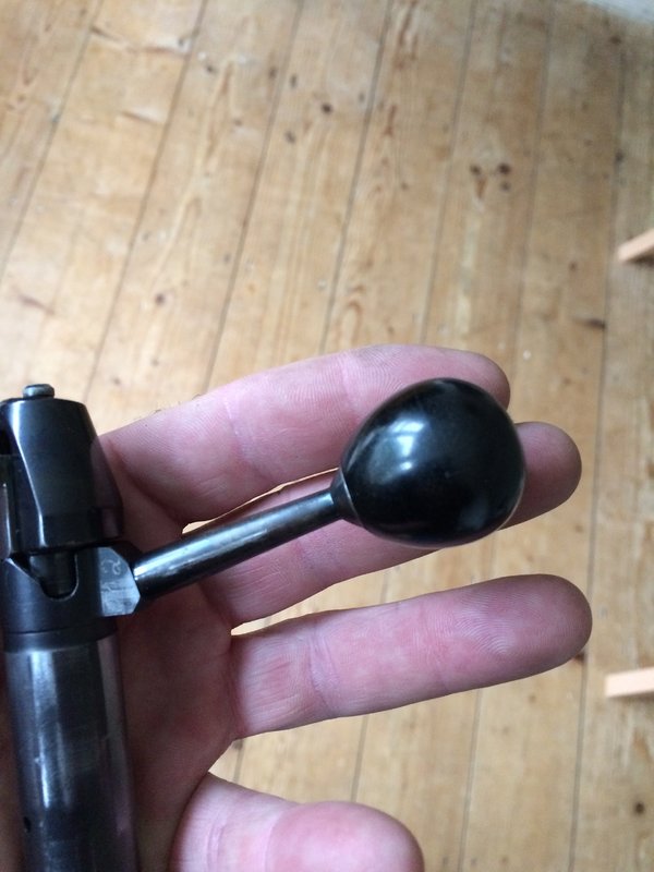

The bolt knob on older models is also different. This is an older bolt knob which looks a lot like a TRG 21 item. I don’t have any idea on the age though.
