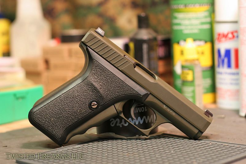

I did this to a roached German Police issue Hk P7...Cerakote over Parkerizing....it's awesome.

Ide take a look at cerakote...with a gloss or semi gloss finish, it should match the look of the original finish pretty closely.
