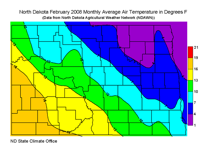

So out in far west ND, right? Near Teddy Roosevelt Nat’l Park?
If so, that tends to be the warmer part of ND. The far eastern bit of ND is so brutal and much worse than the far western part.
A huge part of it is the wind. A large part of the far east is on the bottom of Lake Agassi, which is an ancient dried-up flat lakebed that extended up into Canada. But the east colder too.
Here’s a typical map of ND avg temps in Feb:
Fargo is bad, but Grand Forks and Minot are even worse. Plus there’s nothing to do!
The -70°F record in Montana is on top of a continental pass…nobody lives there. ND inflicts its pain on regular towns of 25k to 150k people. It’s crazy that people live there and don’t move.
But I’ll give you that Cut Bank, MT (pop. ~3000) sounds like it sucks. At least you’re closer to mountains and beautiful scenery.
Not so sure Cut Bank is the coldest town in the lower 48 either. Maybe on average? Can’t find stats.
As I mentioned, there’s a number of towns in ND with -60° or -59° records. Cut Bank’s record is -47°F.

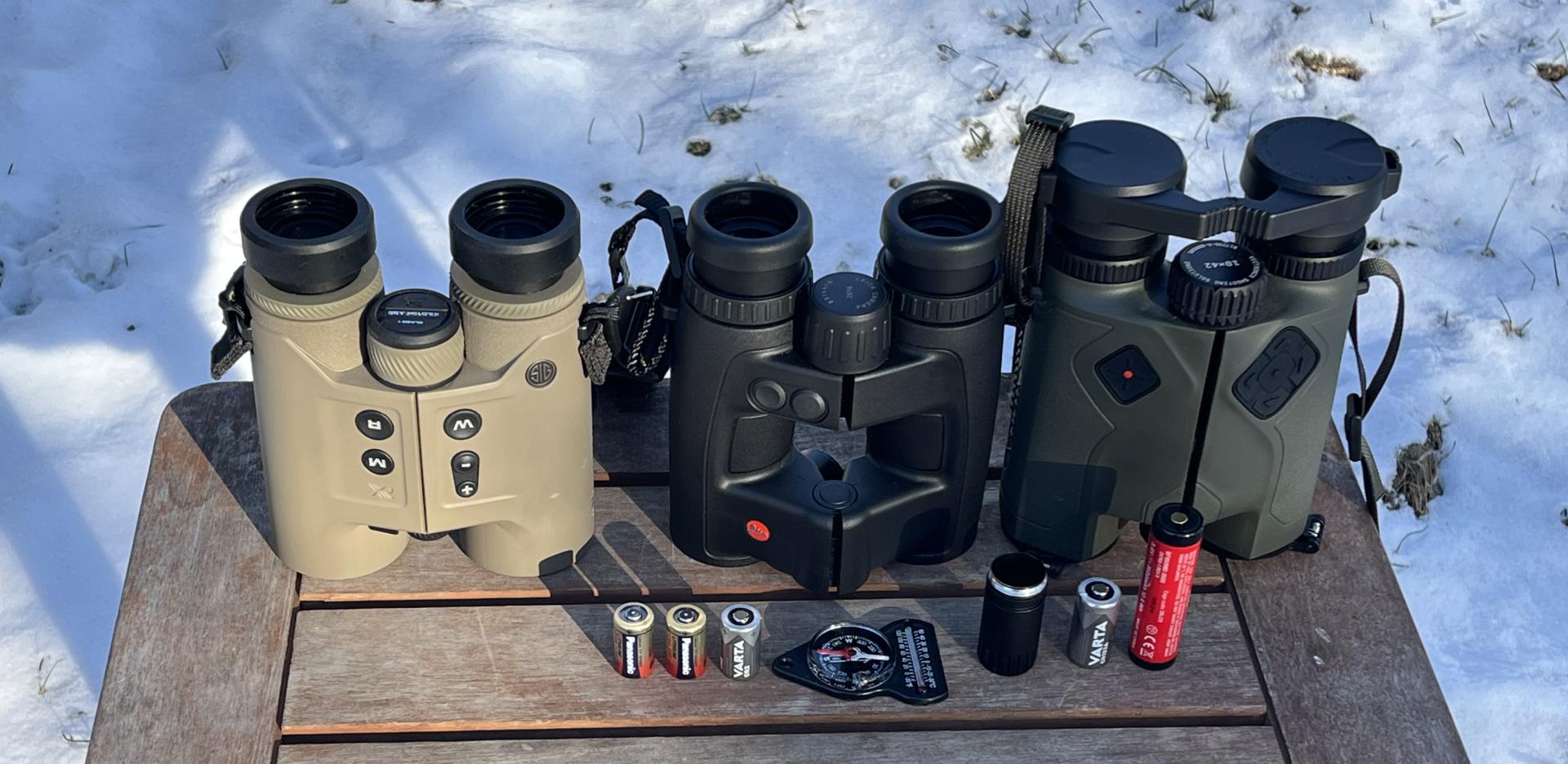

My 12x SMR arrived last week. I'm still testing, but my first impression is that the glass is good, ranging through rolling hills is very good, ergos are sus (both handling and optical), ER is lacking for use with glasses, IPD is fussy and lacks graduation or lock, tripod mount location further undermines handling ergos.
I'm coming from the Geovid (HD-B 3000), but don't use the ballistic function as it's severely limited on this model. Workflow involves Geovids used to glass and range, range is manually entered into Kestrel 5700 4DOF. Geovid glass is great, ergos are great both handling (except button resistance) and optical, but accurate ranging is hampered by reticle and tech. I shoot a lot of woodchucks. They can be difficult to accurately range in rolling hills with the Geovid HD-B 3000 at ranges over 350yrds, the range when bullet drop and wind drift start to be a critical factor.
Regarding the Vector-X I was excited to have a unit that could truly integrate atmospheric data, ballistic computation, highly accurate and reliable LRF and observation. A cursory look at the Vector-X HUD and menus is promising. Switching to AB is still a wild card and reading social media threads on their Quantum rollout has been less than inspiring. I want a solution that works in perpetuity without being connected to the internet or a smart phone. AB seems to be going the other way, but I won't claim to really understand where they're going and they won't say until SHOT.
My biggest concern with the Vector-X's are its optical ergos. I'm finding them to be very optically taxing to use and cause a headache almost immediately. Just now thinking about it, the only other time I've had this happen with binoculars was when they were out of collimation. Maybe that's at play here. I should go check.
Edit: No collimation issues as far as I can tell. I did find that correct IPD is critical and difficult to achieve and maintain. Much of this is likely due to my wearing glasses and the device's 17mm eye relief and 3.5mm exit pupil. I'd really like to try the 10x and even 8x to see if I'm experiencing the same issues.
Does anyone have the 8X SMR? I'm not even sure it landed yet. I think the 10x came first and then the 12x.
Edit: I see Eurooptic has the 8x in stock.

More are coming. They said in another comment that the extenders are not too far behind and will have an update soon.
