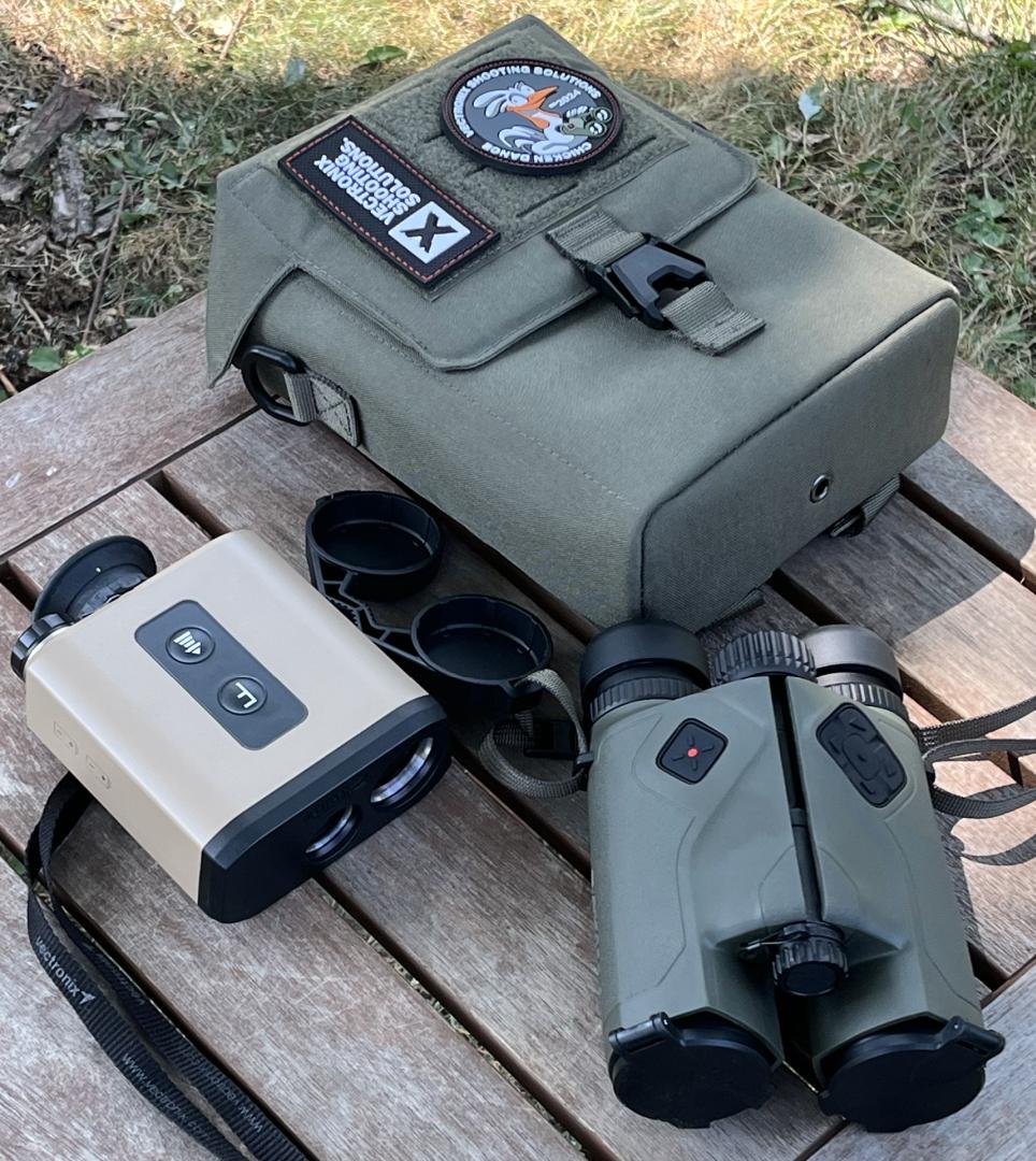

My review of the Vectronix Vector X binoculars is now up.
Original Vectronix Terrapin (left) and New Vector X binoculars (right)
