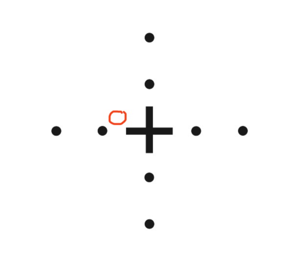

Whoa, a whole mil off?
Roughly .75 mil left and .25 high in the red circle below. But I hate that it’s out in blank space. It made ranging targets at our PRS22 finale last weekend harder than it should be. My buddy also has a pair and his laser seemed very close to center. Another friend had the gen 2 10Ks which were dead nuts center. I might reach out to Vectronix to see what they think but I have a couple important matches soon and can’t afford to send my binos away right now.
Are you saying your laser isn't aligned with the center crosshair? Mine isn't either, in fact mine isn't even very close. It's out between the solid crosshair and the first dot to the left. It's also a bit above the horizontal bar. I'm very disappointed for the price that the laser isn't dead nuts on the crosshair. My 10Ks were very close to middle and you could adjust the reticle if need be. Hell even my Vortex and other cheap ones are usually close enough to be in the big aiming circle most of them use.
Mine is horizontally correct but it’s at the left edge of the crossbar and the first left dot.
I wish they could have a way to align these. In fairness my Sig BDX was also exactly that far off too.
I totally get that. Maybe someone watching this thread can send us ones that are centered like they should be.

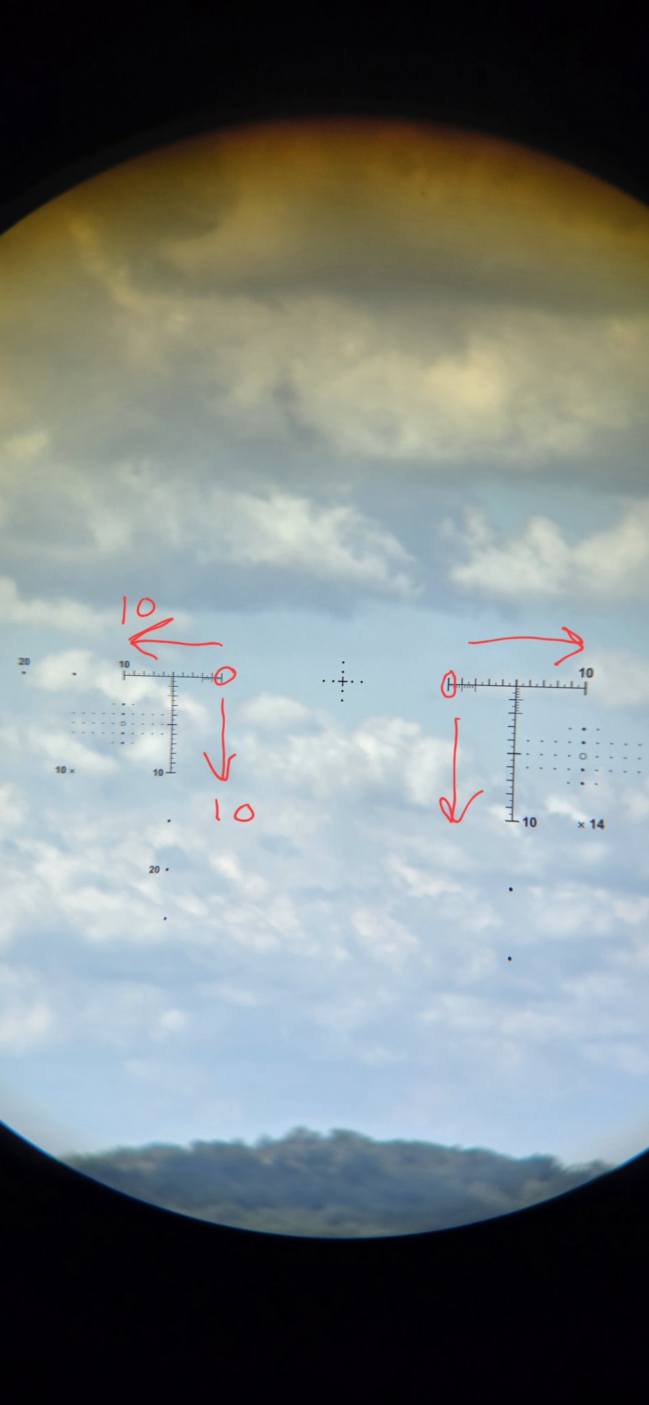

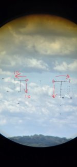

Can anyone help me understand the two 10s located on the horizontal portions of the DMR reticle? It seems as though they are 5 mils off of each of the two T reticles. The vertical 10s below the Ts seem correct by being 10 mils below the T. The only thing I can think of is that they are 10 mils off from the center ranging cross, but the scaling doesn't look to line up. Maybe they do regardless of how it "looks"?
Ok looking at it again, and I think I maybe have it. The 10 mil is not from the center of the T, but from furthest inward part of the T on both reticles. Maybe someone can confirm?

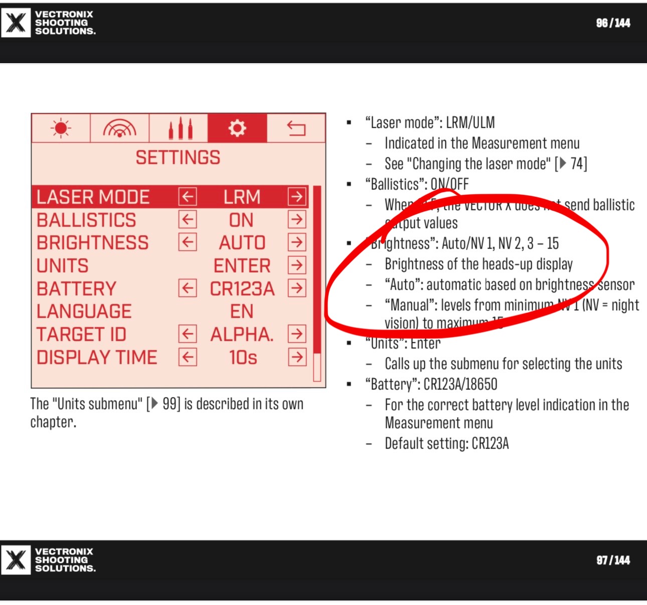

Is there any way to adjust the brightness of the HUD?
You can do it in the menu or you can click up or down on menu pad with the HUD displayed and it should change. I think I saw an Automatic brightness setting too but didn’t play around with it too much.
