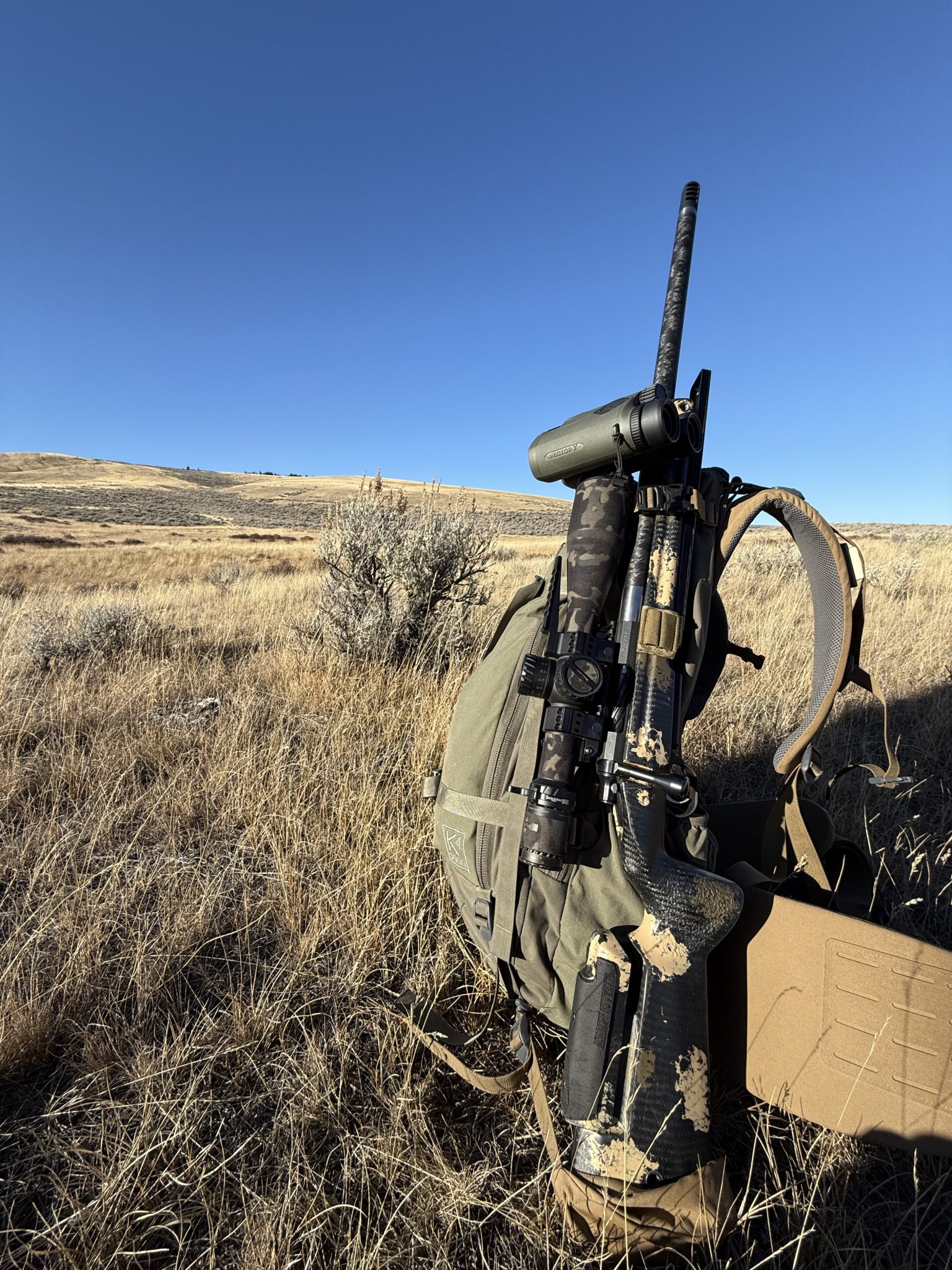

Been out in montana running the vector x’s to try and turn up some mule deer and antelope. Coming from leica geovid pro’s 10x42, i find the vectors better across the board. To my eye they are far superior to the leicas in color, resolution, and the lazer is far more capable. I am very happy i went with them. The focus i find to be very forgiving when panning across hillsides, only issue so far is the plate fell off the focus wheel.
I think the 10x is a winner for hunters with its wider fov. It's the one I'm almost 99% sure I'm buying.
