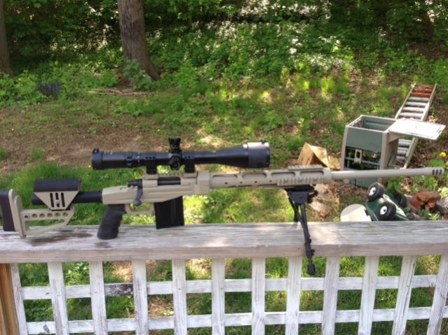

It's still a work in progress,
work done by Phoenix Custom Rifles (Products)
trigger is a jewel set for about 5oz (scary light)
the stock is a XLR, action is rem 700 SA caliber is 7mm-08,
10rnd aics mags, 20moa rail, Burris rings, muzzle break .. dark metal designs.
I had a had a bolt release added barrel was it was cut to 20" and threaded.
scope is a Burris 3X10 hunting scope for now till I can get something
descent :)
without further ado :)
since I'm still packed up I can't do any loading for it yet, needs camo finish
and fluted bolt, and a bunch of other stuff.
hope you like it cause I love it ...

Looks great!
